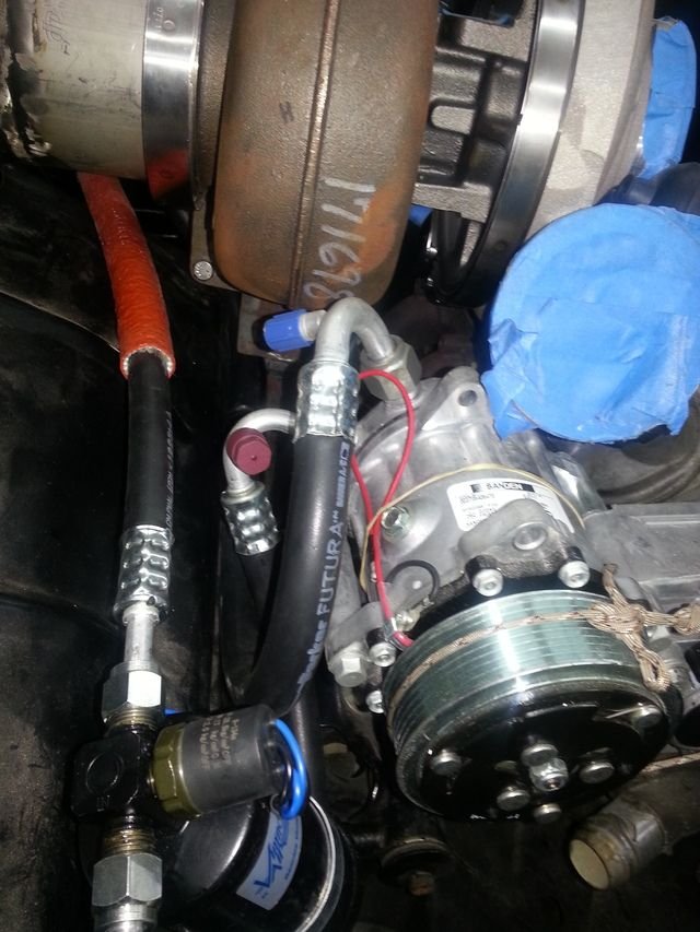

I'm using the 508 in my '55 with Holley brackets and Vintage air. With the 508 you can clock the outlets. Basically 10, 2, 4 or 7 o'clock.
Not the best picture but it should give you the idea, there are are mounting holes on the compressor at 12, 3, 6 and 9 o'clock.
