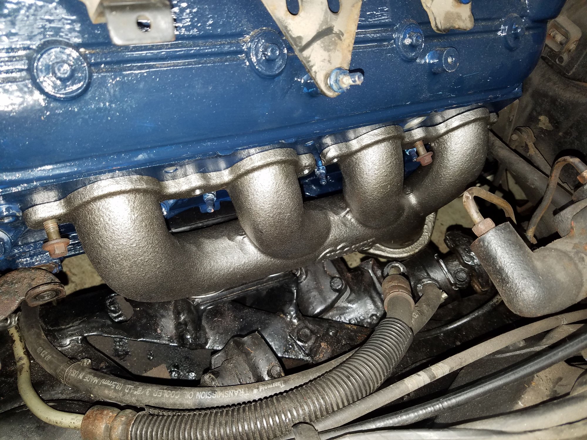

I am trying to find something that will fit on a 6.0l in a 1963 Cadillac.
I pulled the motor out of a chevy express and used the motor mounts from it to mount it in the Cadillac. I seems that my motor mounts flair out towards the frame a bit where it seems many ls motor mounts are smaller and more cantilevered from the bottom...
I am not concerned about performance at this point, only finding something that fits. The van exhaust manifolds dont fit, the flair out to much at the back. I bought truck hugger manifolds and the they hit my mounts.
I just got a set of cast hooker manifolds, and they almost fit, they barely are hitting my mounts, I am sure I could grind them a bit but I would like more clearance than that.
My question is, are there manifolds/headers where the manifold part is up higher? Not sure if there is stock option out there? Sorry for the giant photo

Maybe Caddy LSA manifolds?
Hard to beat those Hooker manifolds for compactness.

Thanks for the suggestion Andrew and taking the time to provide a photo, I will see if I can find out more on them

I found LS3 corvette C6 manifolds cheap and narrow in width. My old truck has a very narrow frame. I forget but think either 24" or 27" wide. The L92 truck manifolds were WAY too wide.

Look into the trailblazer ss manifolds they are the narrowest option I believe.
