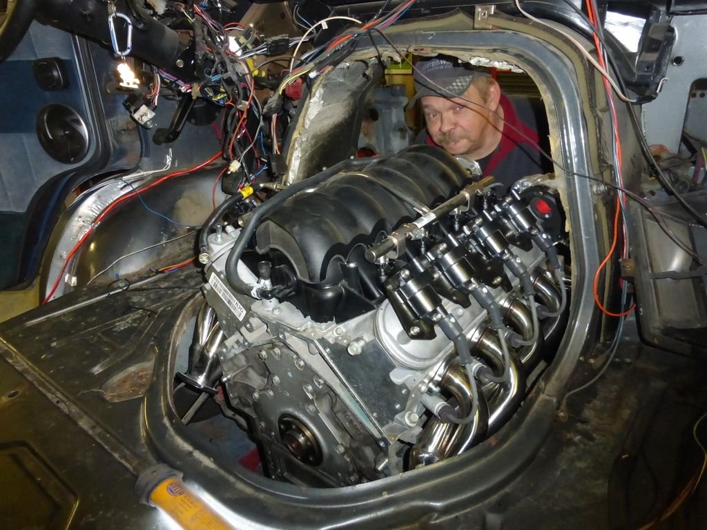

last week i start my swap, and i think this winter will be funny
the car
1988 G20 5.7 TBi with TH700
made in Scarborough Van Plant Canada
the new engine
transmission 6L90 fom a CTS-V
and a lot of more funny stuff
the good TBI is history
i will save the big oil pan from the camaro and the axle frame will be boxed
first test and all fits
tomorrow i take the enginge out again and weld the boxing area

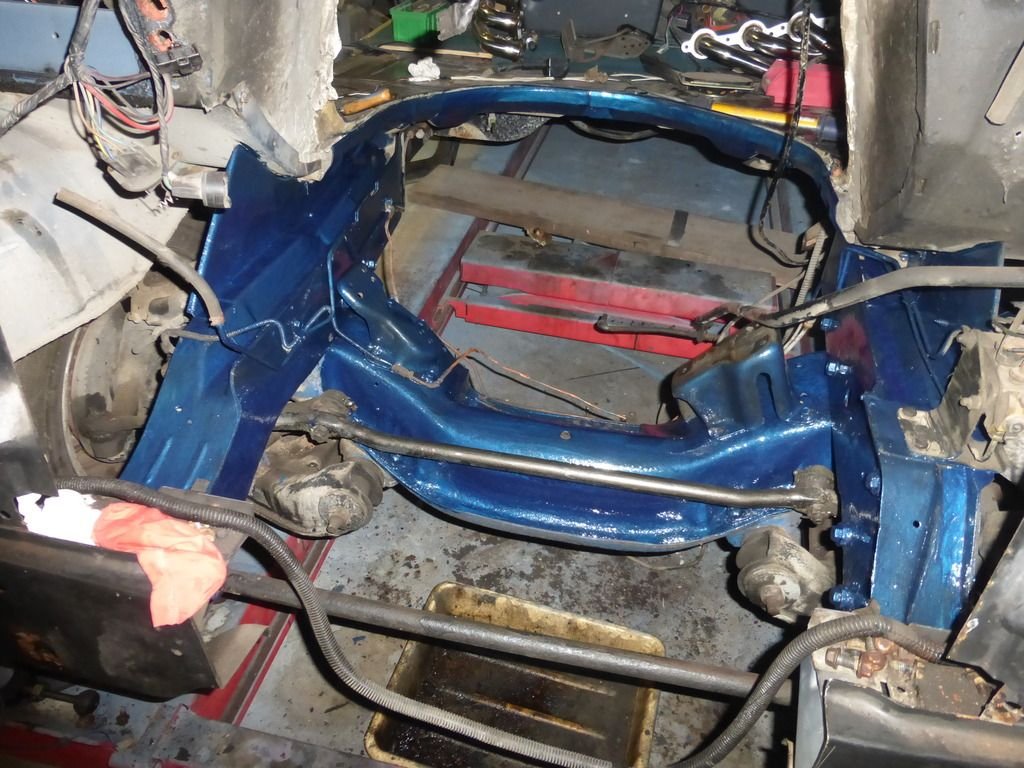

after i was ready with boxing the engine frame
the engine is back in place
the big Camaro oil pan have now space enough

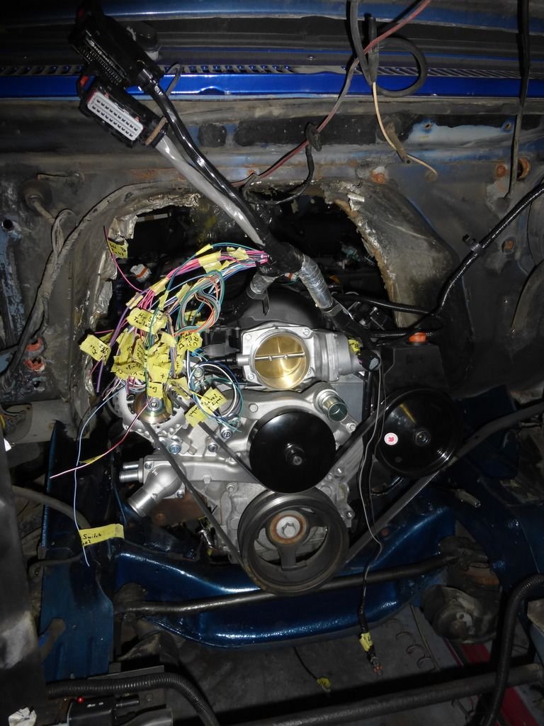

the original GM harness is ready and done with all pin outs
next week i will wire up that stuff
