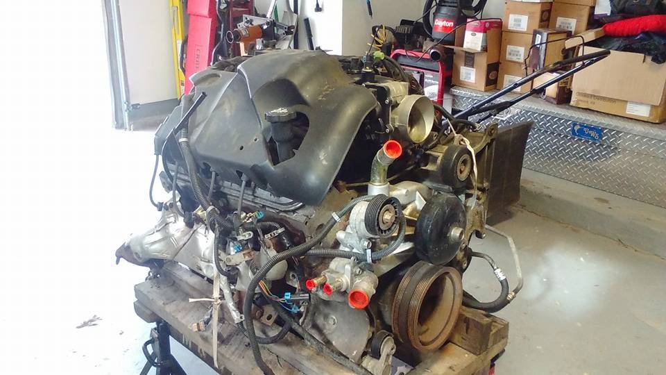

second step - using three floor jacks and a brick, finangle engine into middle of garage...
no engine lift to use my stand so... pallet and jackstands

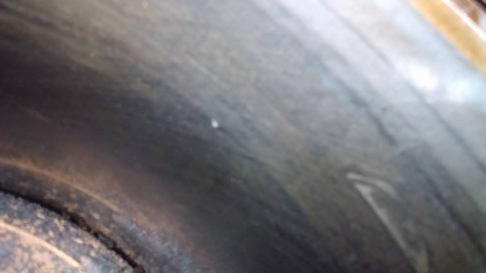

The only bad news is I dropped a lifter into number three when I was removing them. Now there's a nice little ding on that cylinder's wall. So I think I'll have to bring the block in now too which will make my new friend really happy. Or maybe one of yall can give me an idea of how you'd fix it: Spinny autozone **** bead thing? Redneck honing tool? The picture doesn't do it justice... my world almost ended. It feels expensive.
it feels bigger than it looks, I swear
