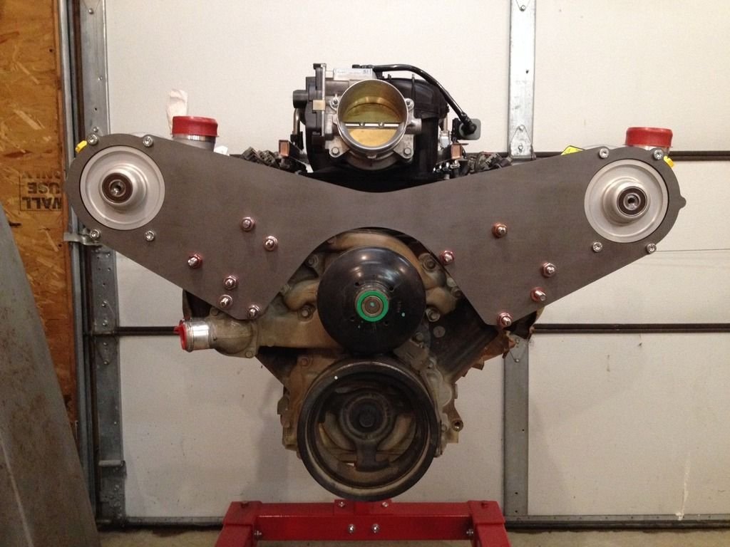

Thanks for the reply. I spent a lot of time over the weekend researching all of this. I discovered exactly what you said, except L96's have VVT. After reading many articles about VVT I decided to delete it. That will allow me to go with a CTS-V water pump which will support a 10 rib belt. Probably the same as a Corvette water pump. Doing this will save me 2 1/4" up front which is a huge help. Here's why I need more room up front.
I'll be running twin Rotrex C38-92 superchargers with intercoolers.

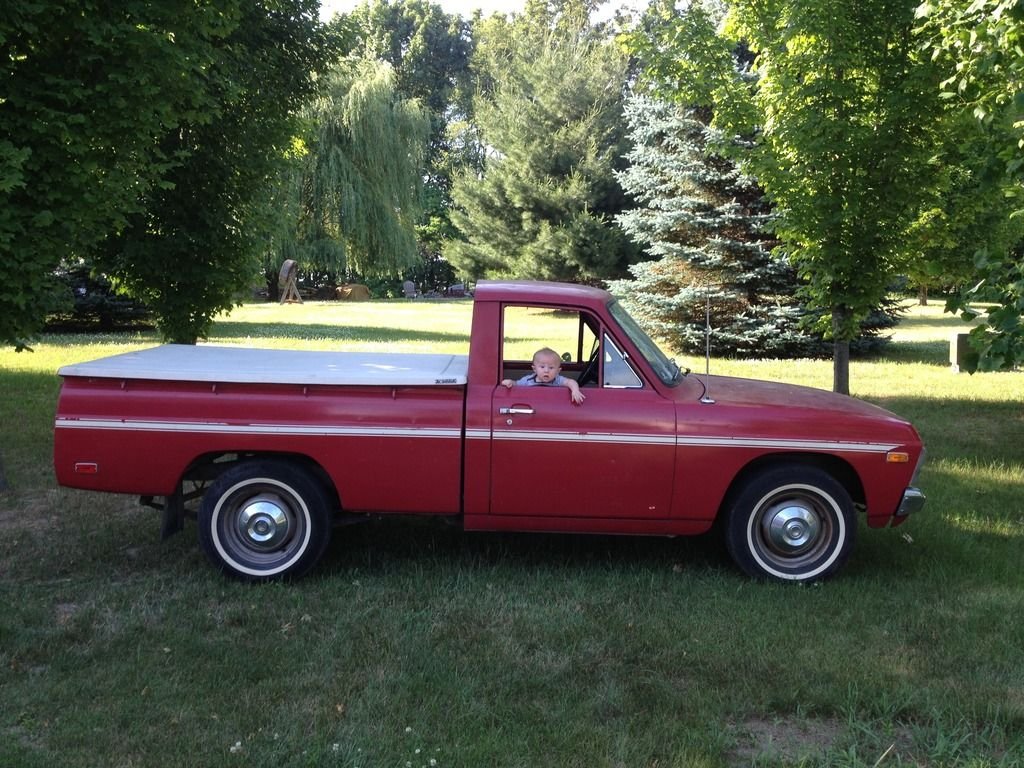

I bought this truck from the original owner who had it stored in his San Francisco California garage for more than 30 years. Hard tonneau cover on it since new from the dealer. Absolutely mint condition inside the bed. I'm lowering the truck about 3", but I think I'm staying with steelies and whitewalls.
1st Gen Couriers are 1.5" wider than a Smart Car. I have 29" from the firewall to the core support. With the CTS-V water pump, my setup will only be about 27". Intercoolers will be mounted between the core support and grille. The radiator will need to go in the bed.
