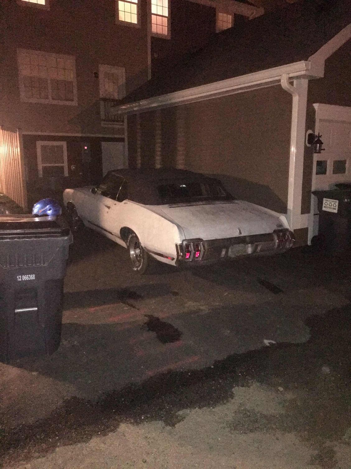

As the title states I am new to the LS world. I currently have a 1970 cutlass that I want to do an LSX swap with.

I want to push out around 600 hp to the wheels. I am headed to the junkyard this weekend to look at engine blocks. I am looking to get a 6.0 and get the work done. I was quoted $8500 to achieve the hp that I wanted. Does that sound about right?
