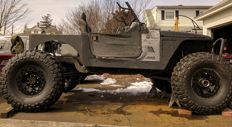

Ok, Assume i know pretty much nothing about LS engines. Im a Jeep guy. Ive done just about everything else to my Jeep. Now starting to think engine swap to replace a tired old 4.0. The fabrication aspect isn't an issue. Looking for the best option to fit my needs. Current set up:
1 ton 14 bolt axles front and rear, 5:38 gears with full spools.
Advanced Adapters 4 speed Atlas transfer case double low 10.3:1 ratio
39" BFG crawler tires competition red label compound (drag slicks with tread)
I want to run an auto trans, it offers more control when offloading.
Any recommendation on engine/trans combos and best options for getting them? what cars come with them?
Heres is what its going in. Still under construction obviously. Thanks

Since you aren't likely to be doing a lot of interstate long miling with that Jeep,I would go with a slightly warmed up DBC 6.0 mated to a TH400,if you really need O/D,make it a 4L80E.If you haven't yet,read the almost 300 pages of 5.3 swaps over on pirate4x4,lots of good info sandwiched in the usual forum repetition and BS.
