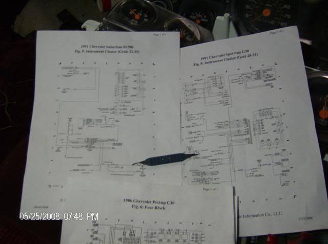

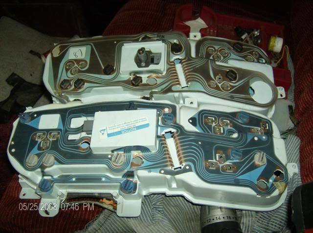

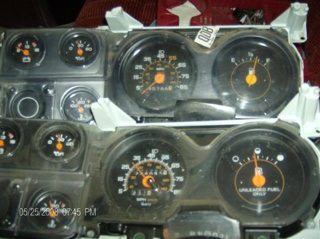

Download and copy the wiring diagrams for both dashes, re-pin the backs, and your ready to go...
This is what your donor "electronic speedo" cluster will look like compared to the old one.
As and added bonus, you'll get the "overdrive" gear indicator also...
