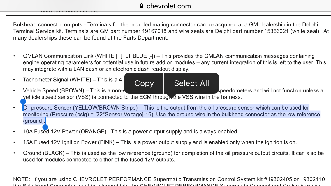

Did a gen v lt4 swap and am working some of the bugs out. When hooked up to a obll the scan tool displays nice oil pressure. I'm trying to go from my harness to my autometer gauge and am not getting anything on the gauge. I'll provide the installation Manuel of what they tell me to do but it's not working. Any ideas? Thanks
