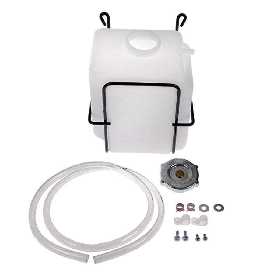

I bought a similar one myself. I'm questioning the diameter of the tube to mount the hose. It is so small compared to the radiator. Does it have to be at a certain height so the recovery system works? I feel like it's going to hang lower than the radiator. I considered using Dorman part number 54003 but I'm not sure if there's a tube going to the bottom of this one. I wish I could find something like this with the matching hose size as radiator in the overflow tank with a bottom siphon.
Dorman 54003

I've seen a meth bottle (SNOW ?) like the doorman that looks promising.
