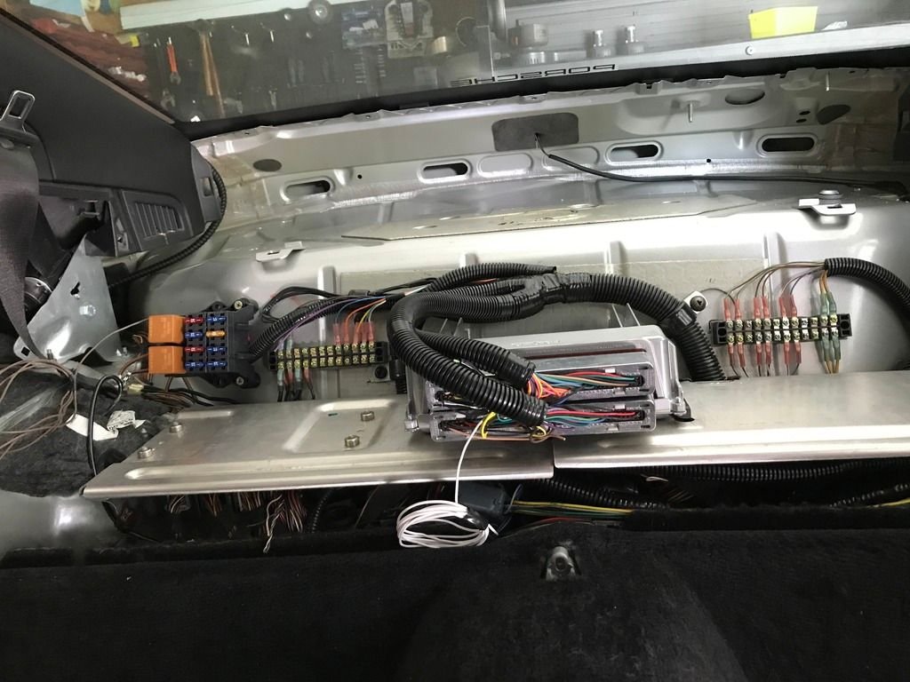

Go with PSI and save yourself headaches. I started with a PSI harness removed the loom and integrated all the 997 wires for a clean and simple install. Took some time but well worth the effort. When finished I will print label ID on the terminal blocks.
