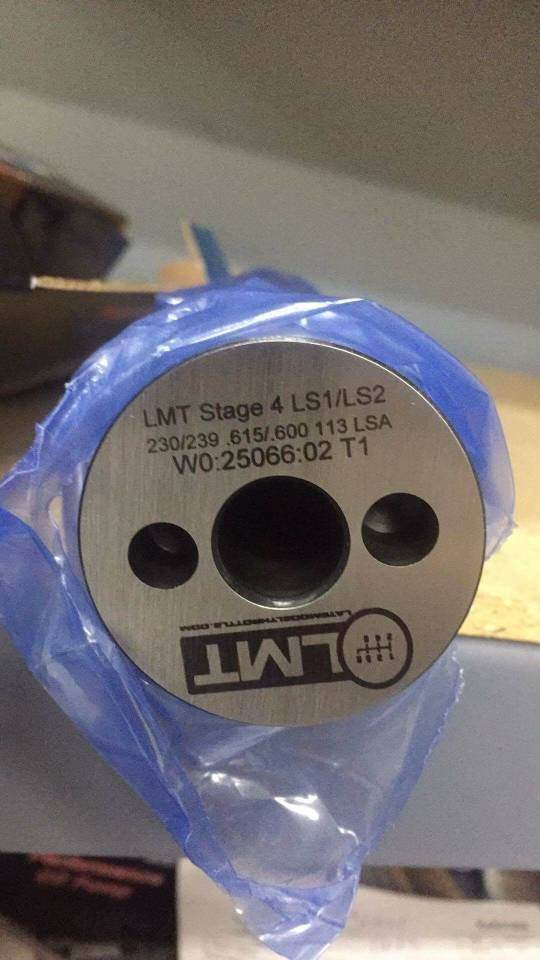

Throwing a fully built, stock cube (3.908") LS1 into my 1989 BMW 325is. Mamo's Mamofied 220 heads, big cam, ported MSD Atomic Intake, etc, etc, etc.

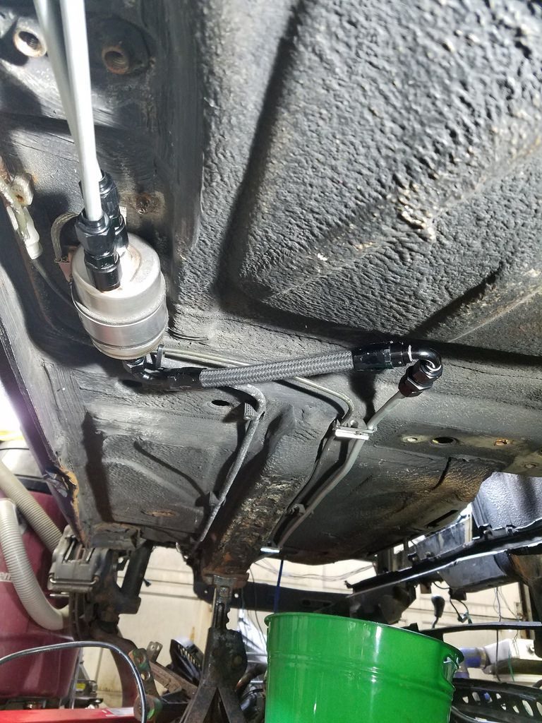

Buttoned up the fuel system!
Old Jan 19, 2018 | 08:11 PM
DrLeadFoot's Avatar
Joined: Feb 2017
Posts: 3
From: Milwaukee, WI
Fuel system layout breakdown:
Fuel Feed: Tank -> 4-6" of 3/8" rubber hose -> barbed fitting -> -6AN Male -> -6AN Female -> 2' of 5/16 Steel fuel line -> -6AN Female -> -6AN Male attached to input of Fuel filter/pressure regulator -> -6AN Male attached to output Fuel filter/pressure regulator -> 4' of 5/16 Steel fuel line -> -6AN Female -> -6AN Male -> braided fuel line -> -6AN fuel rail adaptor -> LS3 Fuel Rail (Needed to use to fit MSD Atomic AirForce Intake) -> DEKA 60lbs injectors
Fuel Return: Tank -> 4-6" of 3/8" rubber hose -> barbed fitting -> -6AN Male -> -6AN Female -> 2' of 5/16 Steel fuel line -> -6AN Female -> -6AN Male attached to return of Fuel filter/pressure regulator
