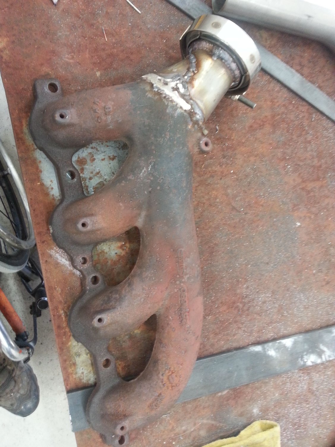

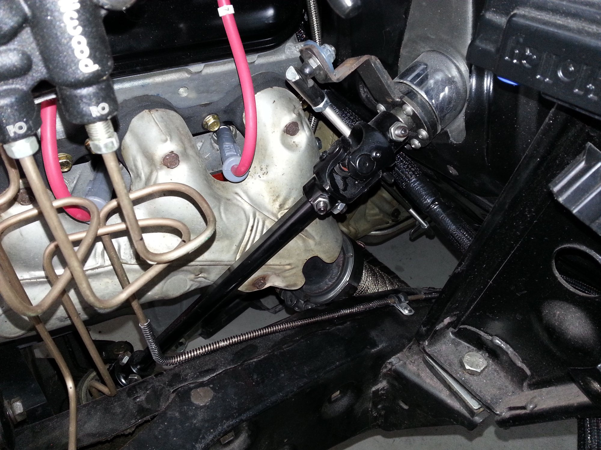

4L80E fit in my '55 with room to spare but the truck manifolds are going to be too wide at the back outlet to fit inside the frame. I modified a truck manifold on the driver side with a V band and got it to fit but it's not going to fit otherwise.
