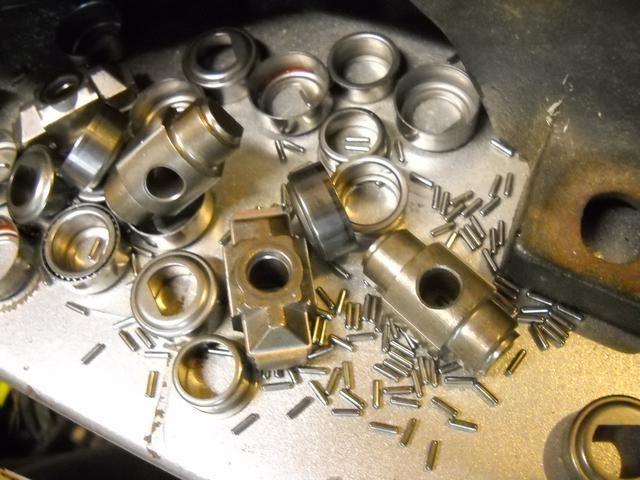

Anyone have any experience with this rocker arm trunnion upgrade kit? I like the fact that it uses bushings instead of needle bearings, I'm just wondering how it will compare in terms of durability...
Old May 30, 2018 | 10:10 AM
  #45
Posts: 22,298
Likes: 3,619
Looks like a rebrand/copy of CHE's kit, which is a very good kit. It LOOKS like the bushing "floats" rather than being pressed into the rocker, which I like. Not positive on that though. CHE's is like that. Straub's is pressed into the rocker. Either one is very good, just two different techniques.
The bushing type of kit is proving far superior to the needle bearing ones, due to bad metallurgy causing the needles to dig into the trunnion, which is usually too soft to handle that type of wear.

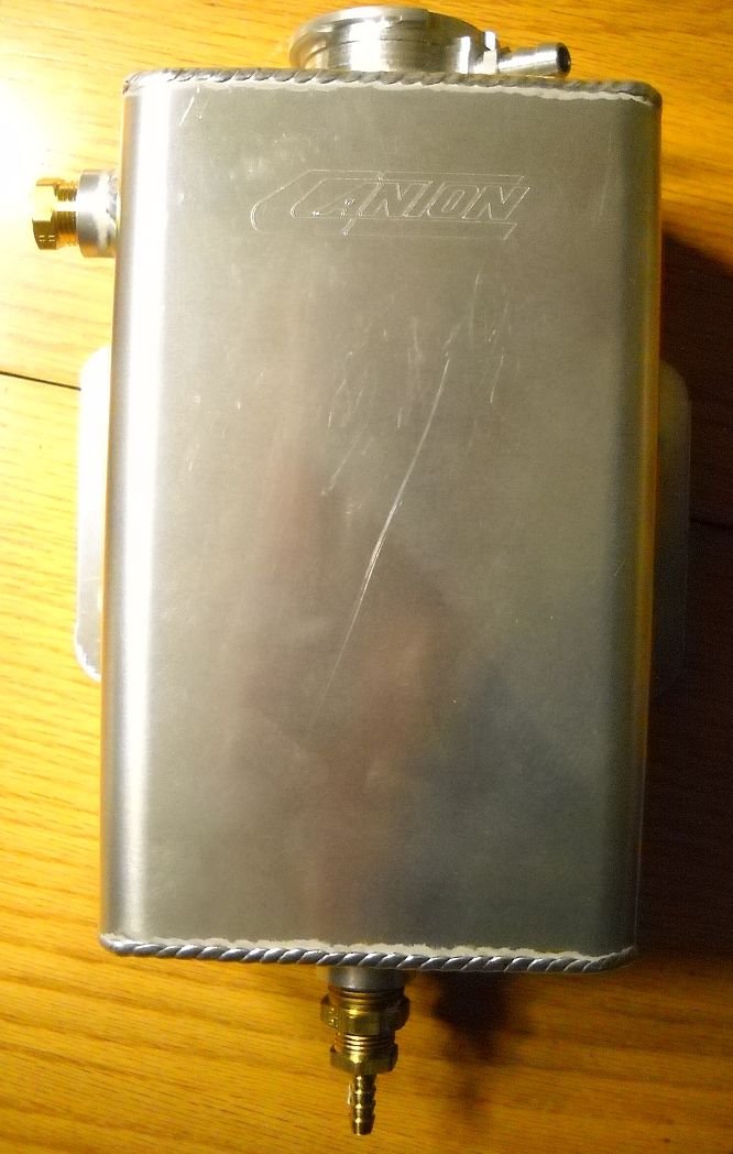

Well, small progress is still progress, right?? I'd bought this expansion tank 2 or 3 weeks ago, but it didn't come with anything that mentioned what types of threads the different ports used.
After my workout, I went to a local hardware/sporting goods/outdoor store where the employees always seem to be helpful, & sure as heck, I was routed to a guy who knew right where to find what I was looking for. Eight bucks later, & I'm now ready to mount this sucker up & connect the hoses... Bit by bit - even if they're little bits! - it's getting closer to running under it's own power again...

Had a friend of mine come over yesterday & lend me a hand with my own car, so between the two of us, we were able to perform an upgrade that I've been wanting to do. Unfortunately, it seems we made a bit of a mess...
OK seriously, this is something that I've been wanting to do for a while now. Reading about other peoples' rocker arms failing always made me kind of nervous because that was one thing that I knew I hadn't touched. Now, with the bushings there instead of the needle bearings, I can rest a little more easily. (Sorry, I didn't get any pics of the parts or the process, I was focused on getting as much done as quickly as I reasonably could...)

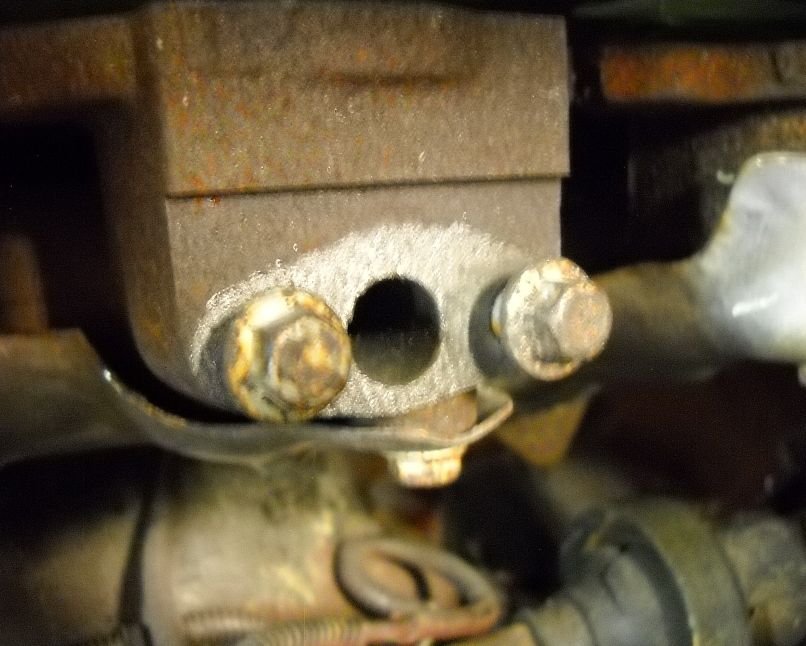

On the off chance that anyone was wondering, I'm still around, still "plugging away" at it, when work, & family, & all the other stuff isn't monopolizing my time... Quick question - I'm forced to use exhaust manifolds since the headers won't fit around my bellhousing, but anyone have any suggestions on the best way to close off/seal off this port?? Thanks in advance.
Old Jul 26, 2018 | 01:21 AM
  #54
Posts: 22,298
Likes: 3,619
Tap it and run a pipe plug into it.
Old Jul 26, 2018 | 01:28 AM
  #55
ls1nova71's Avatar
Joined: Jan 2008
Posts: 4,406
Likes: 211
From: Liberty, MO
I usually just make a plate to bolt over it with the 2 bolts. The manifold gasket kit's generally have the gaskets for them included.
Old Jul 26, 2018 | 01:35 AM
  #56
Posts: 22,298
Likes: 3,619
Even better! Use the gasket as a pattern for the plate. Neat and clean.....
