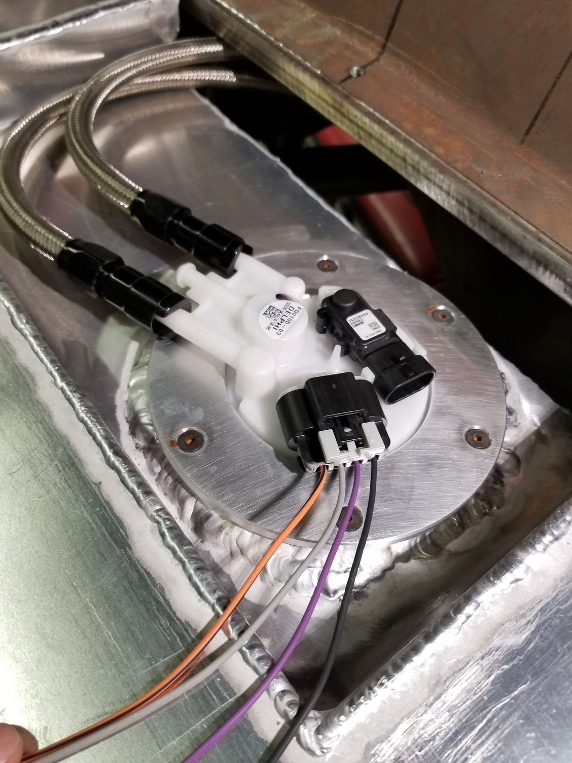

Need some help I'm doing a LS swap on my 1950 Chevy car and using a 2001 Yukon fuel pump assy. I want to use fuel level sender with an aftermarket gauge can this be done? there are four wires Gray-pump power, Black-ground, Purple-sender primary, Orange/with black-low signal? the original cluster is getting sent out to be retrofitted with electric gauges. which one of the sender wires do I use?

Some sending units have two wires, some single. Take an ohm reading from the purple wire and orange/black. Purple should be your signal and orange/black is just a ground. You can verify by using a different ground when testing the ohm range. Should read 40 empty, 240 full. If your fuel gauge is set up to that ohm range, your gauge will work.
