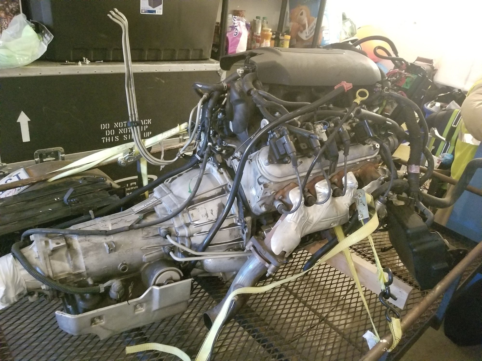

Hey Whats Going On, Happy Easter To Everyone. I'm New To The Forum And The LS World. I Just Purchased A 5.3 & A 4l60E Transmission From A Friend & I Had A Question About What Is Needed To Do A Conversion From A 5.3 To LS1.Or LS3 & Also Is There A Way To Do This Conversion On A Budget And Still Gain Horsepower. Can Someone Please Help This Novice In Making My 72 Malibu Build Something With A Little Kick.

First Thanks For The Response, Now The Engine Is A 5.3 Vortec Out Of An 03 Tahoe And I'm Installing It Into A 1972 Malibu/Chevelle
