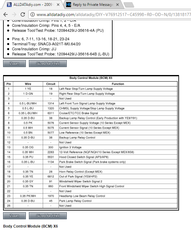

Wanting to add in the BCM so that i can retain many factory features in this swap. I am looking at the pin-outs and several wires show "Except MEX" (see attached pic) and my donor vehicle was built in Mexico Vin 3GCRKSE33AG231357. So i am wondering if those wires are just not used at all in the BCM. Any info would be greatly appreciated. Thanks

Could it be no AFM for vehicles sold for their market? Does your donor have those wires and US equipment?

the vehicle was an american truck just assembled in mexico. it has AFM. the main wiring that shows "Except MEX" is low current stuff ie: horn, battery current sensor, things like this

maybe intended for units built to export into Mexico or those made for Consumption only in Mexico
wasn't yours built for consumption in USA?

The country refers to the market where the car would be sold not necessarily where it was assembled. I’d expect those pins are active for your BCM.

Thanks guys. i did get confirmation from a couple GM techs that it doesn't matter where the vehicle was built only where it is to be sold! so i can continue on with this swap and the wiring the way i started. THANKS
