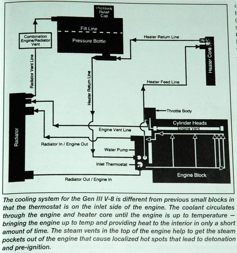

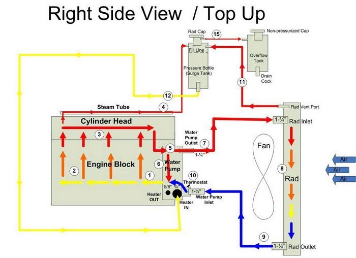

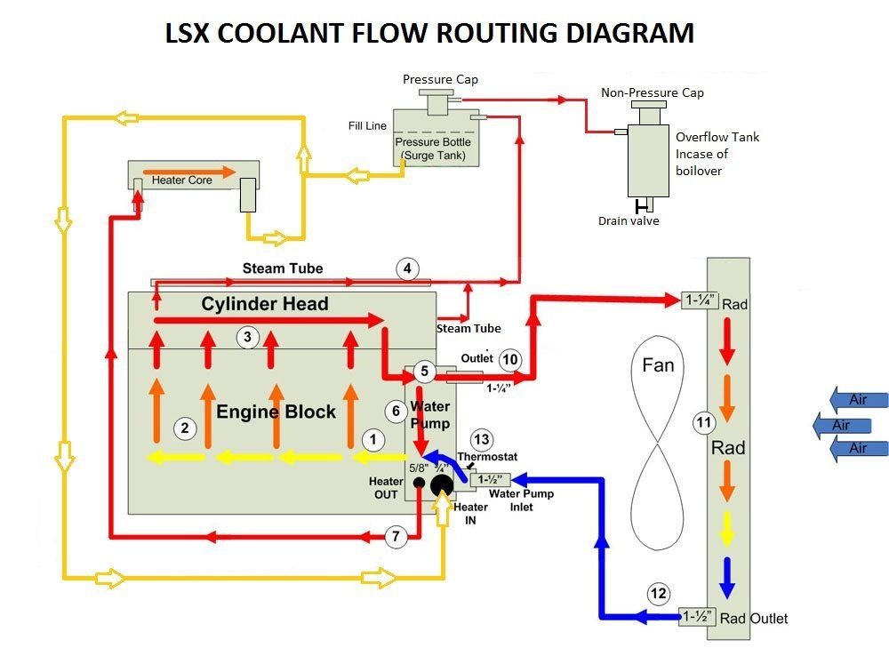

OK gotta question re cooling system design. Because my radiator will be low to clear the throttle body intake pipe, and because I'll be water cooling the turbos and these are mounted high, I'll need to run a header/expansion tank so the system can be burped. I'll be feeding the turbos via the front steam lines, and after the turbos the lines will then plumb into the header tank.
My question is where the header tank connects to the rest of the system. To the top of the radiator? To the low pressure side (eg by tee-ing into the heater return line)? Both these connections? I found the following two pics doing the rounds in other threads, one of which appears to show the latter (ie both connections), and another that doesn't seem to have a radiator connection...
The potential problem I see with the first one is that coolant looks like it could shortcut the radiator by moving from the top of the rad to the low pressure heater side. The latter one looks like it could accumulate air at the top of the radiator since there'd be no way to bleed it off (though maybe flow would be good enough to flush the air through)...
Anyway, looking for someone with experience here to advise before I mount and start welding the AN fittings on the little alu tank I've bought for this purpose... Also realise theres a few threads circulating on here re these questions but Ive found contradicting info, so please be patient with me!

Some water from the steam/vent pipes may bypass the rad, but it is a small amount really.
Although some caveats here. It is already hot water....passing it through the turbos it can get even hotter. Old Cossies used to do this too, and the hot water did deteriorate the plastic header tank they used over time.
Some fitted alloy tanks, others added another little small radiator on this line before the turbo to cool the water before it passed into the turbo. Which can make a lot of sense when you are actually trying to cool the turbo core.
I would also be inclined to add a small bleed to the hot side of the rad too ( although cold would probably be fine if it suited better ), just so there could never be any chance of air getting trapped there either.
Or a bleed at some suitable point in that area to prevent any airlocks

Thanks Stevie. I think the steam lines feeding the turbos should be OK, given that lots of people don't seem to believe in water cooling turbos at all... When you say add a bleed to the radiator, do you mean a permanently plumbed line to the header tank or a fitting to burp a few times when setting up the system? If the latter, I could use the existing radiator cap, was gonna buy a higher pressure rad cap than that used for the header tank and leave the factory radiator filler alone anyway...
I was googling a bit and think I found the original source of the second pic above on the pirate4x4 forum, funnily enough though it doesn't have that exact pic. It does have several variations thereof, though all seem to include the radiator to header tank connection!
https://www.pirate4x4.com/tech/billavista/Cooling/
I suppose another option would just be to add a small (AN4 or similar) connection from the rad to header tank, would be nice to be able to get away without though as more fittings to buy/plumb/weld...

The the rad is low, and there are already pipes or a pipe running upwards away from it...then that would become a potential air trap, negating any need for a fixed bleed on the rad core itself, as the core itself could never trap air. But shifting any potential air trap ( and bleed point ) closer to either engine or pump.
You could do a manual bleed point as some manufacturers do, but I'd prefer a full closed loop setup where it's always bleeding back to the header tank.
Just means within the rad and engine itself etc....there can never be any air trapped
