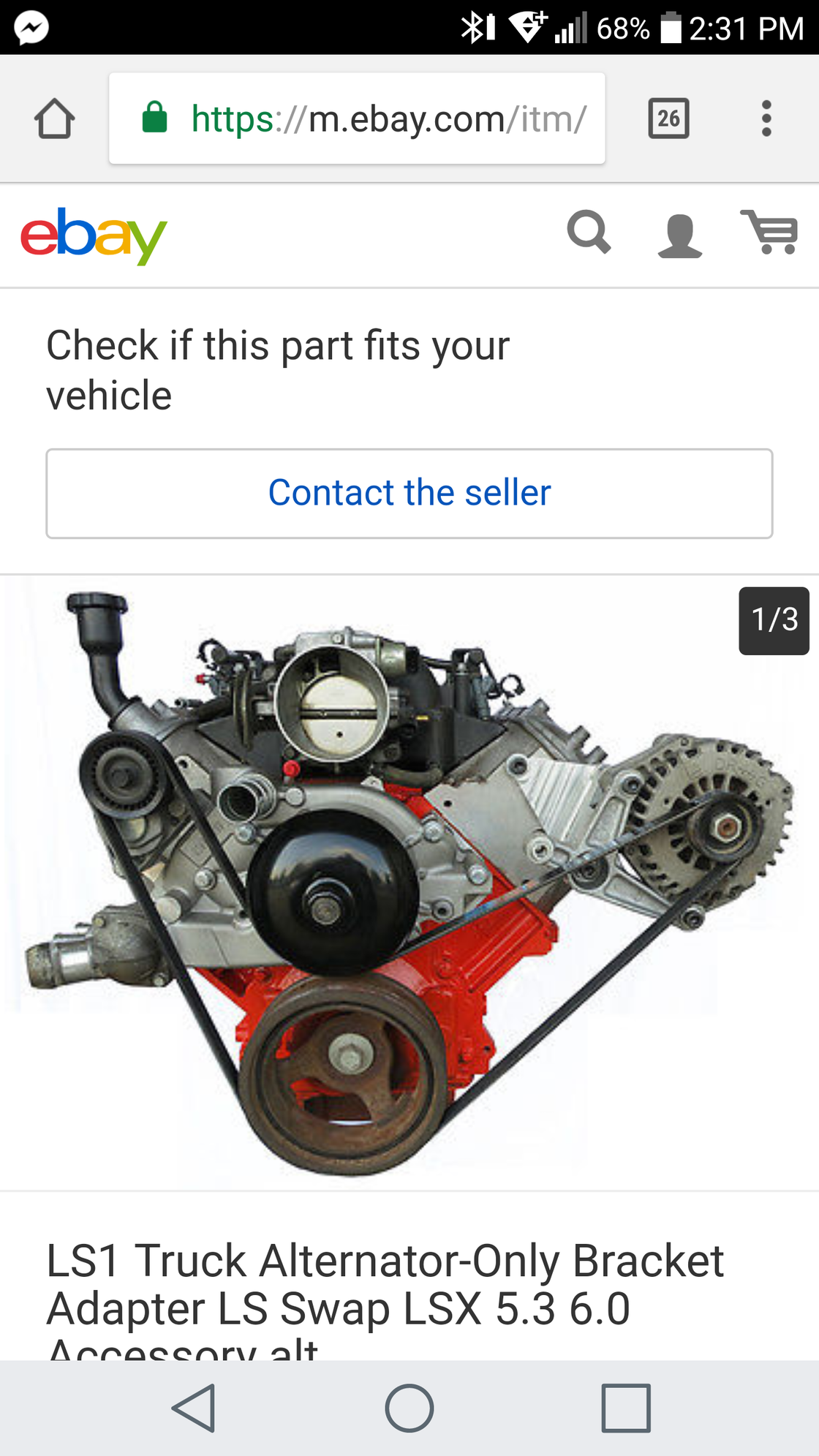

Anyone here use this bracket before? Im having trouble with it flexing under a load and throwing the belt.

If it has nothing supporting the movement front to back, it needs it. A support rod from the back of the alt. to a location several inches behind it is the idea.
