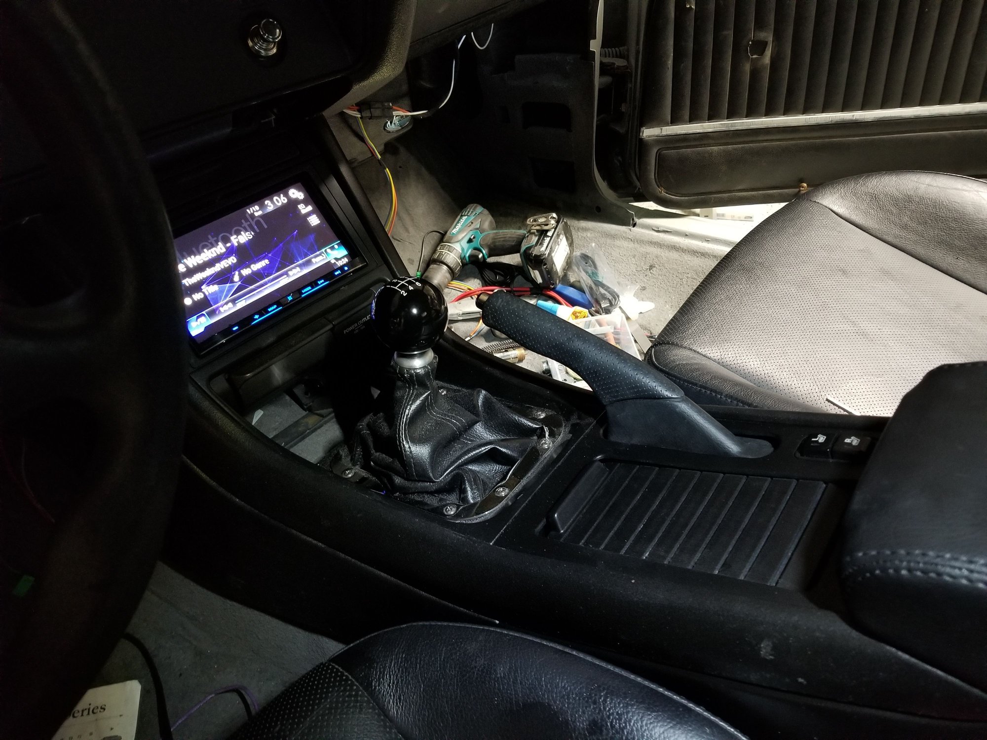

I wanted to run a modern center console, with cupholders and space for a double din radio. While at the local pick and pull, I found out of an Acura TL that looked like it'll work in the Chevelle.
Old Jun 28, 2018 | 02:27 AM
lawrenq's Avatar
Joined: Jan 2009
Posts: 283
Likes: 47
From: Charleston, SC
Later I found a different version of the console that came in a 6 speed manual cl that came with a hand mounted parking brake. It didn't take much to modify my console to fit the the different cupholders and hand brake. I used lokar parking brake cables to finish the swap.

What are you using for the manual rubber boot under the leather one up top in the console?
Old Jun 28, 2018 | 06:56 PM
lawrenq's Avatar
Joined: Jan 2009
Posts: 283
Likes: 47
I don't have one yet but I plan on using one from a mid 90's chevy truck with a manual floor shifter. I know that one from a S10 will work perfectly.
