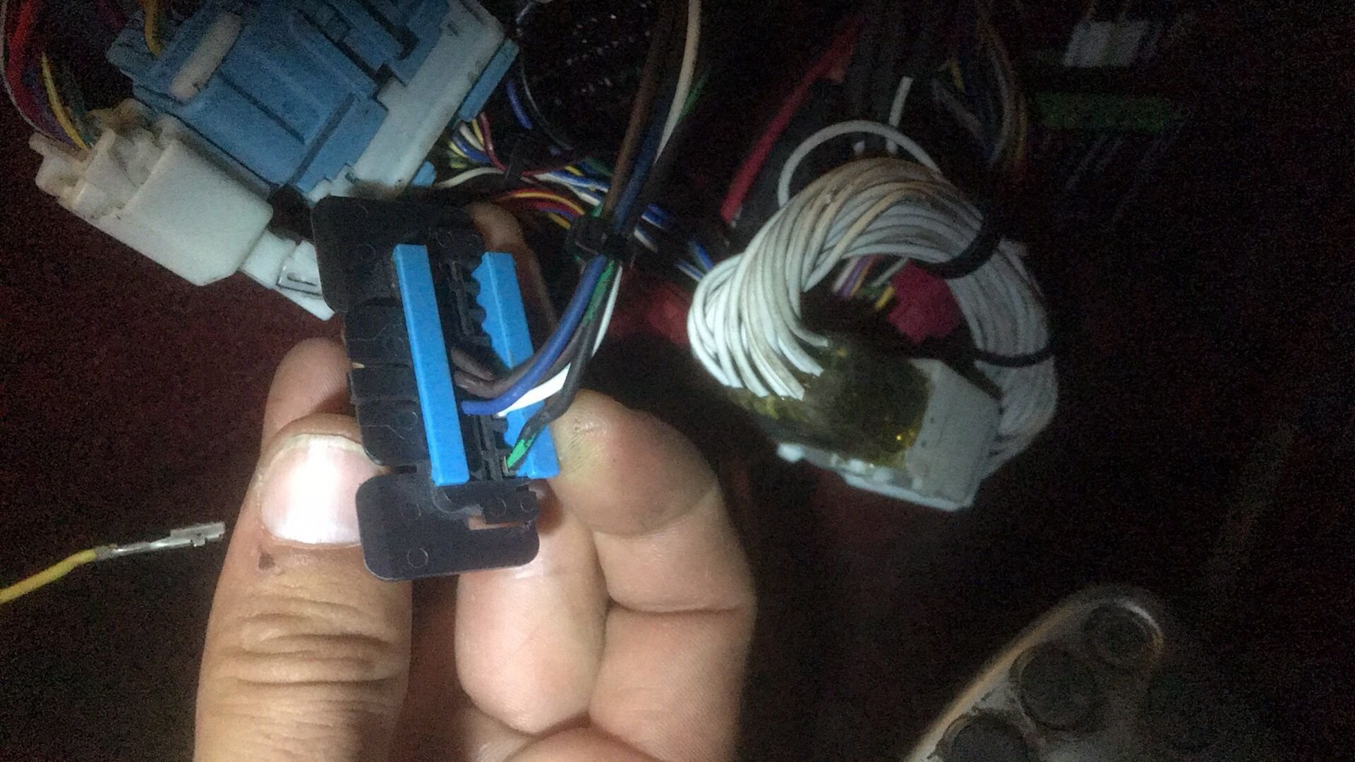

can someone tell me if this is right. The black n green is power. Two brown ground, blue is high signal, white low signal. If running to ECU correctly I should be able to link with an E38 PCM?

Anyone happen to know what protocol chevy E38 PCM would use? Cause I plug this reader into my honda obd port and it comes right up CAN. Its a dual ecu harness and he wired the chevy obd port into it.

On OBD2 16 = B+
14 = can low
4,5 = ground
6 = can hi
check numbering on obd connector
be sure all modules are connected, as modules are in series in a can system most of the time. Steve

he had pin 28, 27 backwards on the J1.... fun times.
