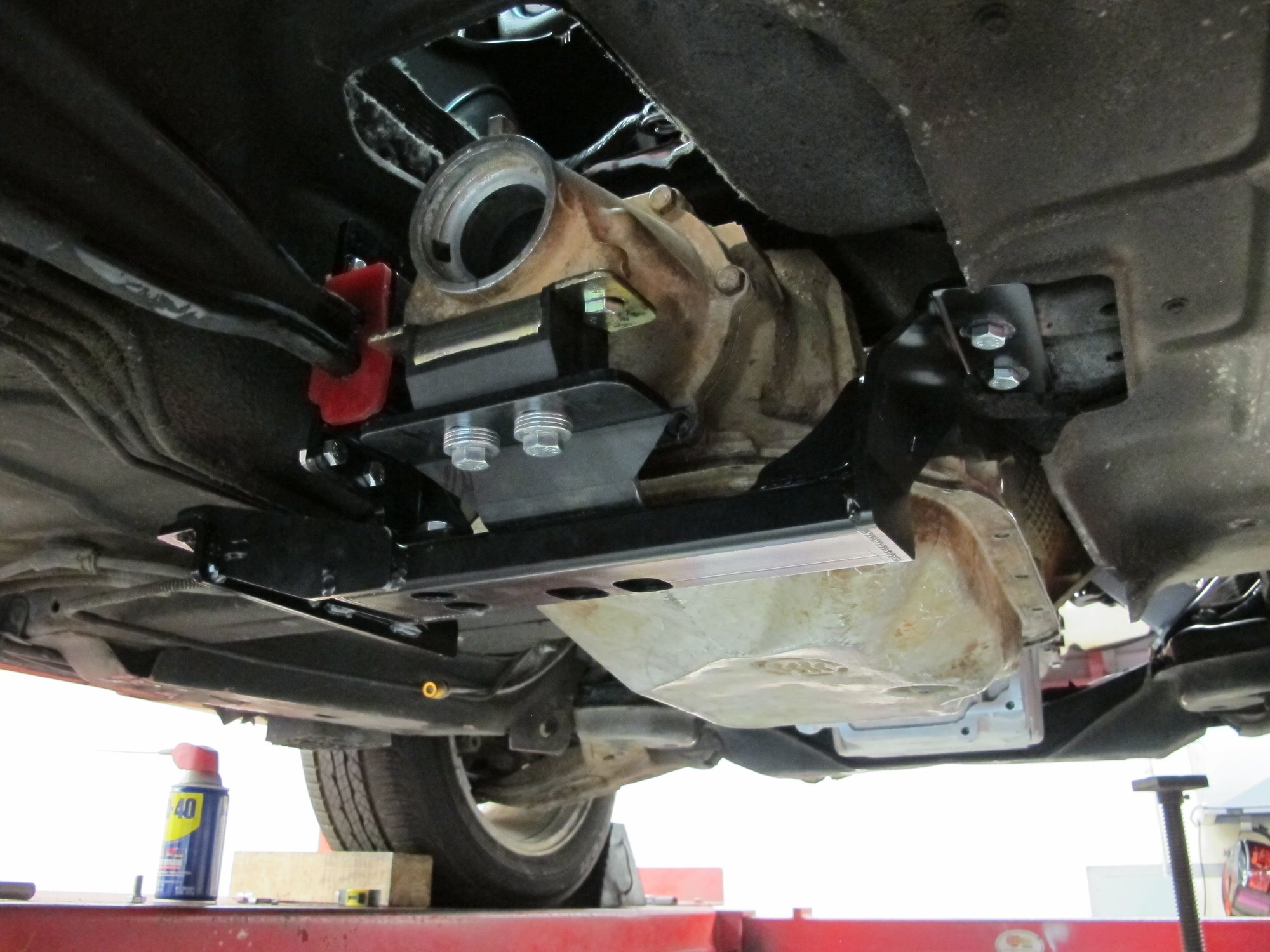

Using the Hooker 4th-gen engine mounting brackets and transmission crossmembers/adapters allows you to easily install a 4L60-4L70, T56 or even a 4L80 into a 1993-2002 4th-gen F-body car behind an LS engine. Here's what a 4L80 looks like in that application...
