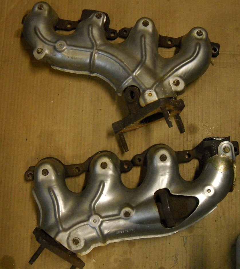

Question Which exhaust manifolds are these??
I've picked up a couple of different sets of exhaust manifolds when I was trying to figure out how I was going to build this swap, so I suppose that it's not impossible that I've mixed up what I have. I'd thought that these were '99-'02 F-body manifolds. But when I went to the dealership parts counter yesterday to price out the bolts & gaskets for the EGR (?) tubes that come out of the top of the manifolds, the dealership diagram didn't even show any kind of connection to the top of the manifolds. I also had the parts person pull up '06 truck manifolds, but same deal there.
Regardless of what these actually are, they're probably the manifolds that I'm going to use, since they seem to fit pretty well - but it would be nice to be sure of what they are. Also - does anyone have any suggestions on where I can get gaskets/gasket material for the ports below without paying "stealership" prices?? Thanks in advance!

They look like 99-02 f body to me.

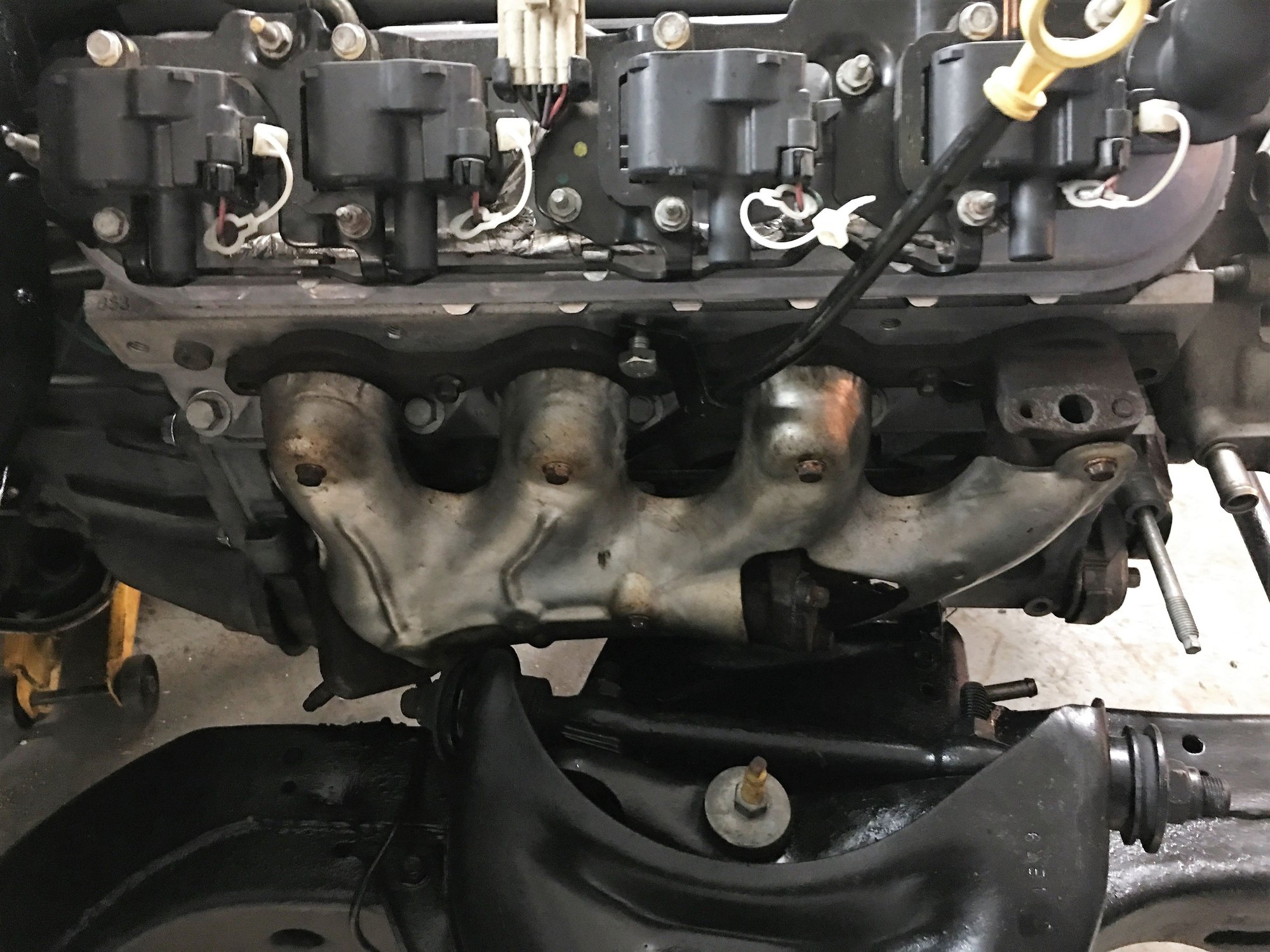

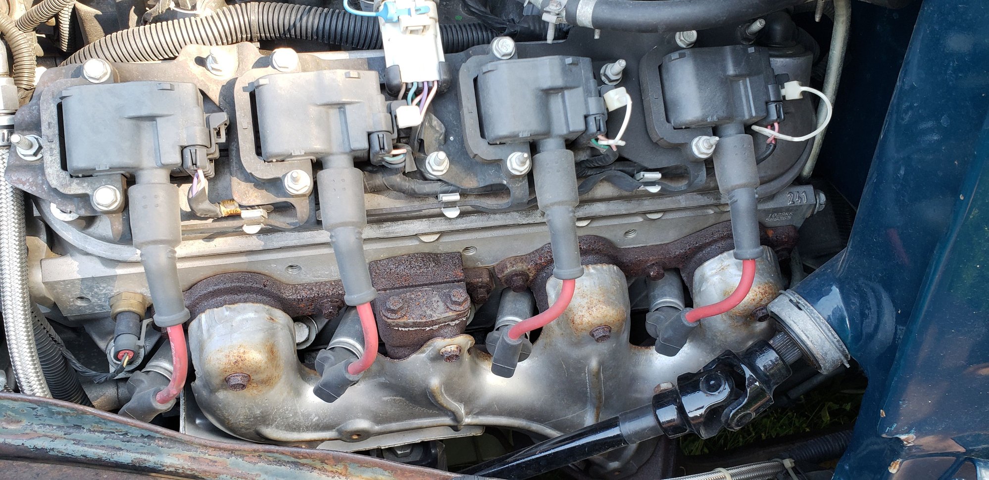

Just took this pic of my car and they look exactly like what you have. Mine is an '01 LS1 from a Camaro. You can get gaskets at any parts store . They usually have gaskets for the air tubes with them.

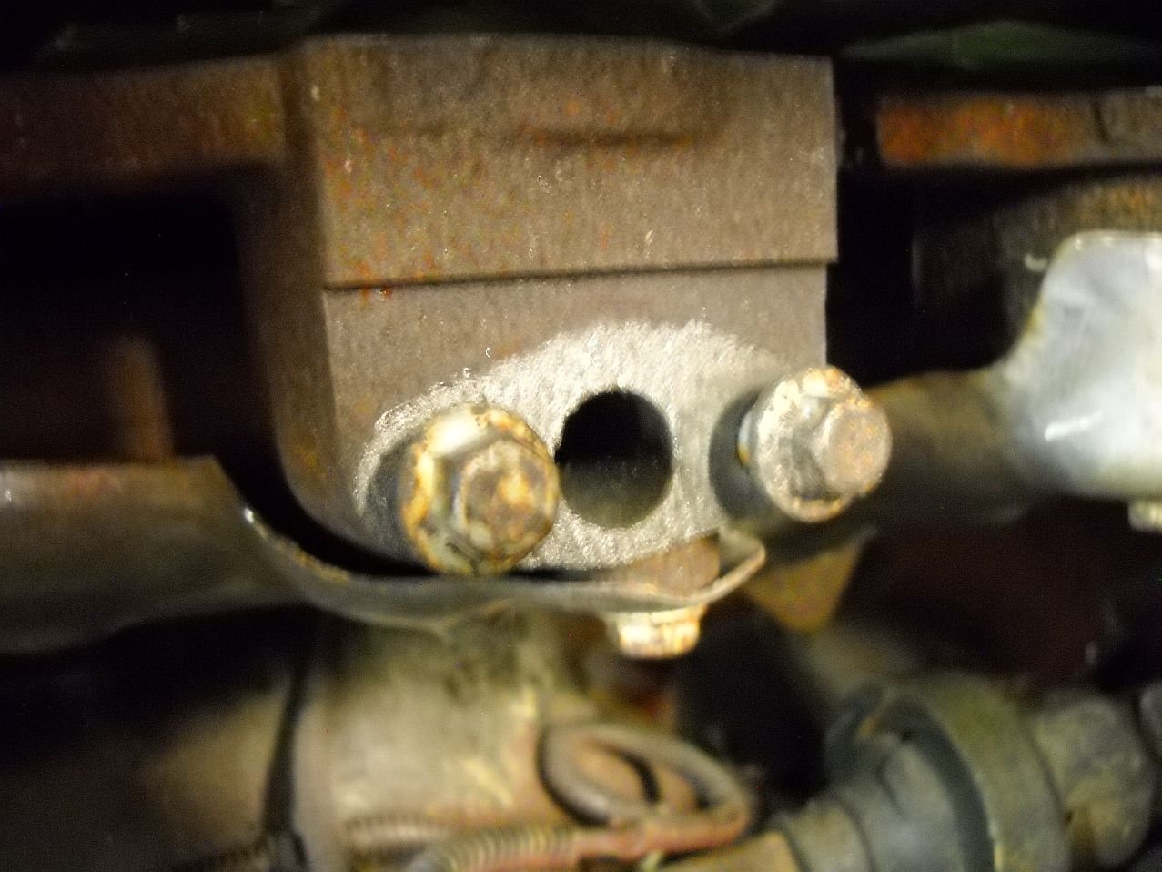

I used F-body manifolds, but they didn't come with those block-off plates. I had to buy block-off plates on eBay, and they came with the gaskets.
passenger side
