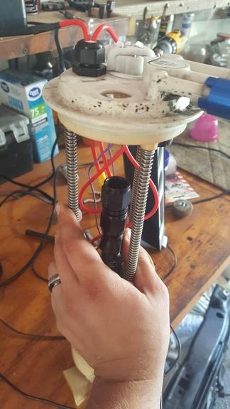

In my Isuzu, I have two pumps and two hotwire kits, plus a digital fuel pressure gauge. I kick on the second pump occasionally to keep it loose, but I've never had an issue with my setup. The S10 bucket is huge compared to a 4th gen Fbody, so I absolutely threw a second pump in there. I think your issue is wiring to the pump, but the bucket is plenty large enough to add a second if you feel ambitious.

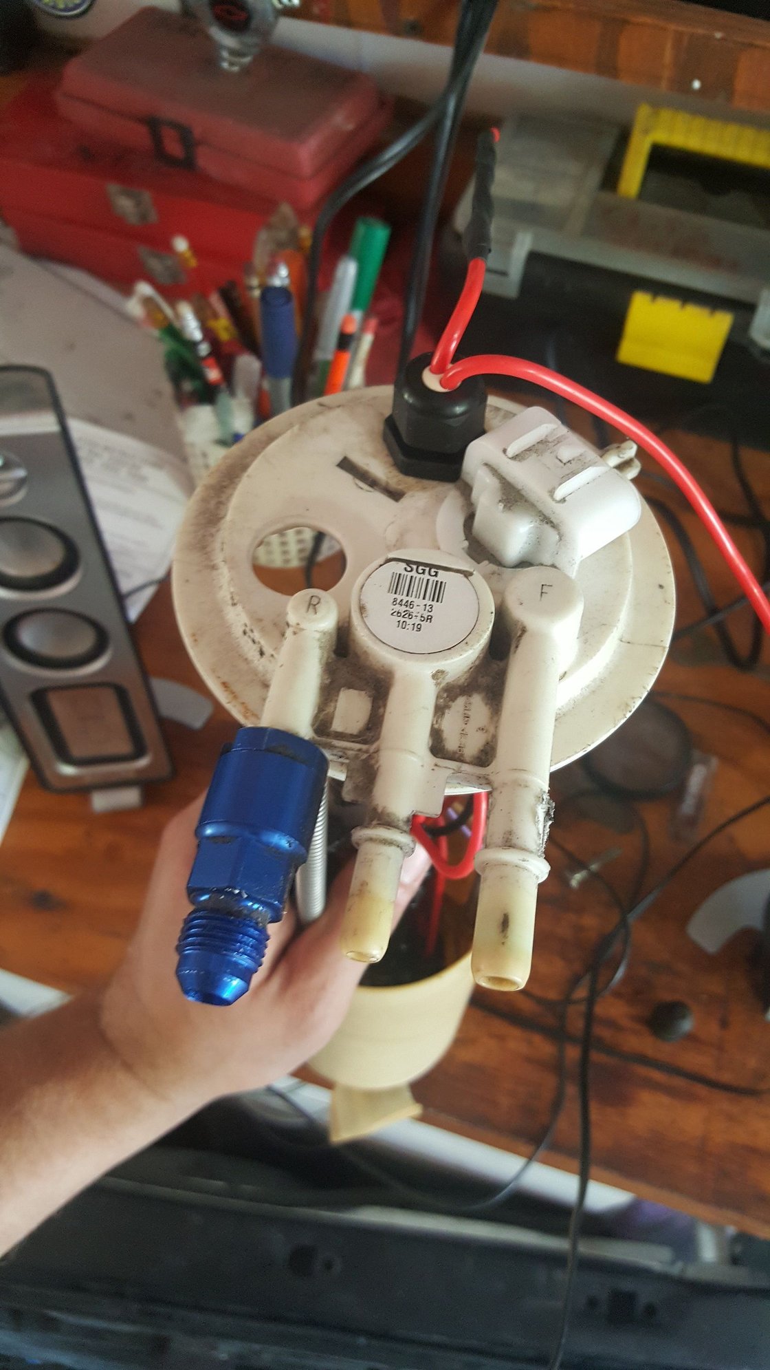

OK thanks Melonwheels, I just cut a hole in my housing and put the sock through there when I put the Walbro in, I still run the stock 5/16 lines or whatever size they are? I like the big wires coming out of that plug, that is part of the hotwire kit? That oval plug looks like mine, do you remember what kit you used?

I still use a bucket, just cut it open. The wires coming out of the electrical bulkhead are for the second pump, they are not part of a kit. PsychoSid bought some teflon insulated wire on eBay and I used some for my second pump. The primary pump wiring and level sender still go through the oval bulkhead, which is stock for the truck. I have a hotwire kit for each of the pumps, relays mounted nearby at the bed support. Racetronix supposedly sells all that stuff except the electrical bulkhead, which I bought from Jegs. I'm surprised I don't have a picture of the 8AN 90 bulkhead, but it;s in the hole there in the pictures.

Cool I have had the bed off like 5X by now so not a big deal I guess, I'm going to order that racetronix kit. I also have a 02 Camaro M6 super clean that I'm going to be boosting this winter probably run dual pumps in that because I have a E85 station a block away from my house. I will be referring back to those pics. Thanks guys.

Sounds like you're in the right direction, but be warned, the Fbody bucket is much shorter so you don't have all that space to get the discharges together. On my Fbody, I had to run two 6AN bulkheads and combine outside the tank. PsychoSid managed to do two pumps in a bucket with a single 8AN bulkhead, his would be the one to copy for that car. Good luck!
