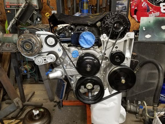

I just did this with an LS6 intake, same deal. There are several good LS6 swap threads here. Or this one on performance trucks. My finished product, I built brackets to install an R4 compressor so I could keep my entire system including hoses.
http://www.performancetrucks.net/for...e-swap-359987/

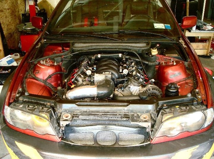

Yes. In E46 but basically the same thing. I even used the “stock” BMW cooling system.

perfect, do you have any pictures ????

thank you. this setup would not clear the hood and my swap is going into a small car.

Which part do you need pictures of? I can take some pics of whatever you need a better - um - picture of. It was a fairly straightforward process, I used CX headers and engine mounts.
