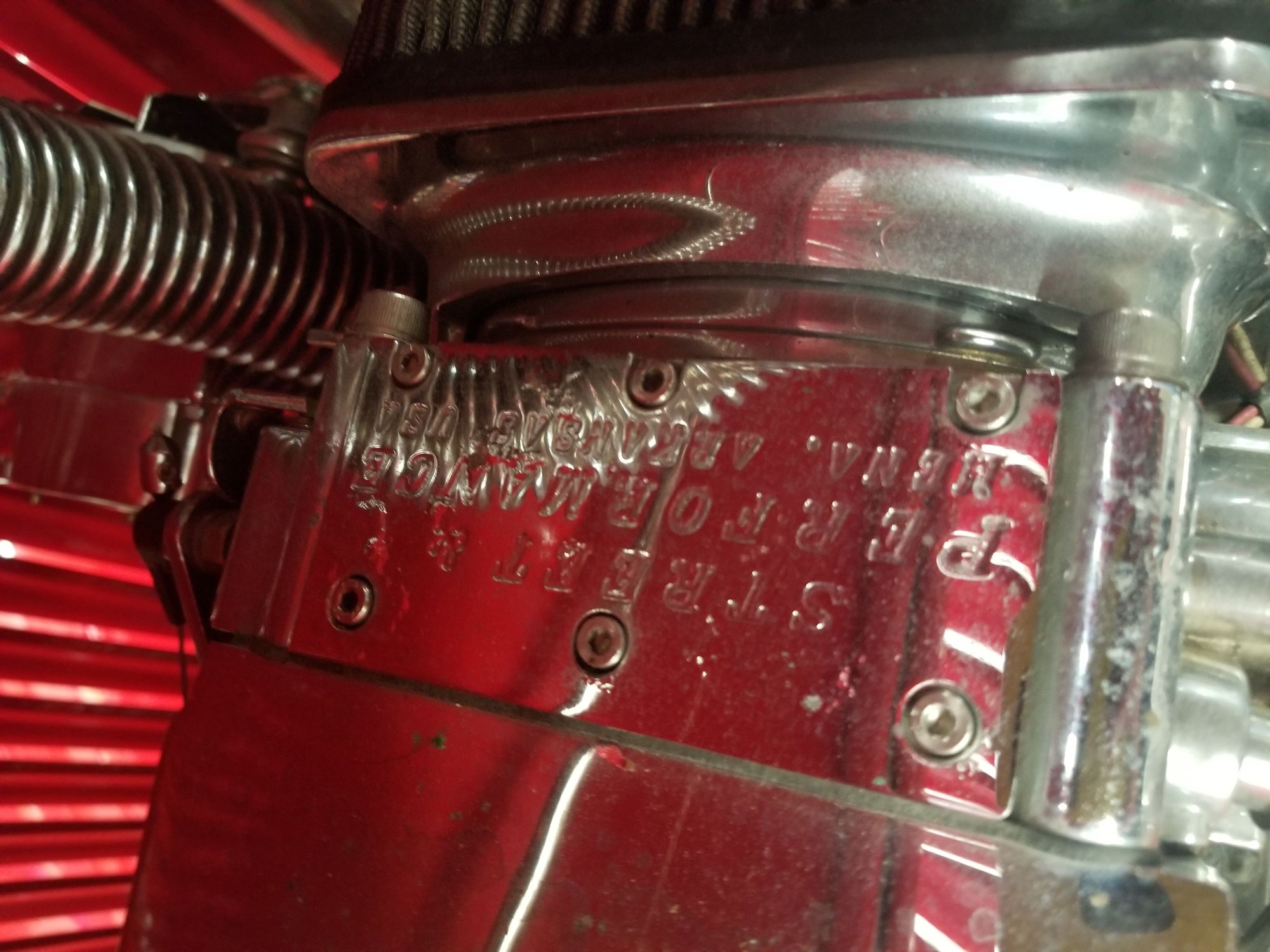

More questions guys, can anyone tell me from the pics if this is TBI, TPI or something else? Thanks in advance

TBI is Throttle Body Injection, which the above is not. TPI is Tuned Port Injection, which is what came on Chevy Corvette and Camaro V8's in the 80's and 90's. What you have above is port fuel injection, but don't know who made it.

It was made by Street Performance out of Arkansas, and as I understand it, they are no longer in business. Any ideas or pointers on who might be knowledgeable on this?

It looks like it uses the same sensors, injector type and throttle body as the old GM TPI injection. Possibly even the ECM, or after market version of one. I would look at it from that perspective.

The intake and upper plenum are custom but the rest of it is basically GM TPI stuff, like the throttle body, injectors, sensors, ECM ect. Its basically a TPI so anyone that can work on those can work on it, they're pretty simple to work on really.

TPI Hybrid or port fuel? I’m really new, a true newbi when it comes to injected engines. My background is carburetors and circle track racing... Dirt. I’m glad you guys are around for sure. The performance is really good and I love the appearance, just don’t know anything about it

But to answer the above question- It's a TPI-based system with a custom manifold and GM TPI sensors, injectors, and throttle body.
