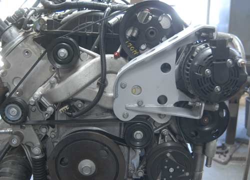

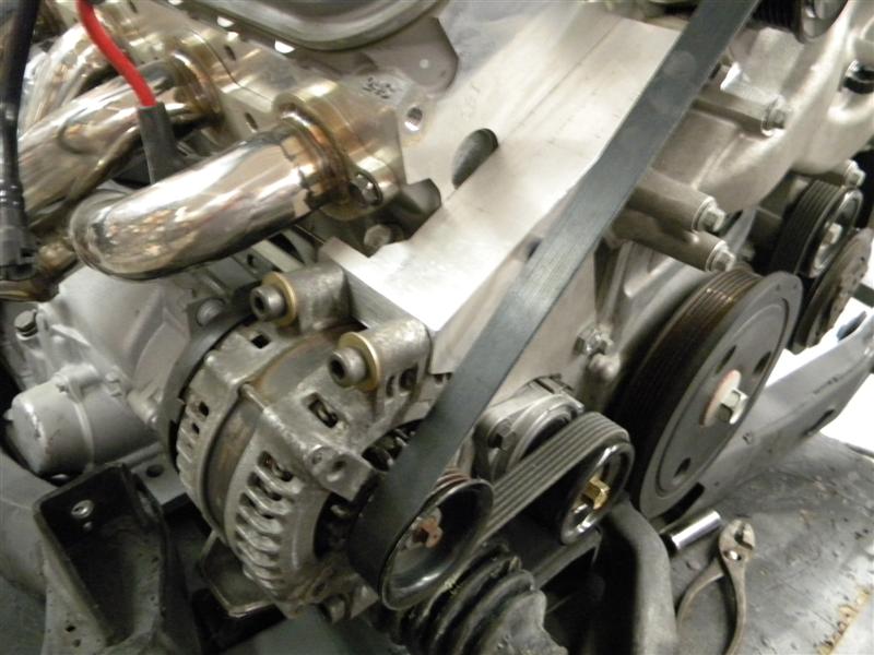

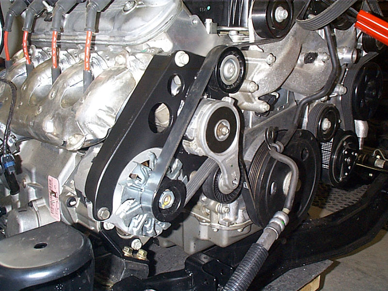

Notch the frame rail and mount it down low on the rear side of the engine (stock Fiero alternator location) - no one sells this bracket, so it must be custom fabricated. Here are 3 versions.
Cantilevered on the front top of the engine - word of caution, most people who start with this route, end up doing something different due to never ending belt squeal.
Delete A/C and run the alternator where the AC compressor is:
This version will not work with the stock LS4 water pump, so you will need to run an electric water pump setup.
Run an electrical water pump to free up room for the alternator and AC compressor to fit in the forward and lower position:
Lots of custom modifications to the stock LS4 water pump to mount everything down low and in front (this is the setup on my LS4/F40 swap).
