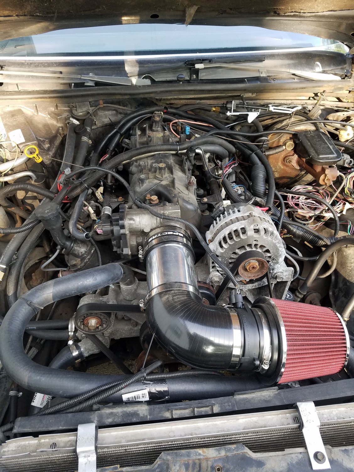

I'll add some photos of my Buick in the next post, because who doesnt like pictures eh?! It ran a 20.8 sec quarter with the 3.8L v6, 16.2 sec with a 305 and a 14.2 sec with stock 5.3l. So its been a fun experiment so far!
