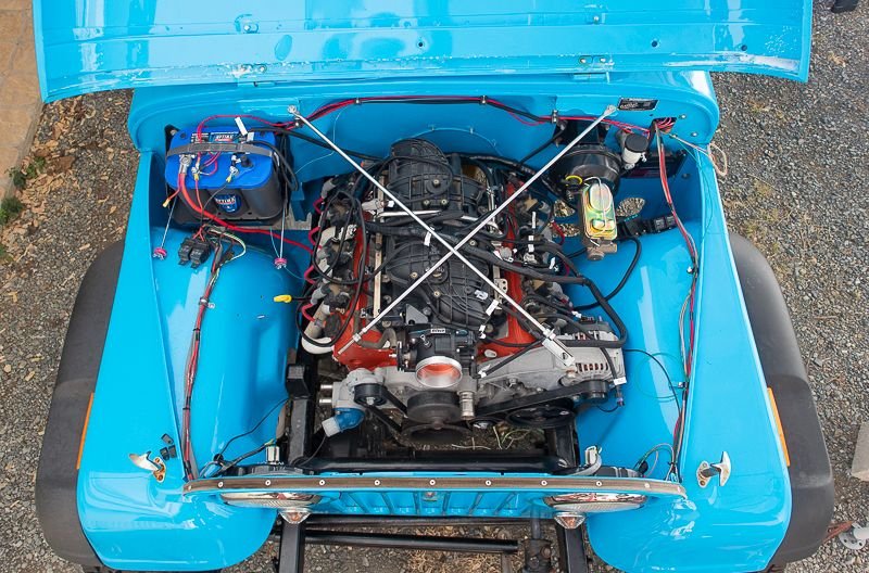

I’m trying to finish the LS swap on my 65 CJ5 and have run into a clearance issue. The engine compartment is so short that the air intake tubing interferes with the radiator. I’m currently set up with a Trailblazer SS intake and a FiTech DBC 92mm throttle body. I have already switched to the GMPP Corvette accessories kit. Does anyone know if any other intake moves the throttle body toward the engine when compared to the TBSS intake?
Heres a picture of the engine bay without the radiator.
Thanks
