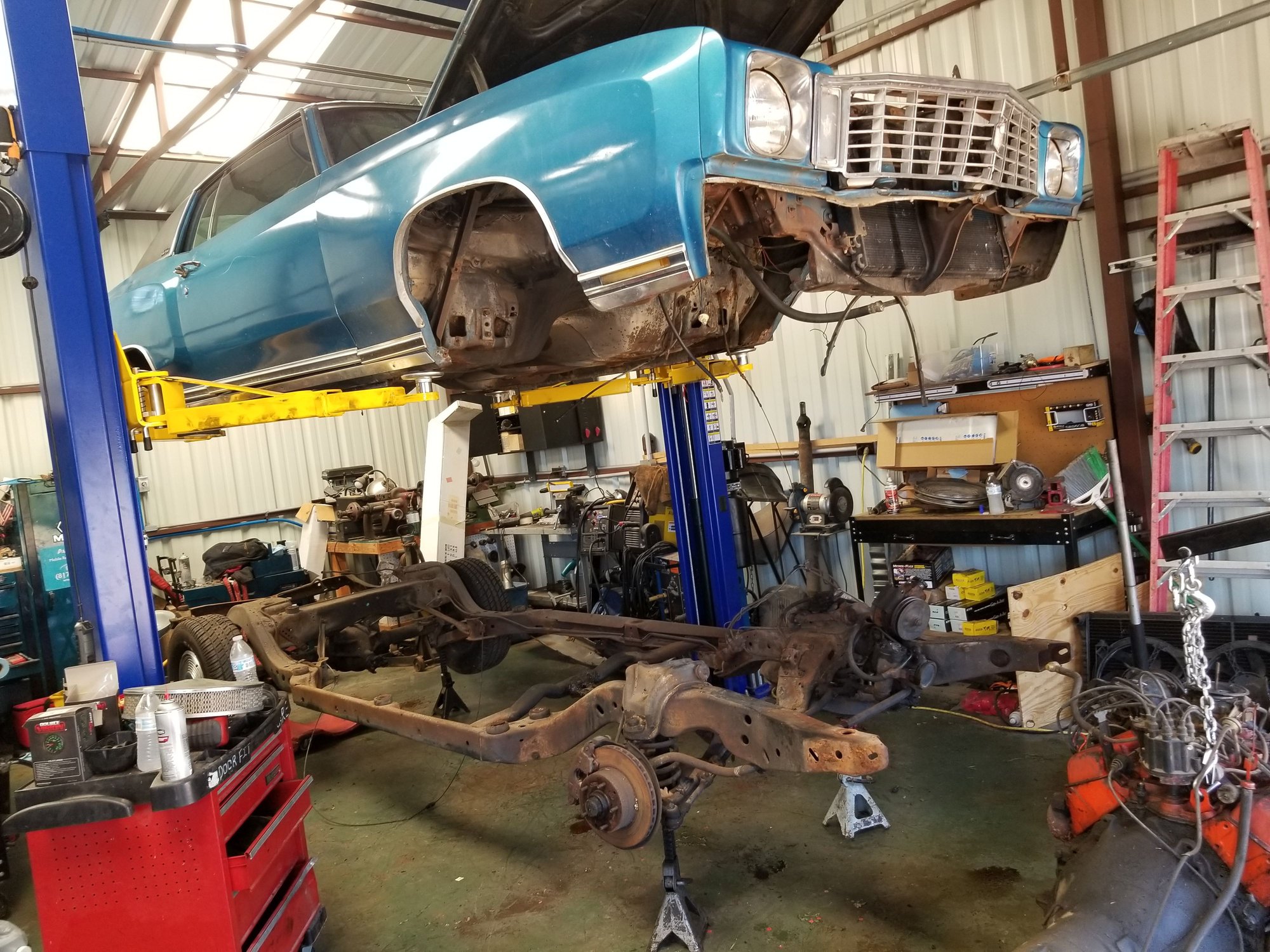

Into the shop
Old and tired

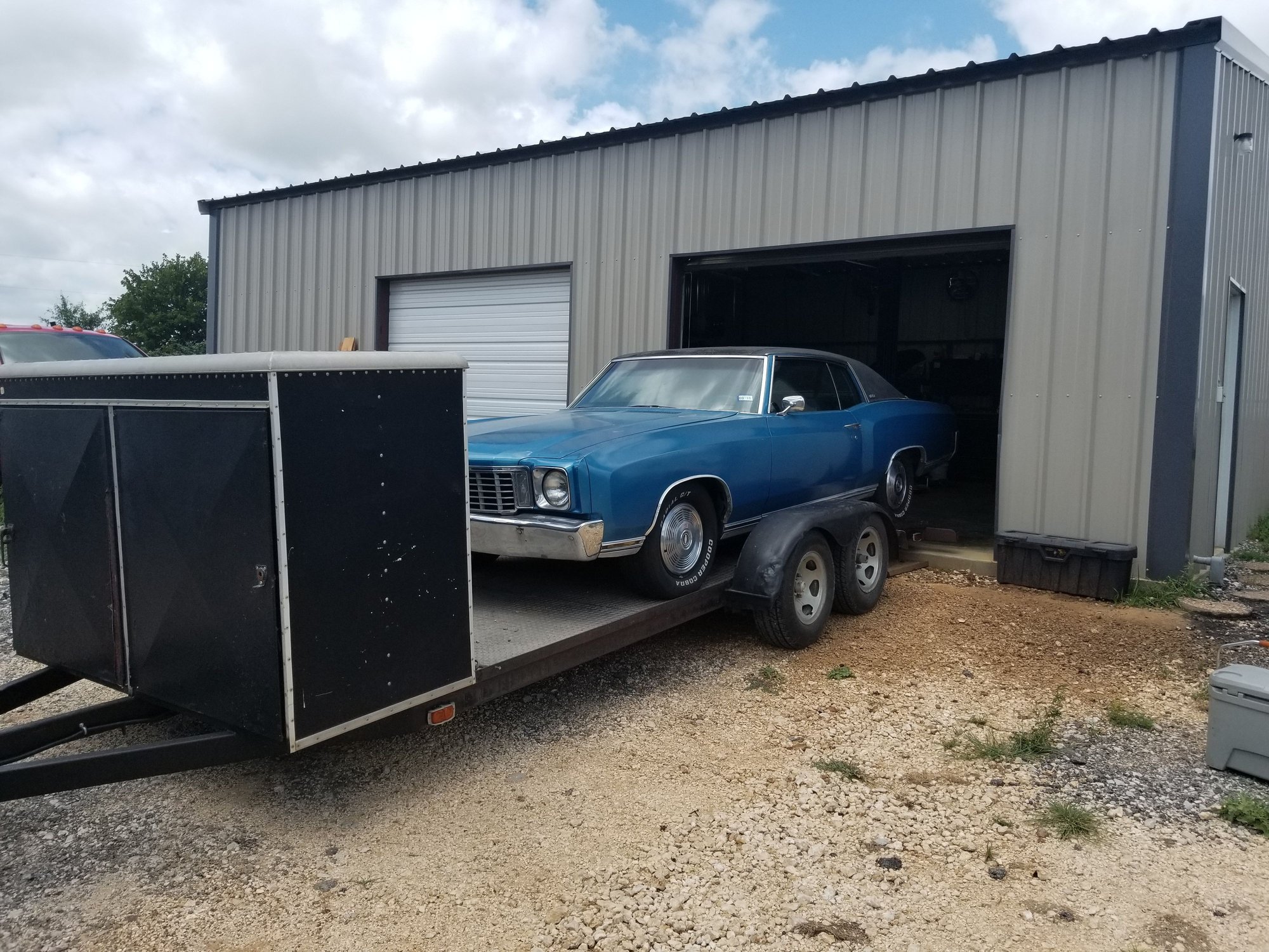

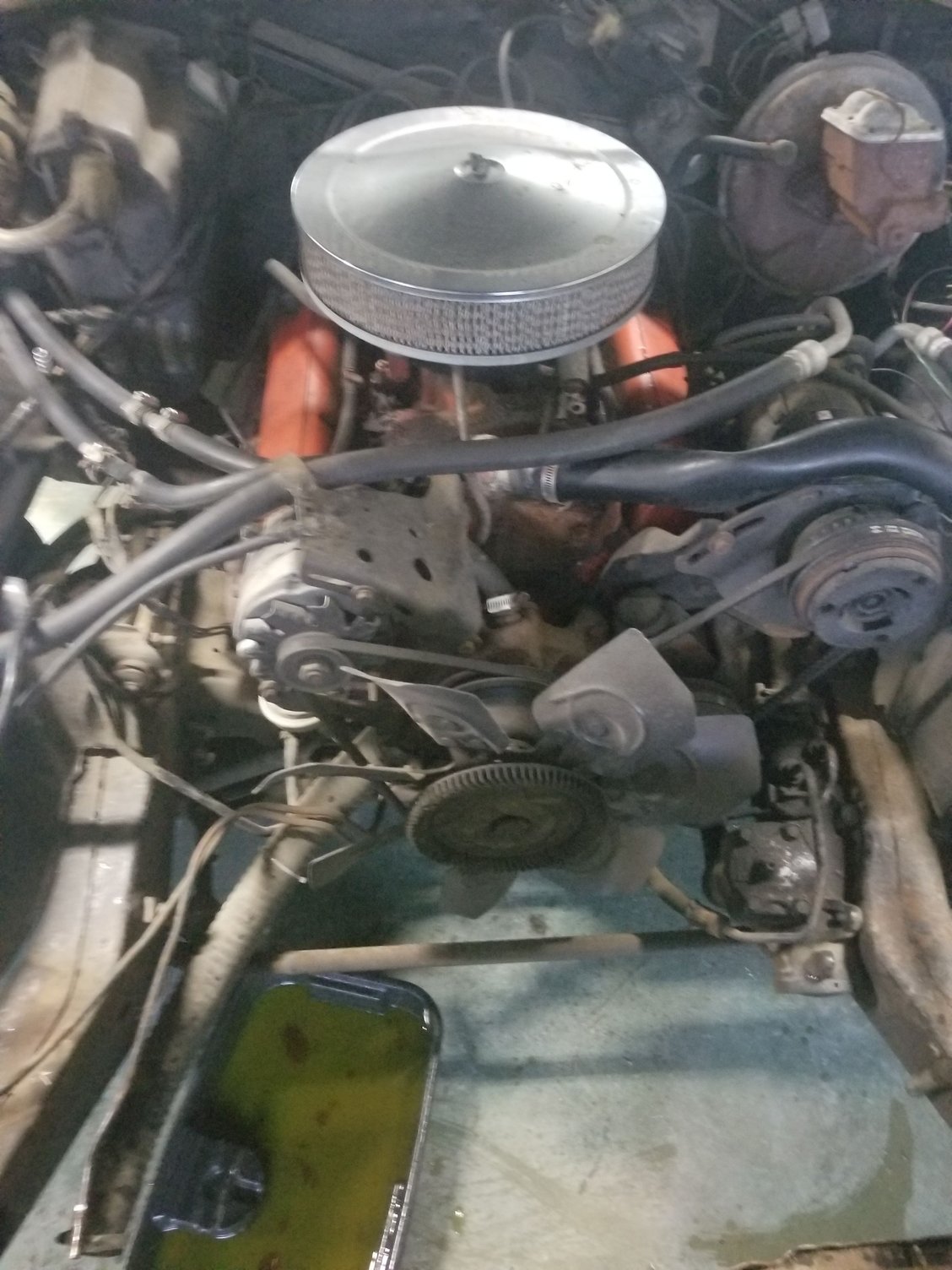

A customer of mine was looking for a car to start a project but just wasn't sure what he wanted. He decided to build something to scratch the itch until he finds what he really wants as a keeper. 2 days later a friend of mine texts me , telling me his 72 Monte has to go. This car was bought used by his dad and driven for a few years, handed down to him, driven for driven for 35 years, then given time his son and driven for another 5 years. All that to say it's been a good car for that family.
This is the last year for the GM A body getting some much needed help in power. Out with th 2 barrel 350 with 165 HP and in goes a .040 over 5.3 with a mild cam.
Lots of other work is getting done while we are at it.

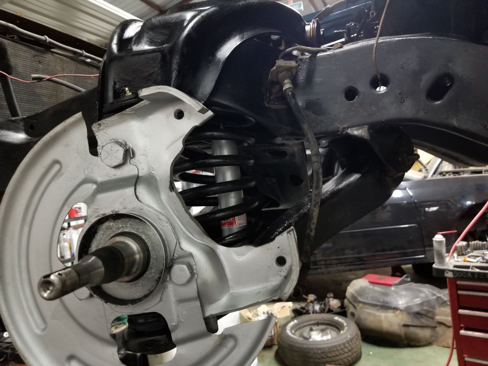

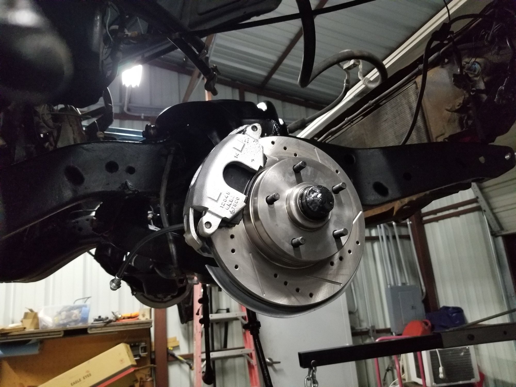

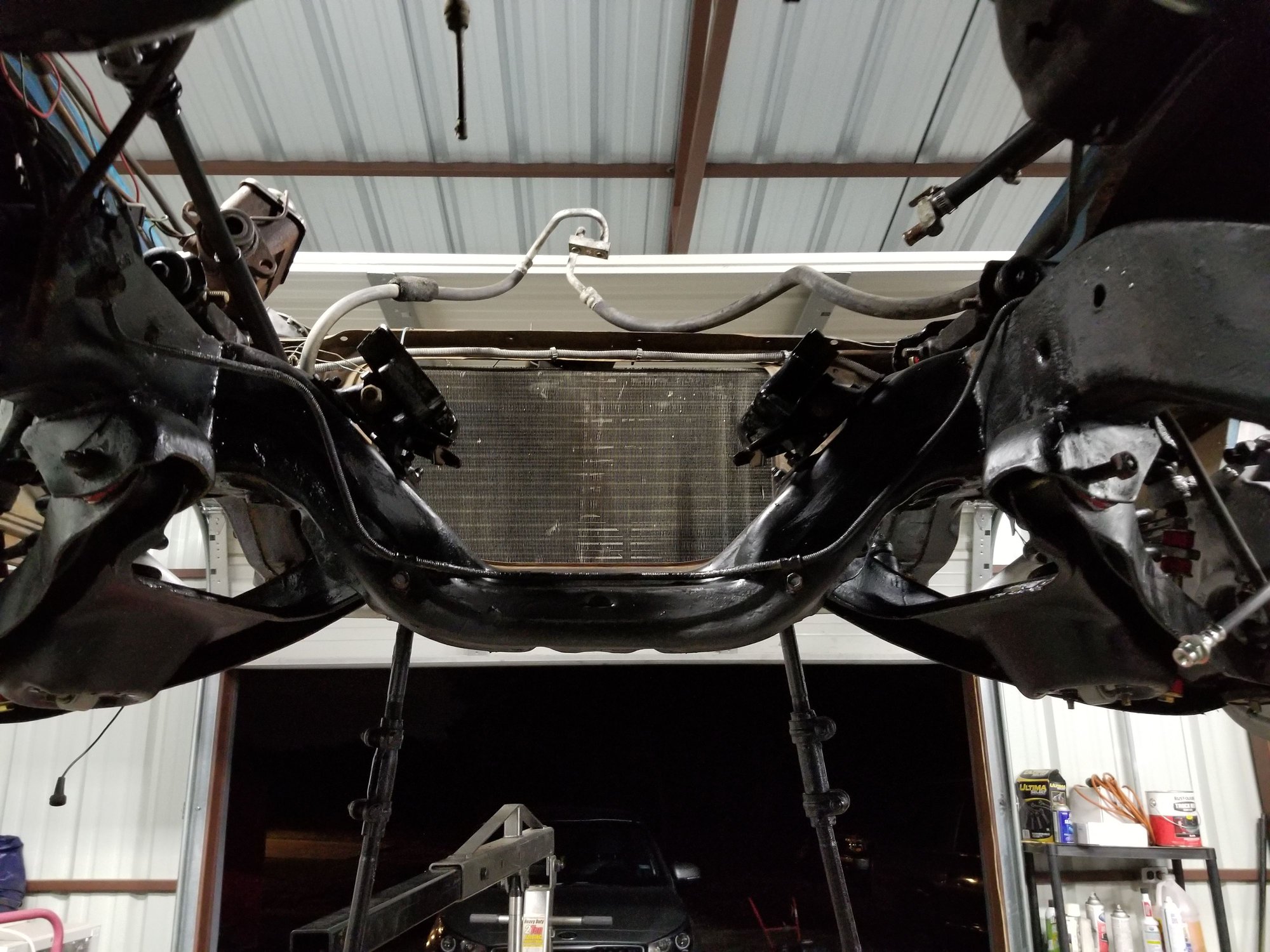

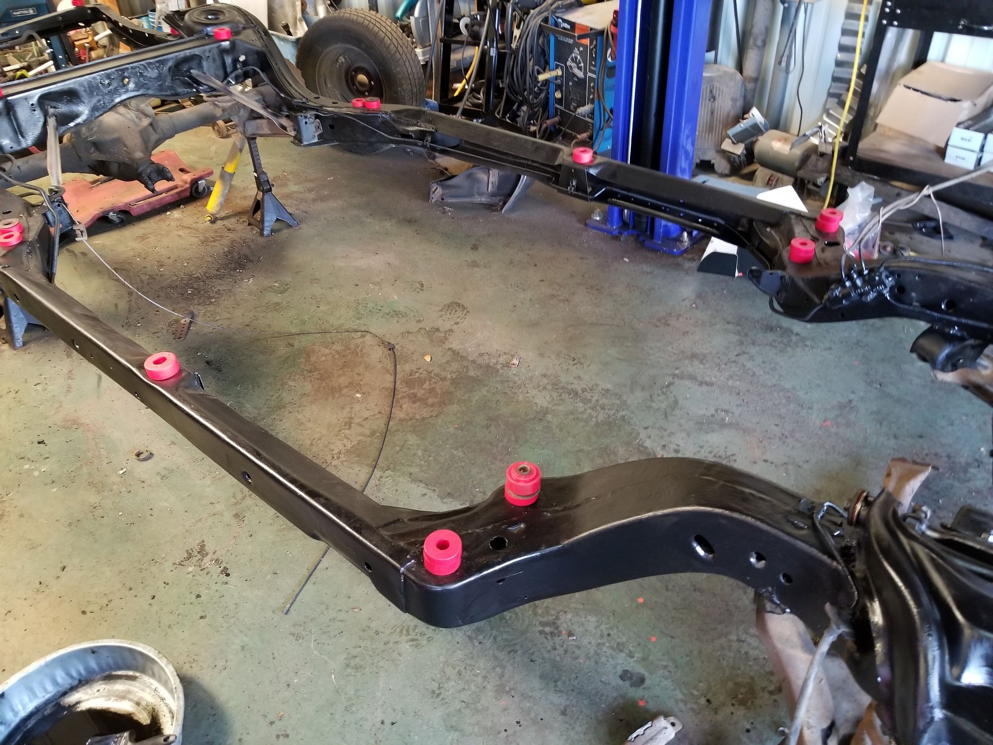

Body off to clean up and replace clapped out body mounts
Cleaned up and ready to go back together
Front suspension rebuilt and cleaned up

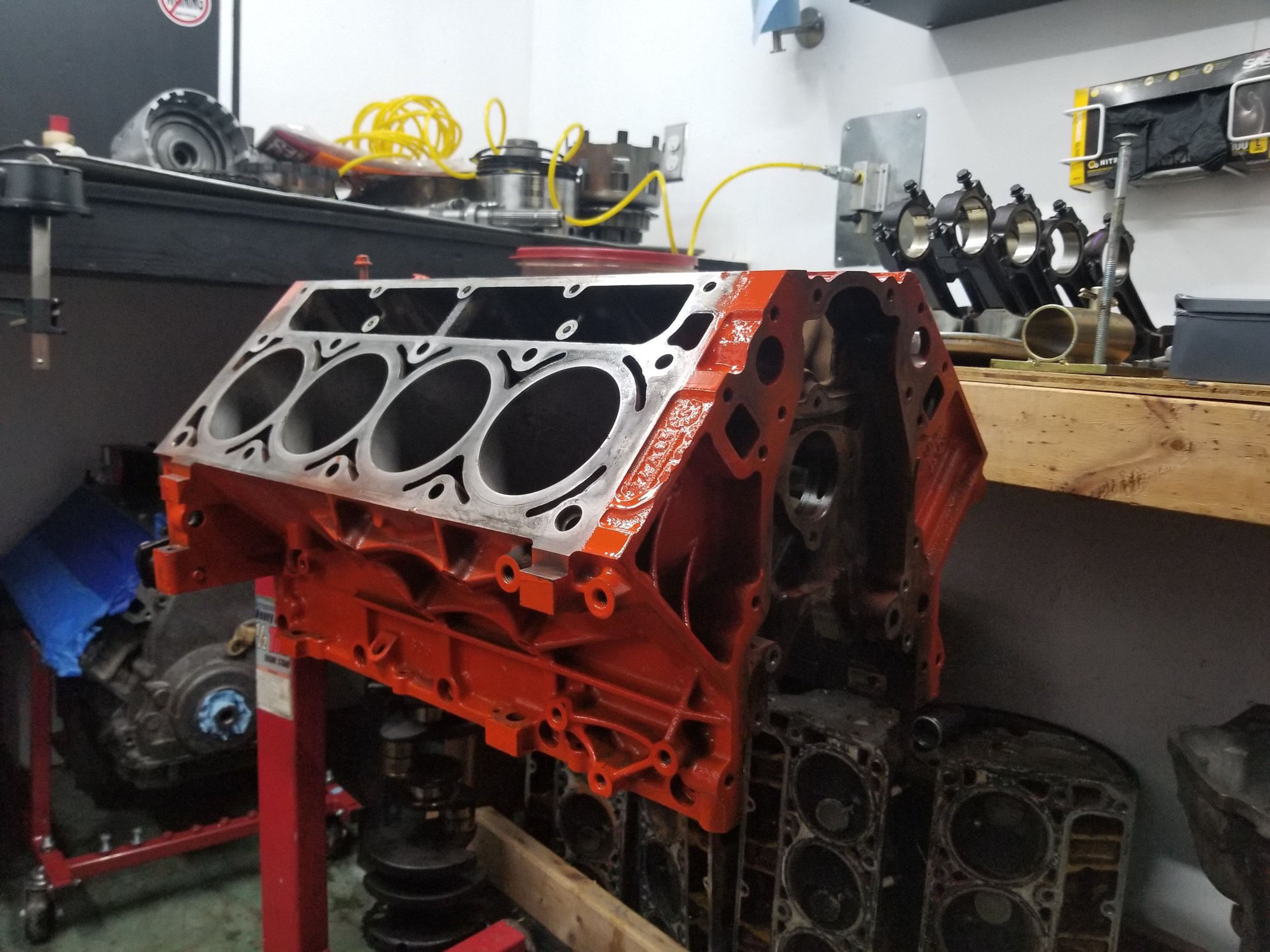

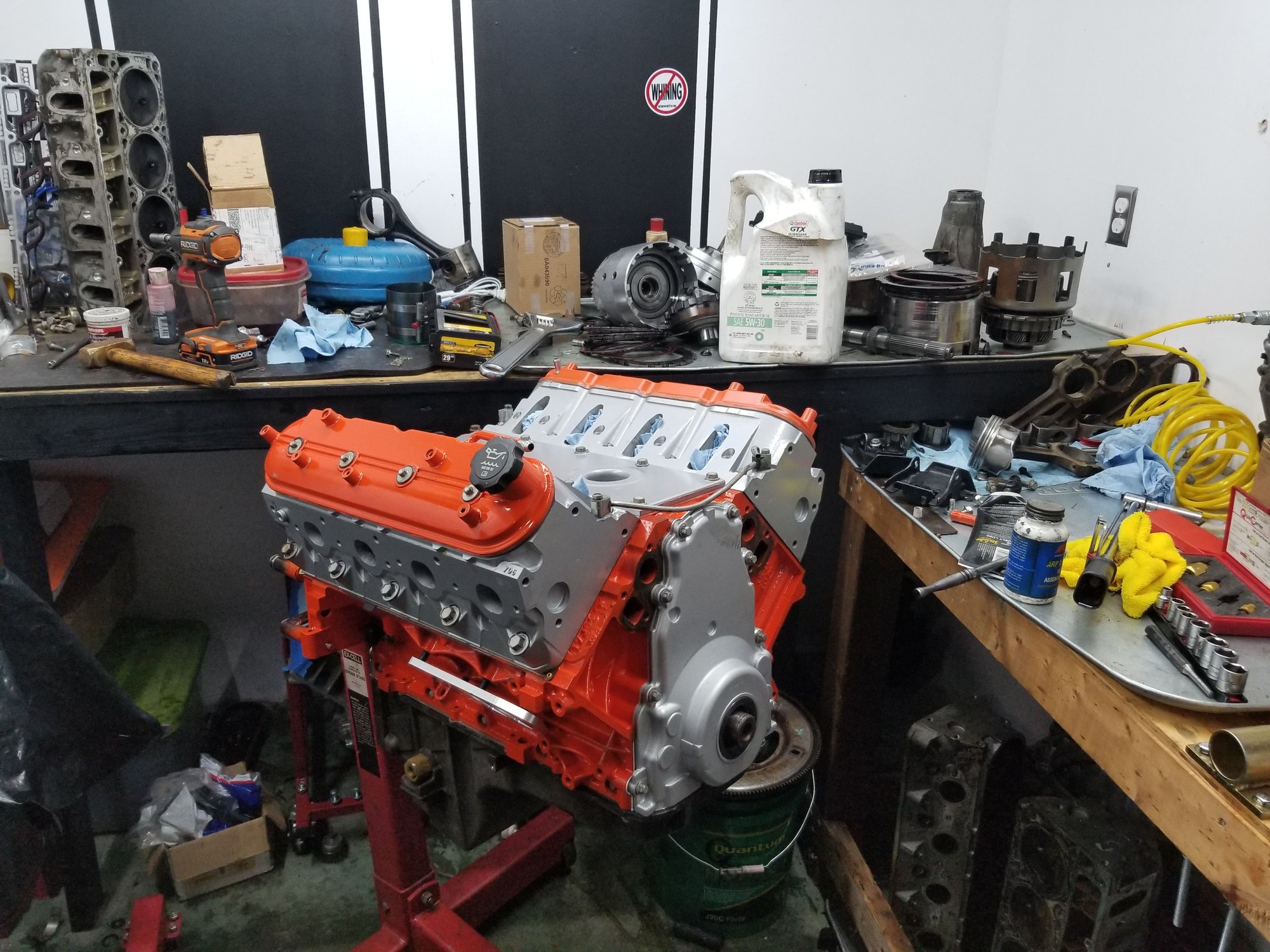

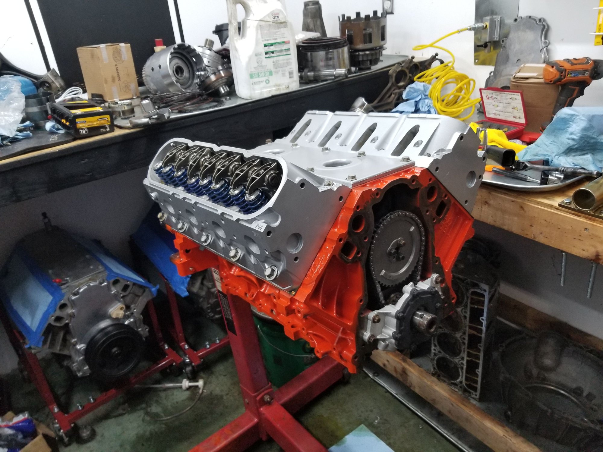

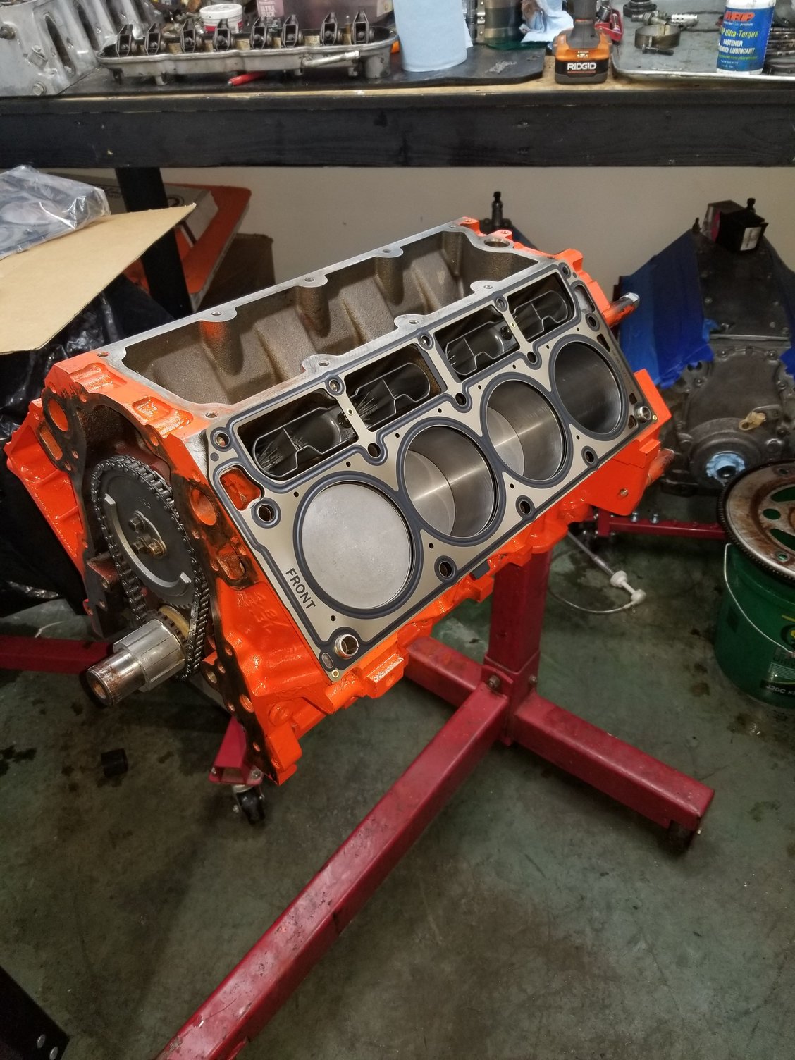

Engine build time

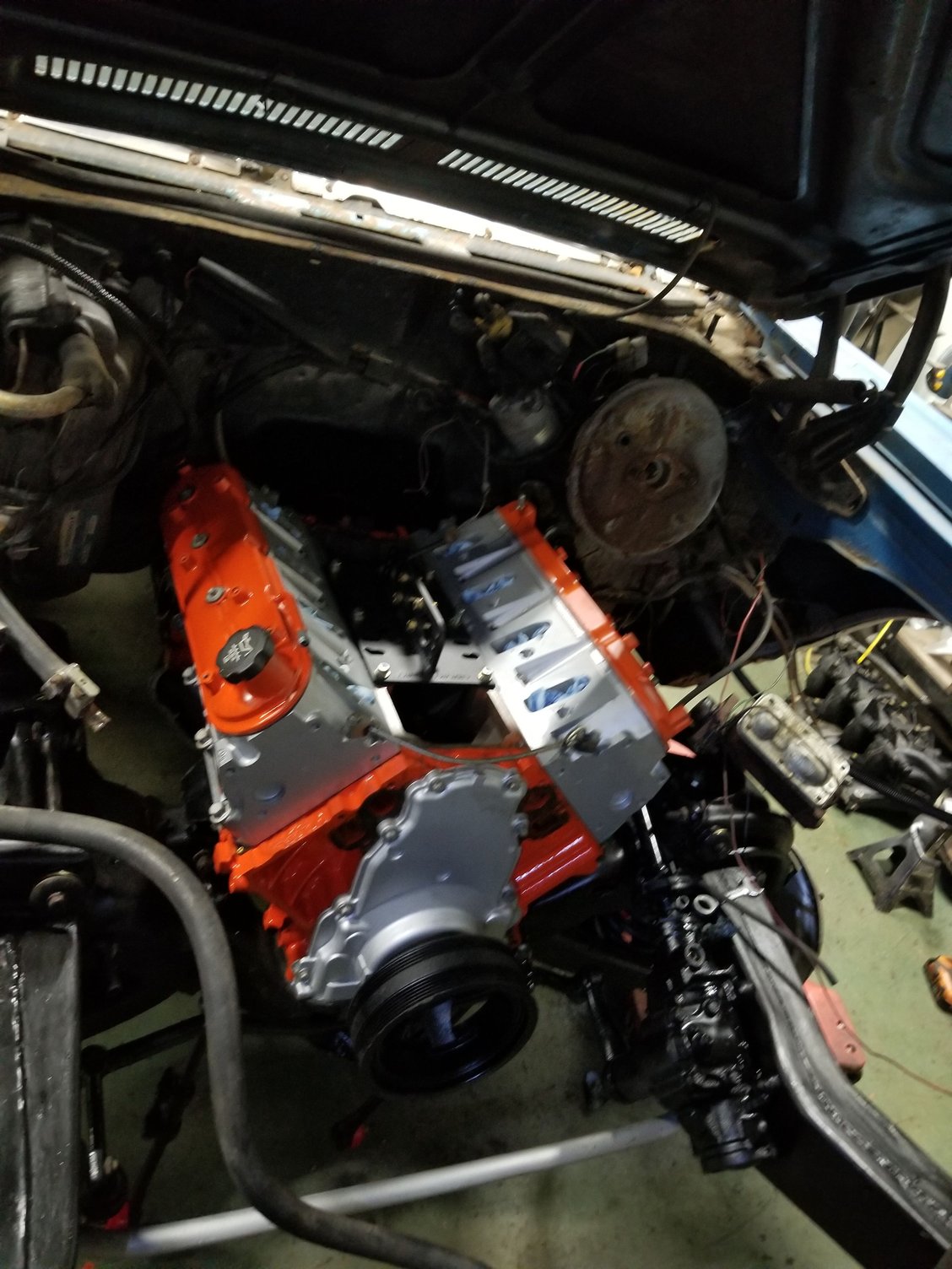

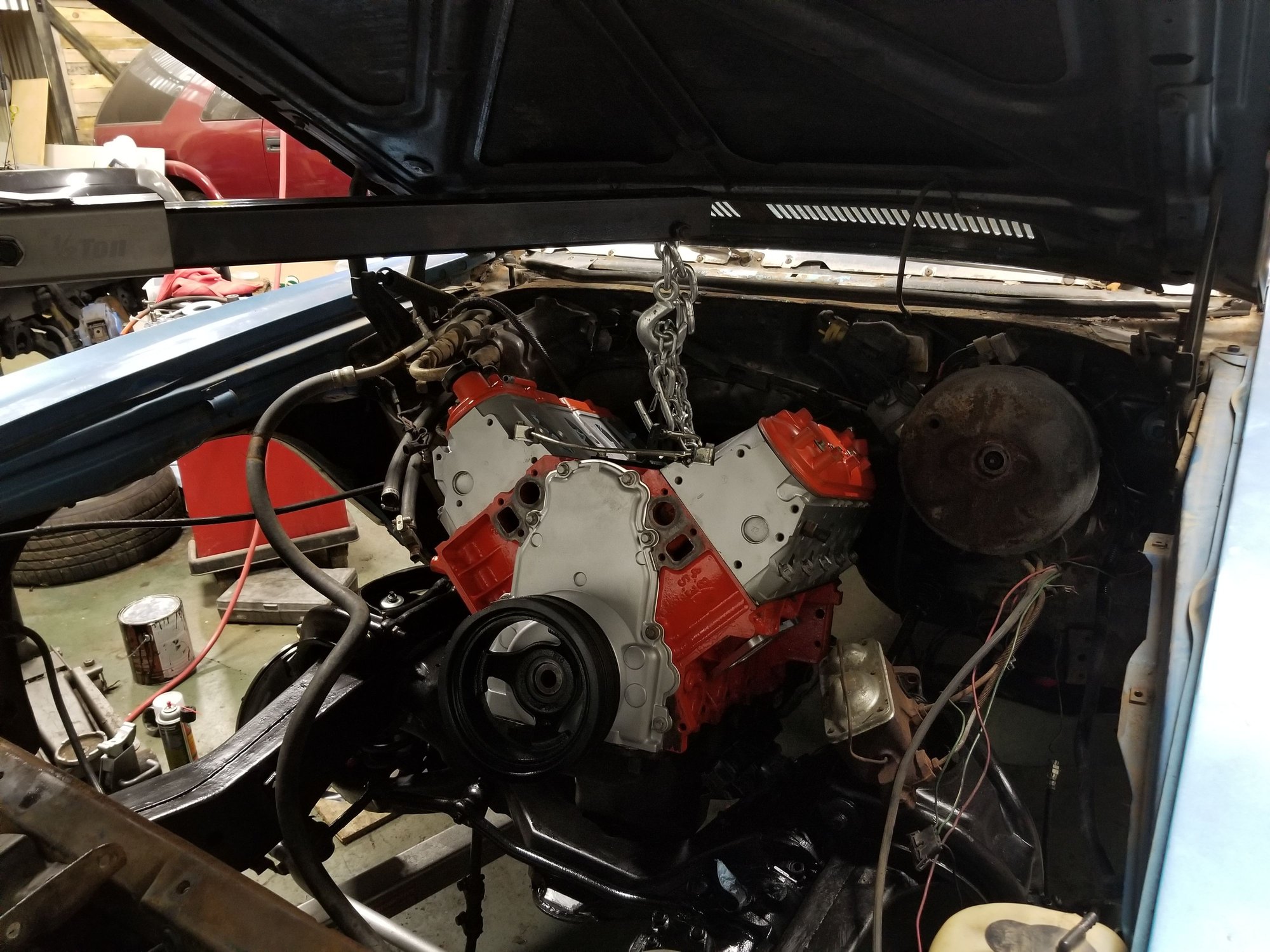

Test fit last night. Soooooo much room!
Empty but not for long....
