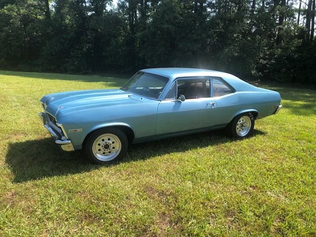

We will be posting the full process of our project car (Project Blue *****). Plan for the car : upgrade to a Blown TSP 58X engine with an LSA blower and custom cam and heads. Upgrades to the rest of the car include brake upgrades, suspension upgrades, fuel system and an upgraded TH400 transmission with a new torque converter and transbrake.
What was in it from the build 10 years ago:
Engine was a stock 24X LS2 from a 2006 Trailblazer SS.
LS6 intake manifold
Drive by cable throttle body
TSP Magic Stick 2 camshaft were added
Transmission was a TH350 rebuilt with a 3200-rpm torque converter.

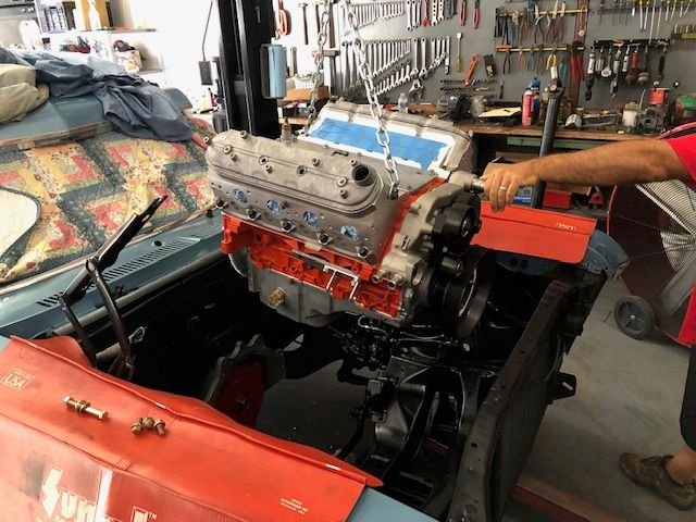

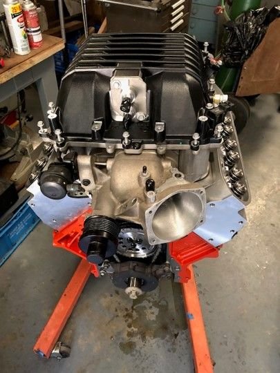

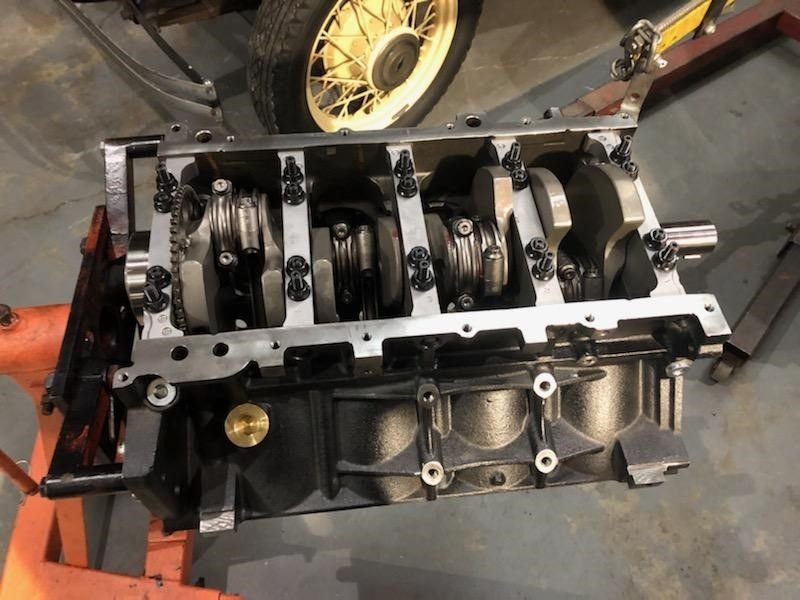

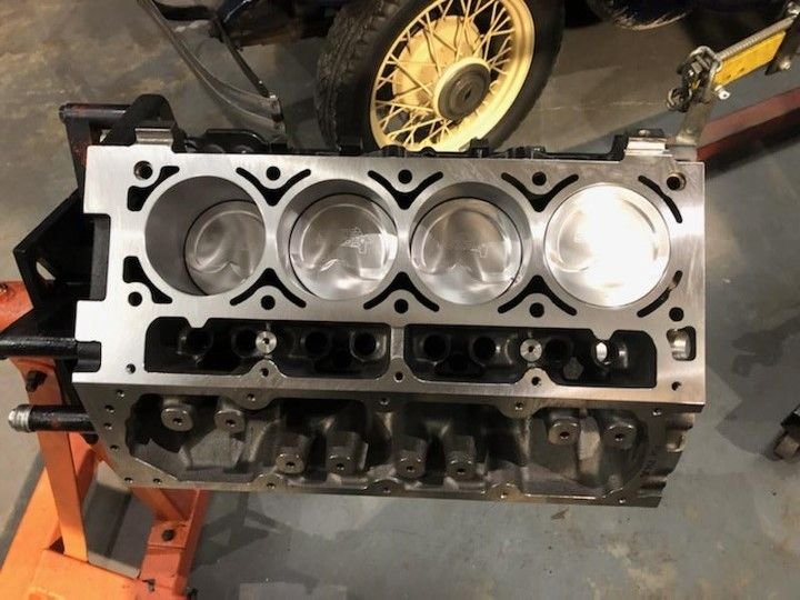

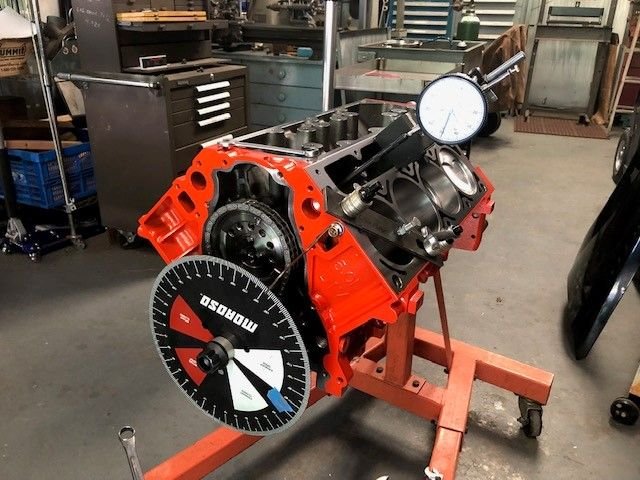

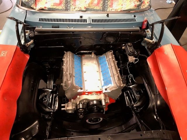

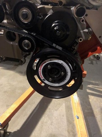

The new heart for Blue *****, thanks to Texas speed, forged 370”. Short block assembled with XTREME CFM Cylinder heads and ported LSA blower. 10” party pulley! Getting the engine compartment ready for install.

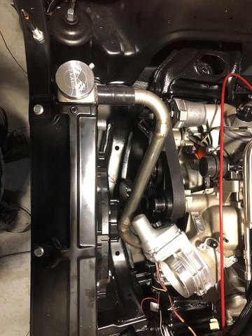

" 10" party Pulley " LOL
Is that thing going to clear your front sway bar, or have you removed it?
Ken
Old Oct 17, 2019 | 07:15 AM
psiconversion's Avatar
LS1Tech Sponsor
Joined: Feb 2007
Posts: 1,310
Likes: 11
From: Brick, NJ
Ken
Sway bar was removed

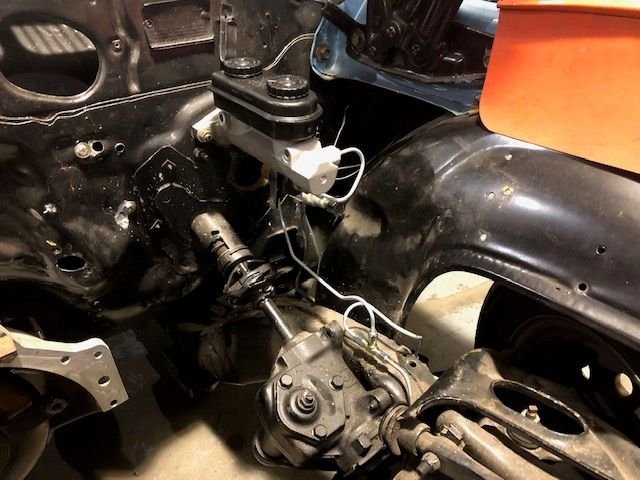

Out with the old and in with the new master cylinder and proportioning valve. This should make stopping much better for Project Blue *****.

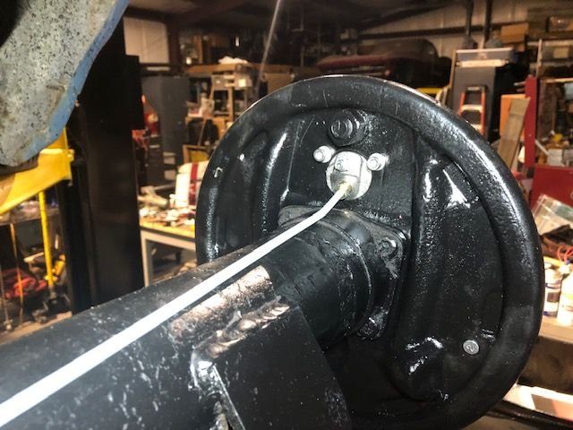

Posts: 1,310
Likes: 11
From: Brick, NJ

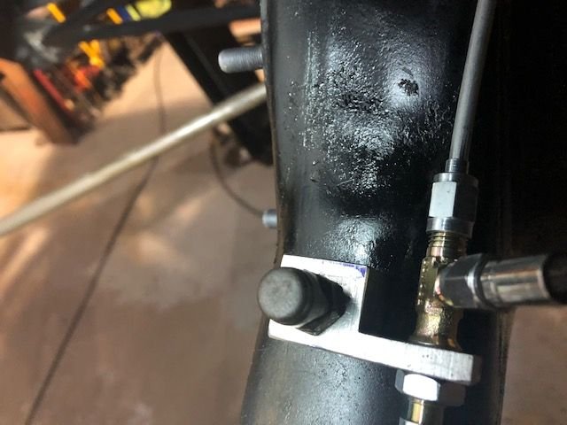

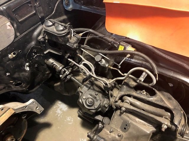

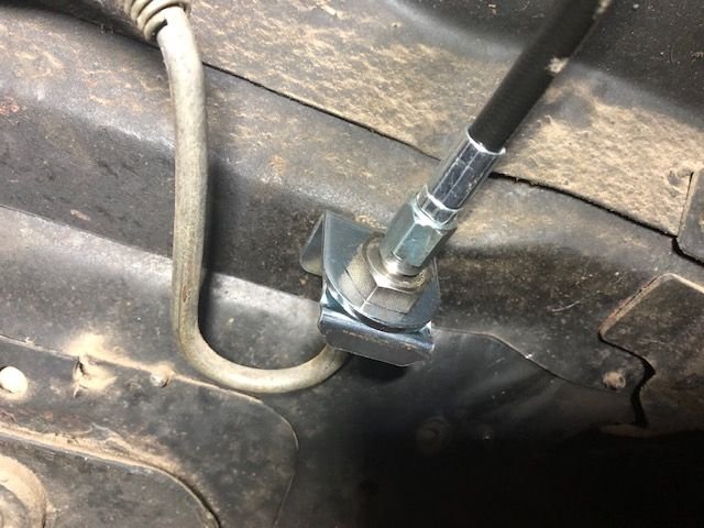

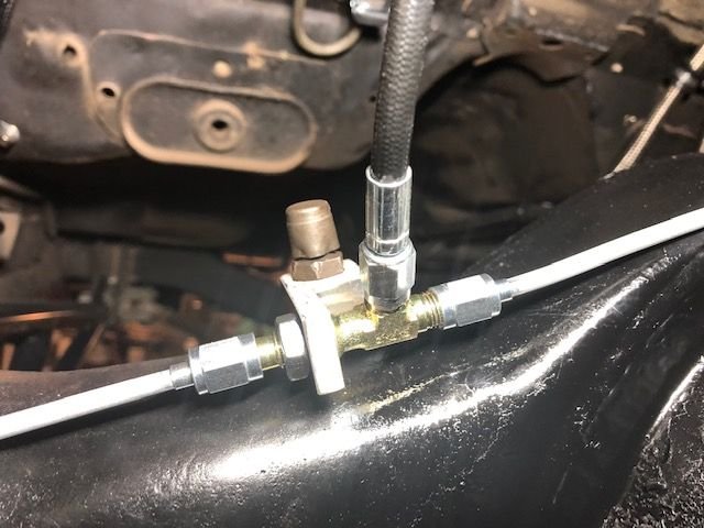

Updated brake lines.

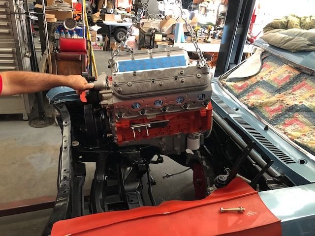

Project Blue ***** got a new heart!!
PSI supplied dirty dingo mounts

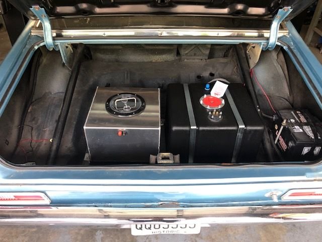

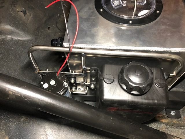

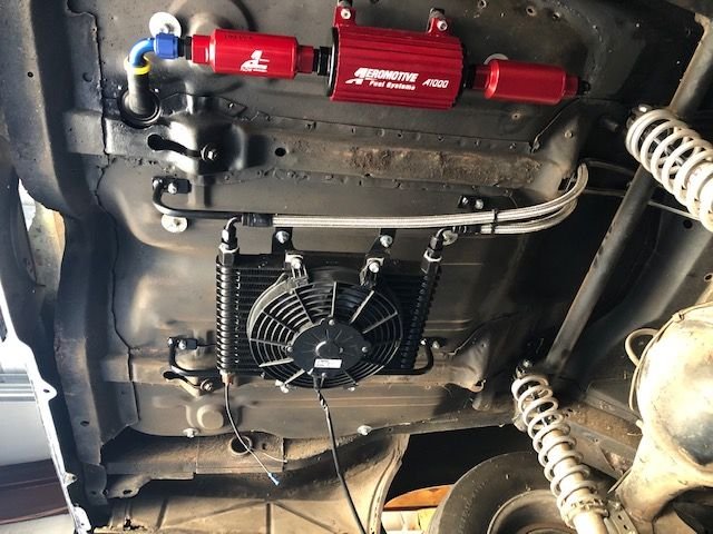

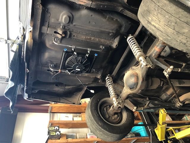

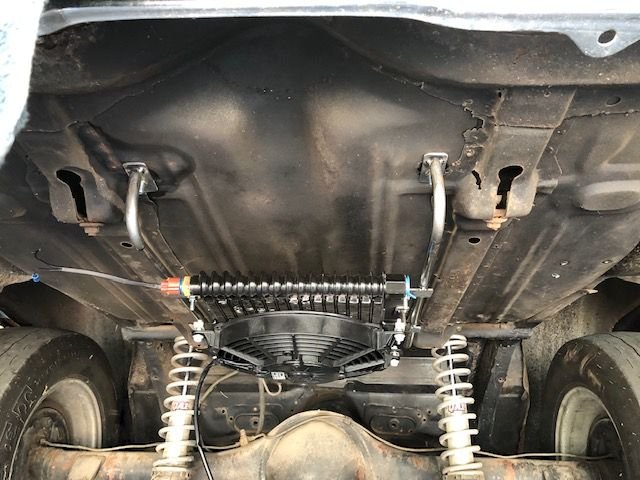

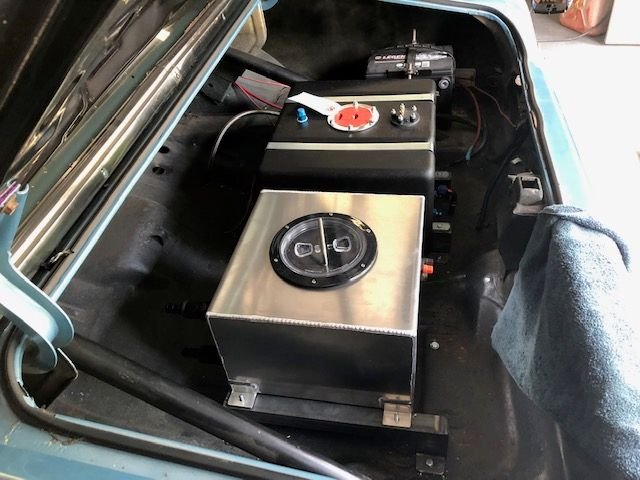

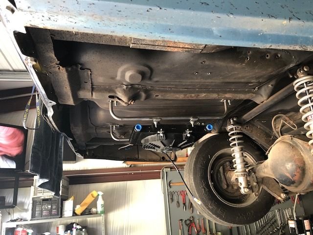

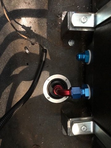

Up next, gotta feed the beast. Aeromotive fuel system components include pre and post filters and an A1000 pump.
New fuel cell and ice tank for the intercooler.
New methanol tank.
Mounted the transmission cooler with a separate fan to keep the temps down. Custom mounts secure it under the trunk.

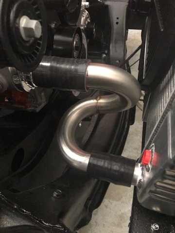

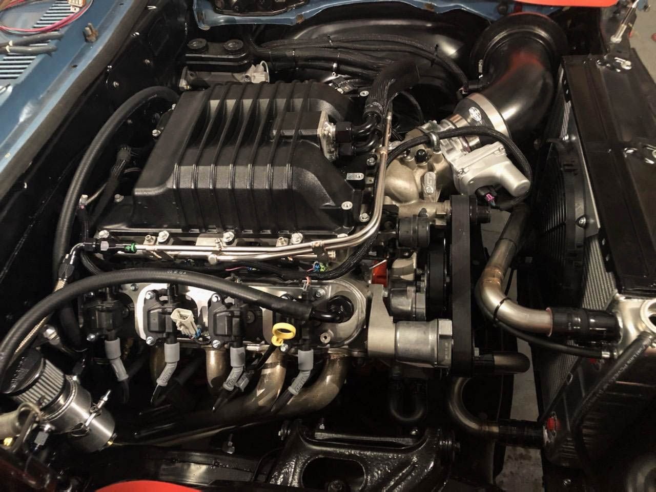

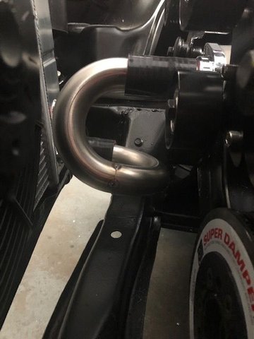

Update:

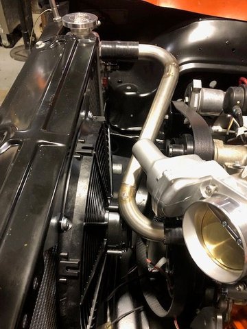

Cutom hard piped radiator hoses tached together. Lvoe the 'sleeve clamps' for securing the lines to the PSI supplied Dewitts radiator.

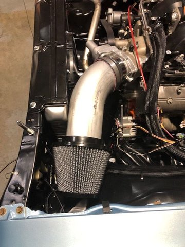

Custom air intake tube.

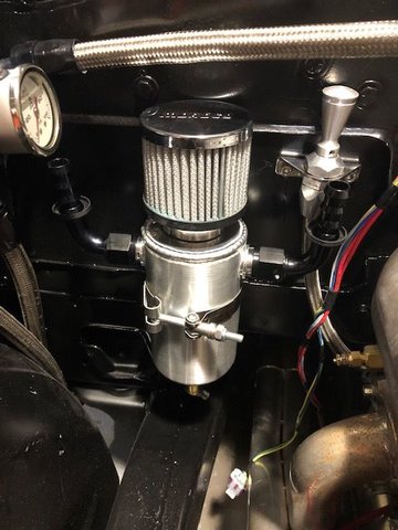

Catch can to keep the engine compartment clean after all that boost.

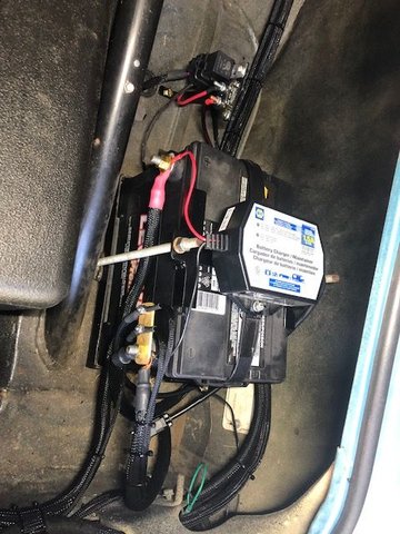

Hardwired battery tender for when the car is not in use.

Old Nov 1, 2019 | 03:22 PM
Motown 454's Avatar
iTrader: (15)
Joined: Mar 2007
Posts: 686
Likes: 17
From: S.E. Ma.
What degree of angle is that Air intake tube off the TB? The project is looking great!

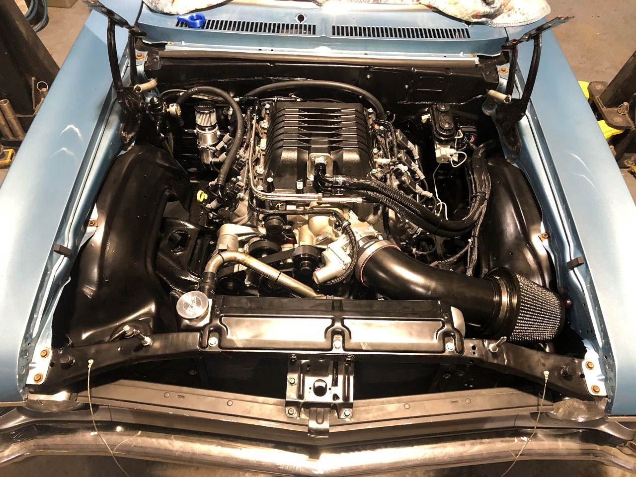

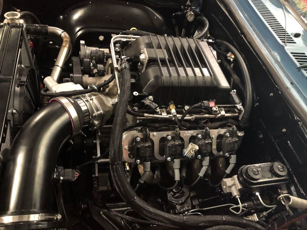

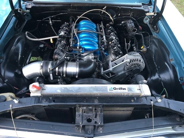

Project Blue ***** is all wired up!

Old Nov 7, 2019 | 10:21 AM
Posts: 22,301
Likes: 3,625
You're going to have high intake air temps where that air filter is. I would find a way to duct cold air to it
Old Nov 8, 2019 | 07:32 AM
LS1Tech Sponsor
Joined: Feb 2007
Posts: 1,310
Likes: 11
From: Brick, NJ
Good catch, but we aren’t too worried about the IATs at this time because the meth injection coupled with the intercooler should to handle any possible high IAT issues.

Old Nov 8, 2019 | 10:07 AM
Posts: 22,301
Likes: 3,625
You have all that, but why handicap it with excessively high IAT's to be compensated for? The lower the IAT, the better even with meth and intercooler.
