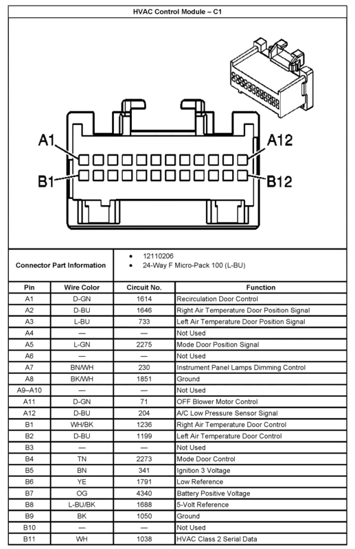

Well I purchased a HVAC Module from a 2005 Chevy Avlanche and did some probing on it. Using the dash harness I got from my donor vehicle i put 12 volts to the orange wire, pin B7, tied the Black & Black/White Grounds, Pin B9 & A8 respectively and I see 2 Volts on the White Serial Data line Pin B11. If i were to wire this up in the truck do you think this would be sending the correct request to the PCM to let it know the A/C is on? By the way neither the A/C butoon light or any other lights came on the Module. I'm going to try to attach the Wiring pin out for the Module.
