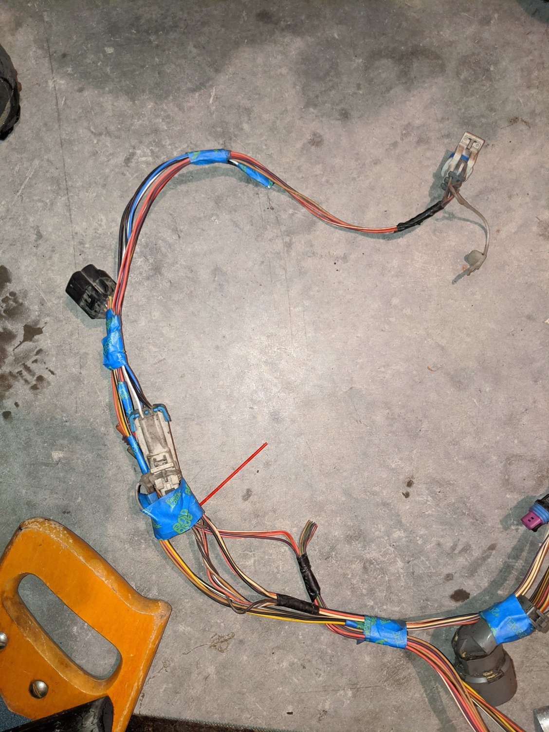

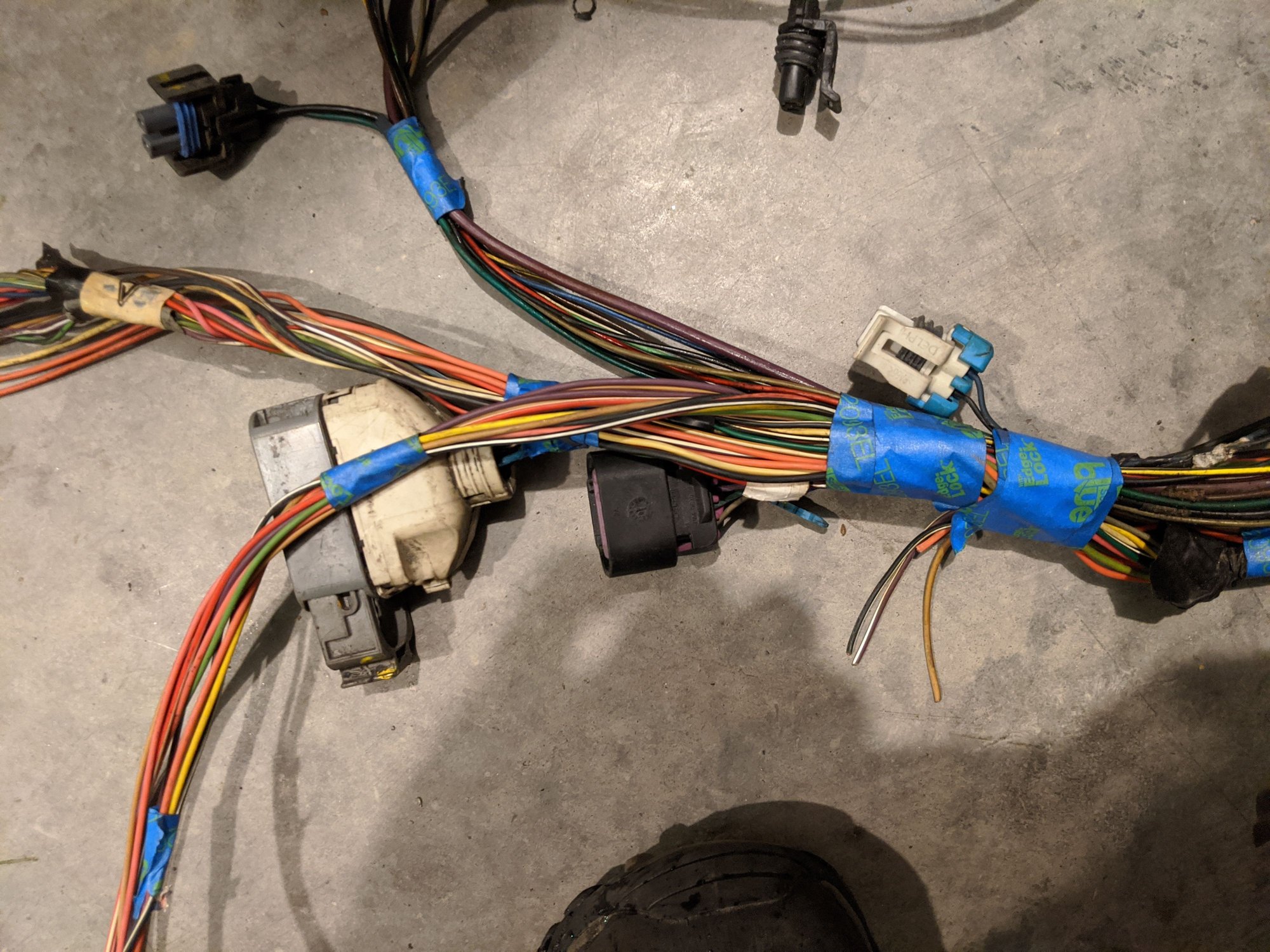

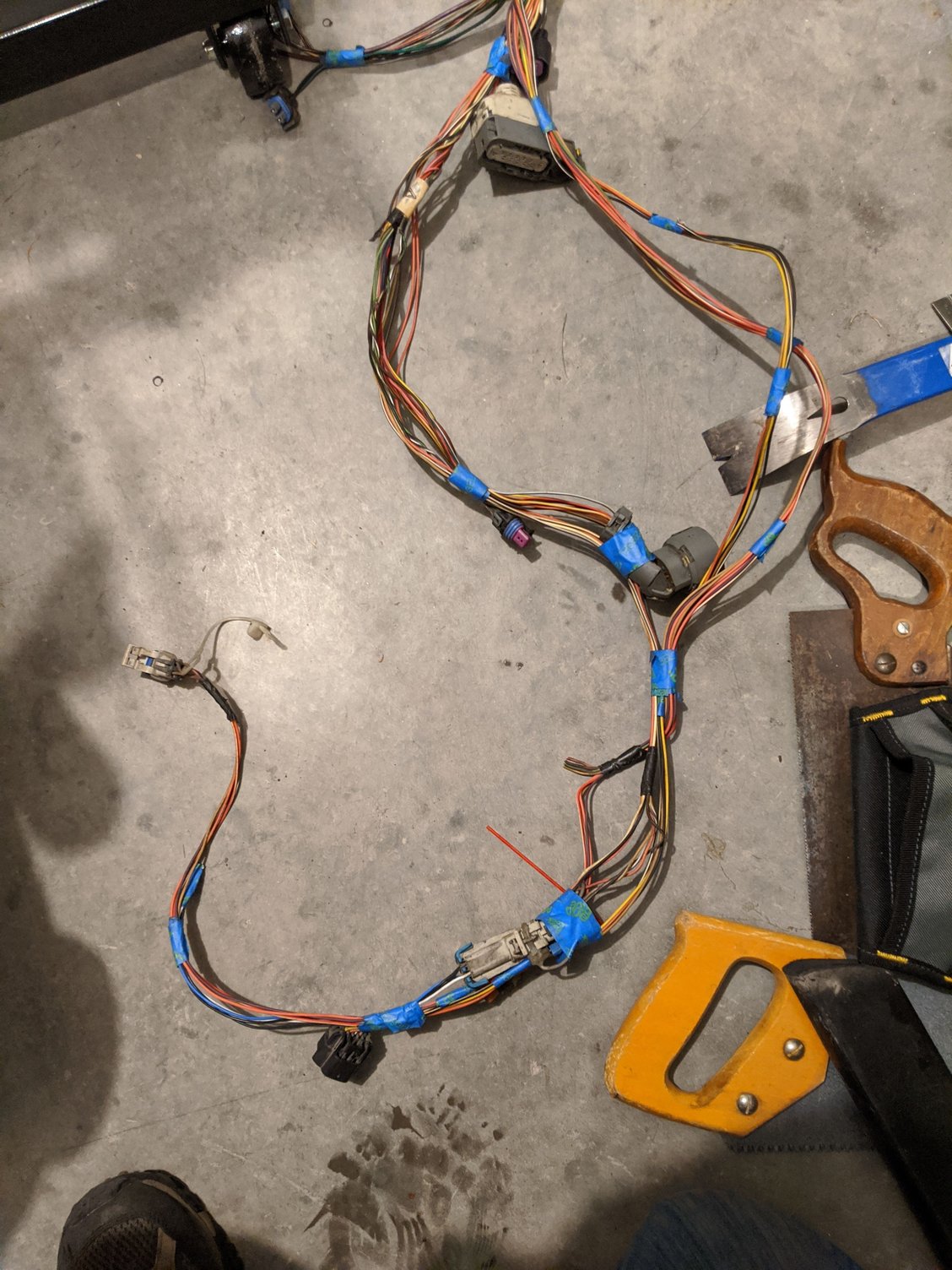

I pulled the wiring harness from a 2005 Suburban, 4WD, L59. There are two missing connectors that I did notice until I removed it from the vehicle. Any chance someone can point tell me which connectors are missing or point me towards the appropriate diagram? I would like to go back to the yard in the morning and source replacement connectors. I would venture a guess that they for O2 sensors or for the transmission.

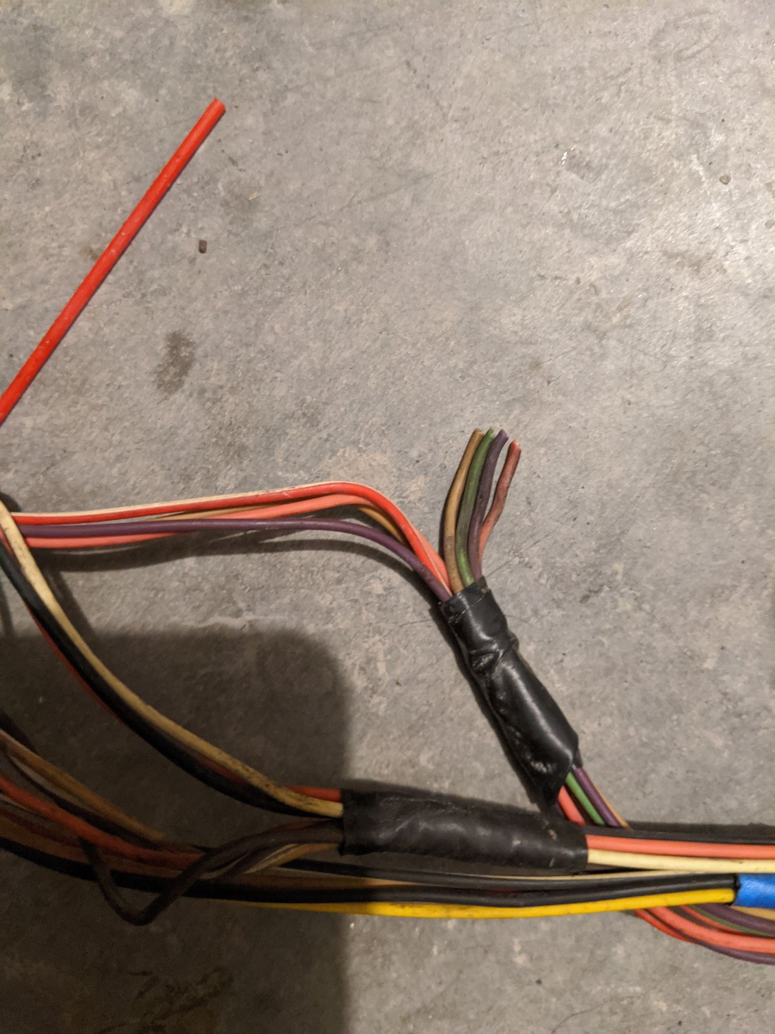

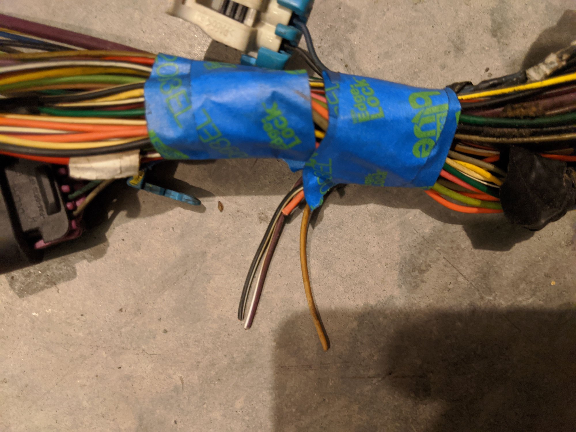

I am pretty confident the one with purple, tan, light green, and pink wires is the bank 2, upstream sensor. Still struggling to figure out the other.

Both bank upstream sensors. The junkyard must have cut the wire and took the O2 sensors and the cats at the same time.
