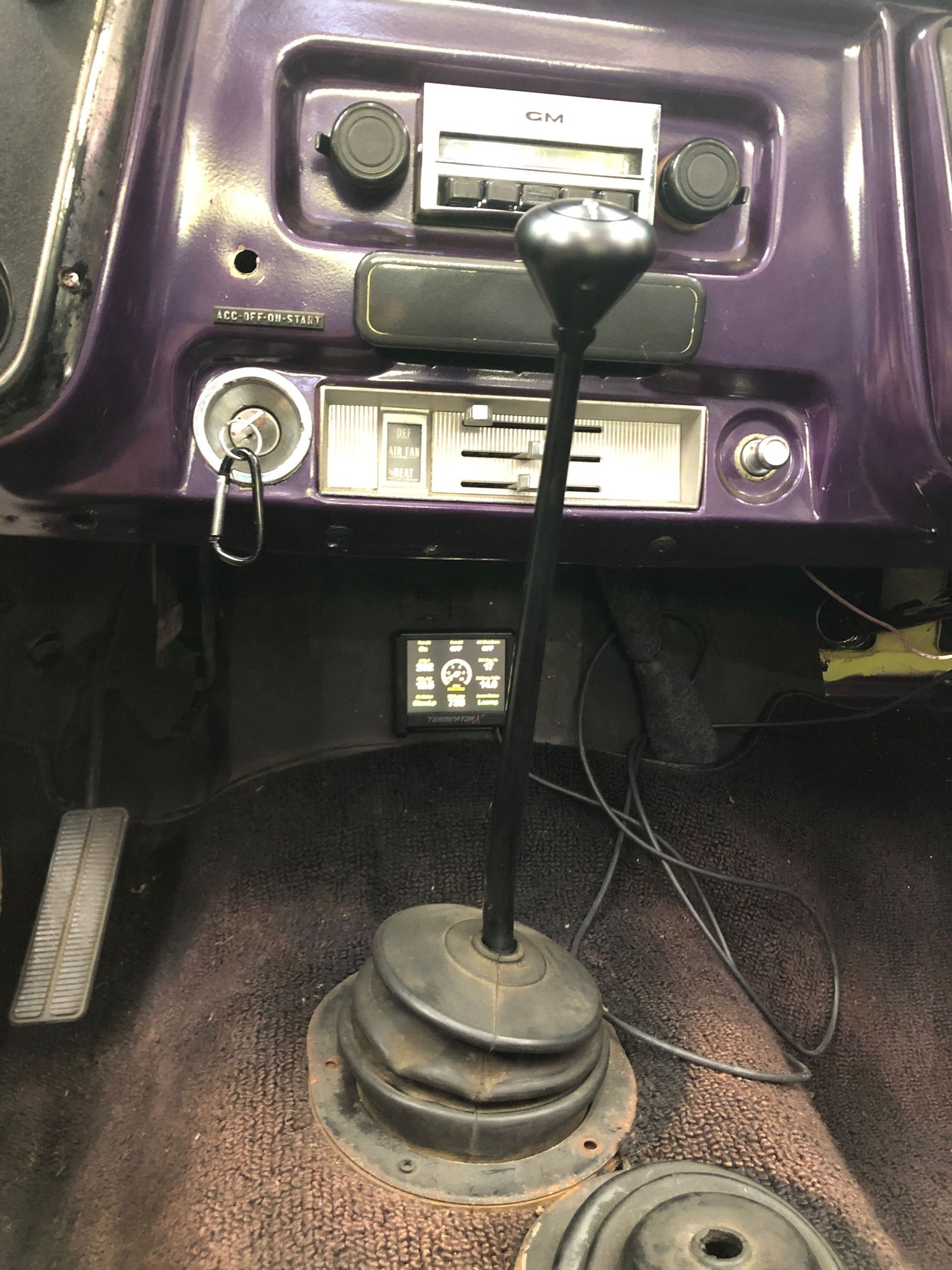

I have a Lokar in my GMC, on my 4L65e. I believe its a 17" stick. Looks just like the factory stick, except it has the PRNDL button on top.
