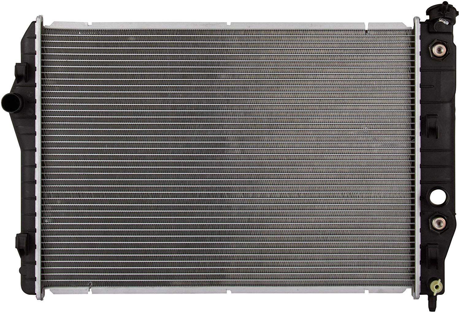

OK, after much ado I've settled on a Spectra CU-1485 (made for the Fbodies). How the bottom mounts is a mystery to me. I see one one rubber donut, but the other side has no provision for a mount. I've seen a picture of just a flat piece of rubber, but I can't figure out how it mounts. I'm curious if I could just use universal style rubber isolators that are the "U" shape?

I used an F body radiator in my 67 Camaro. They use 2 "U" shaped rubber pieces that the aluminum flanges for the tanks sit in. I just modified my existing rad support.
Same here for my Cutlass, works like a charm.

On the passenger side, the side with the pin that goes through the support, does the rubber piece just sit on top of the hole for the pin, or do you have to push it in so it pops halfway out the other side, like a rubber grommet would? I'm curious what size to drill the hole for the pin.
Thanks,
I'm not using the rubber piece for the pin, just sits in the 3/4" hole I made in the core support. The rad is secure in the rubber pads so I don't worry about the pin.
