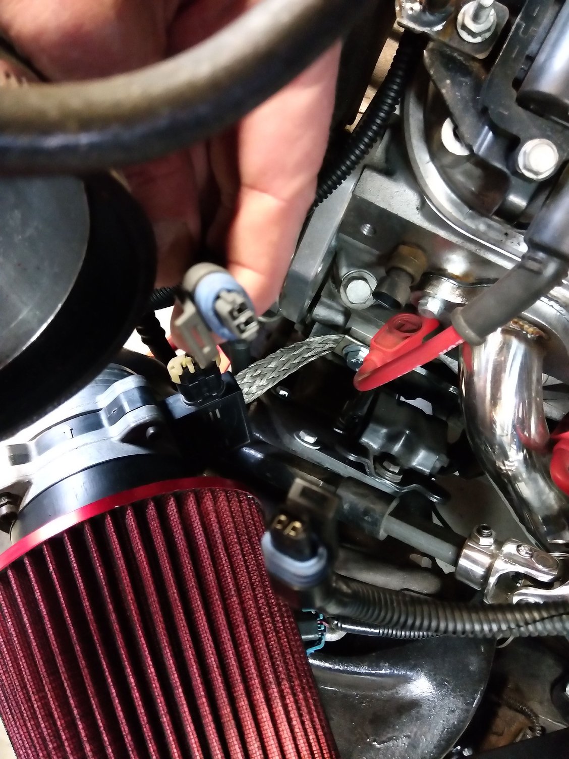

My truck is undergoing a new ls1 swap from a2001 trans am and I have one extra connection on the front of motor. It's not coolant temp, that is already attached .I'm stumped since this is new to me, any help would be much appreciated

Do you have your IAT sensor hooked up?

I have the coolant temp on the head hooked up. It's the lower plug in the pic

IAT is coolant temp in the driver side head right?

IAT is "Intake Air Temperature". In the air intake tube.

IAT=Idle air temperature sensor which is connected to the air box or part of the MAF.
Oh great, I don't have an airbox. I wonder if need it, I don't have much room upfront now.
you can put it in your intake tube between your filter and maf.

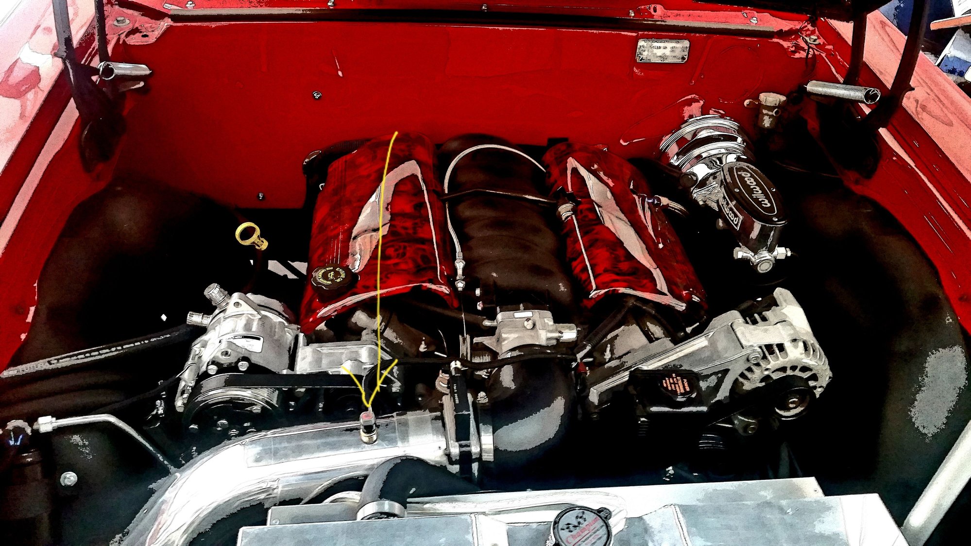

here's mine.
