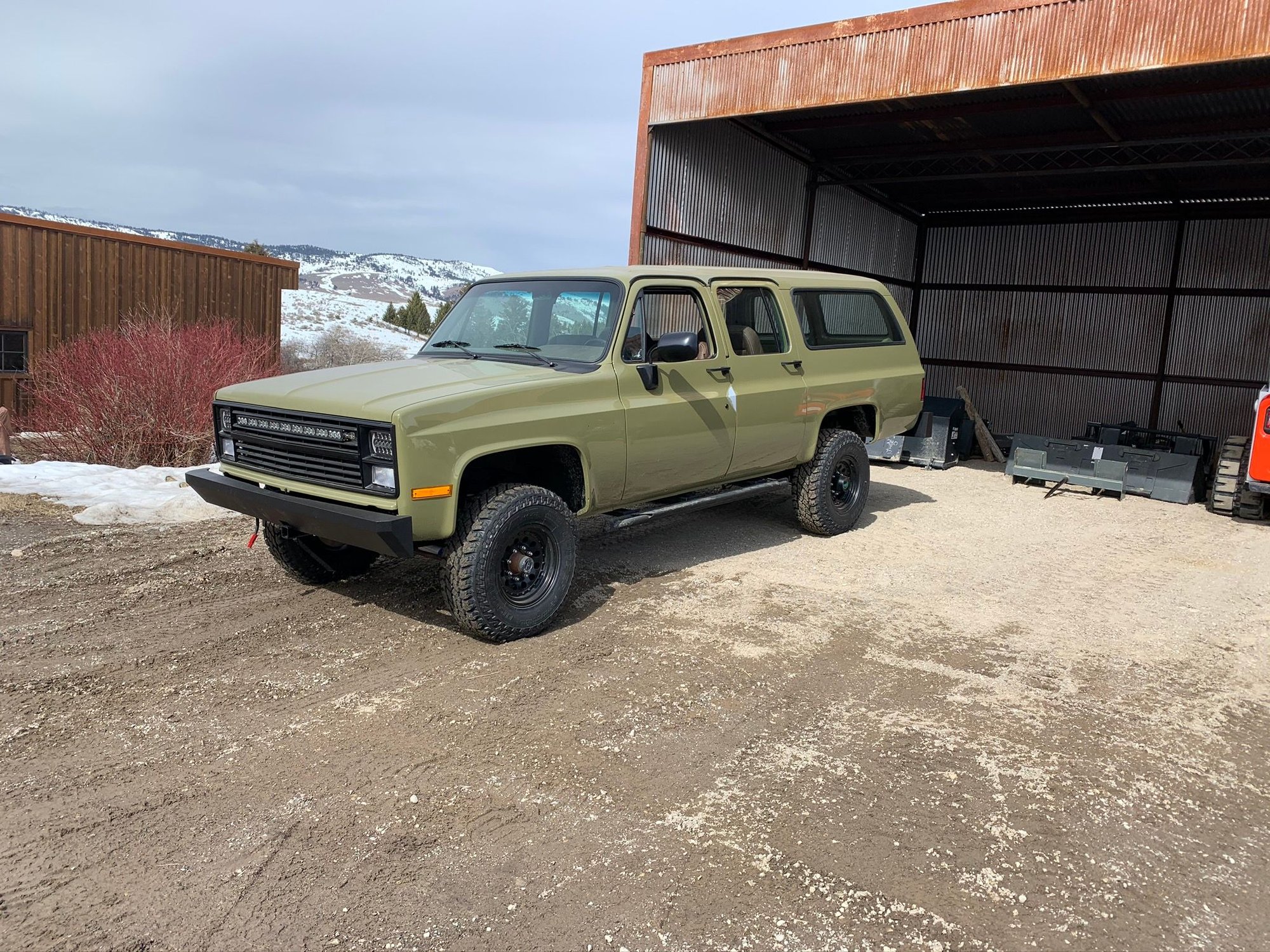

So I have hit a stand-still in my Gen V LT swap into my 1984 Suburban. Was going to go a conventional LS swap but got a smoking deal on the drivetrain from a 2016 Silverado so figured what the heck I'd go that way. I'm a fabricator and body guy, not an engine guru so I'm kinda just BS'ing my way through this swap.
Engine is a 5.3L L83 mated to a 6L80E.
PSI Conversion Harness (got this before I realized I wanted to use a Lokar ESS shifter w/ tap shifting)
Speartech tap shift switch box
Speartech reverse light CAN box
Speartech ECM
Speartech tuned TCM
Lokar ESS shifter
Aeromotive Phantom In-Tank fuel pump kit w/ aeromotive EFI regulator set at 72psi
Engine has brand new injectors, fuel rails, and plugs.
It is running like **** and the only code that my snap-on scan tool is picking is a P135A - Ignition Coil Supply Voltage Circuit Bank 1. My first thought is to just get new coil packs, but since I'm not getting a coil specific code I have no clue how to test and see if it's just one coil pack. I'd rather not dump $250 into new coil packs and wires if it's some simple computer issue.
