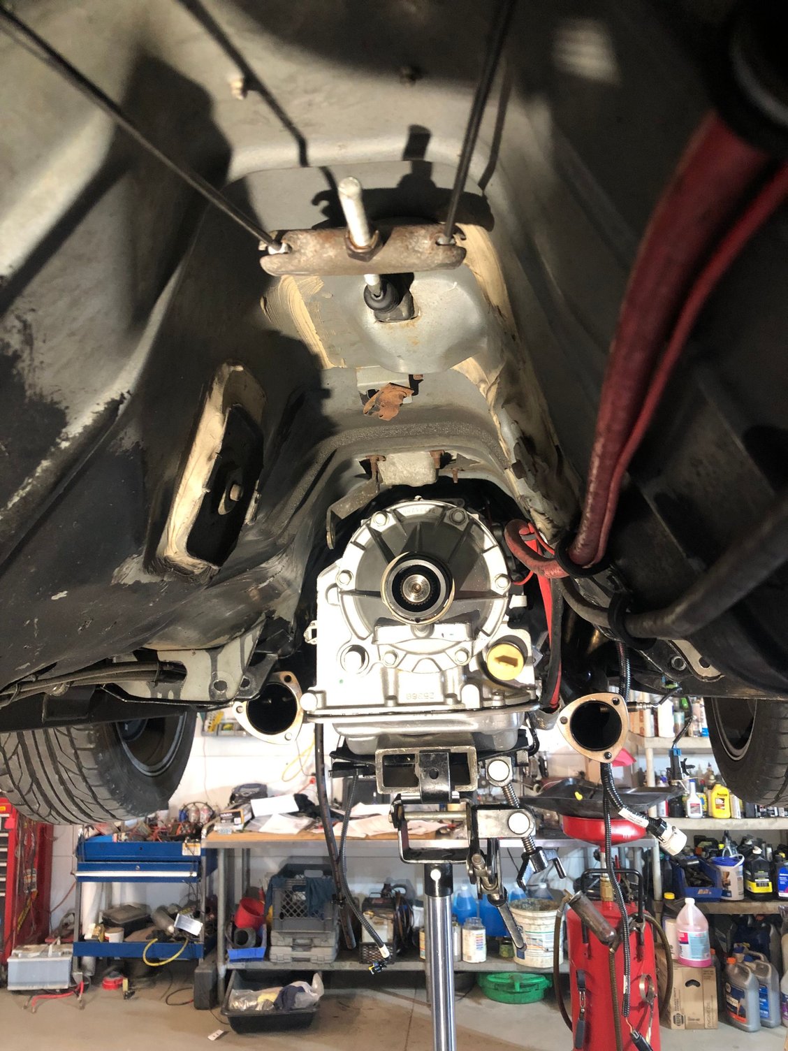

I have an 89 coupe with an ls3/6l80.Originally was running a 4l60,but upgraded.was able to reuse the AJE crossmember used for the 4l60,I just flipped it over and moved the crossmember all the way forward on the bushings.worked fine..was also using the AJEk-member .engine placement would/could make the difference as it just barely fit.

This is a GMPP 6L80, they build them "with heavy duty internals" so i hope this unit stands up to some mild beatings once in awhile.She does run alittle hot , but I assume this is because of the proximity on the driver side collector barly clearancing the tranny case..I'm having moving and wrapping this pipe soon..
