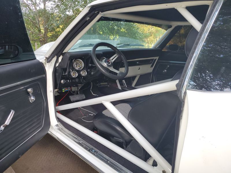

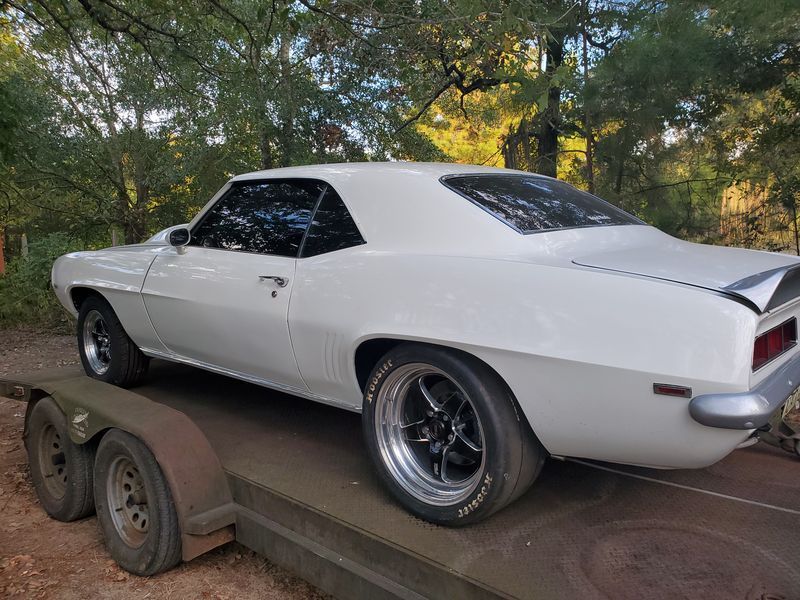

Old Aug 27, 2020 | 04:40 PM
frige's Avatar
Joined: May 2015
Posts: 122
Likes: 14
More pictures.
