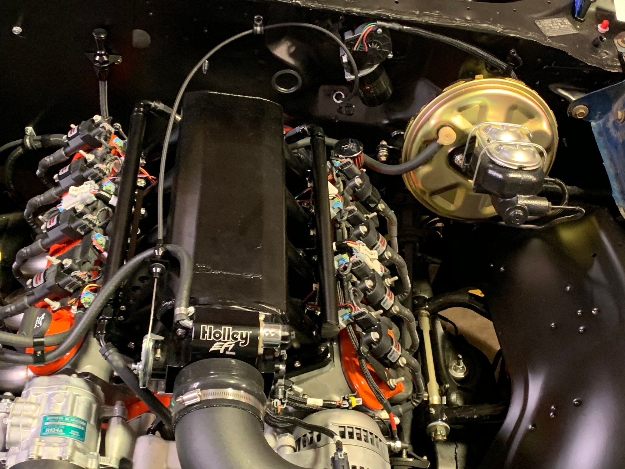

I have a lowdoller sensor https://lowdoller-motorsports.com/co...ressure-sensor mounted on the fuel rail right after a AN adapter. No issues.
LQ9/Terminator X max

Keep it off the engine. The vibrations will kill even the good sensors eventually. I had a Holley sensor and it lasted 3 years on the engine. I bought a less expensive sensor and it literally lasted 2 minutes. I would also be very careful how you mount it on the rail. I nearly burned my GTO to the ground:
Andrew

Way too much weight/leverage hanging off the rails.
I dislike people mounting the FPR directly onto rails for the same reason
