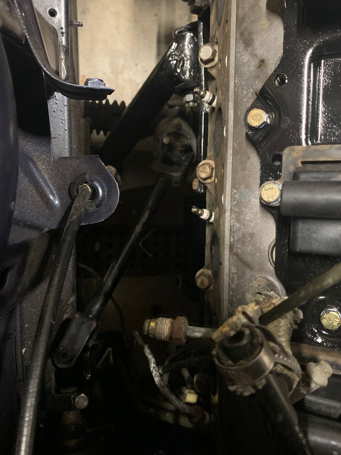

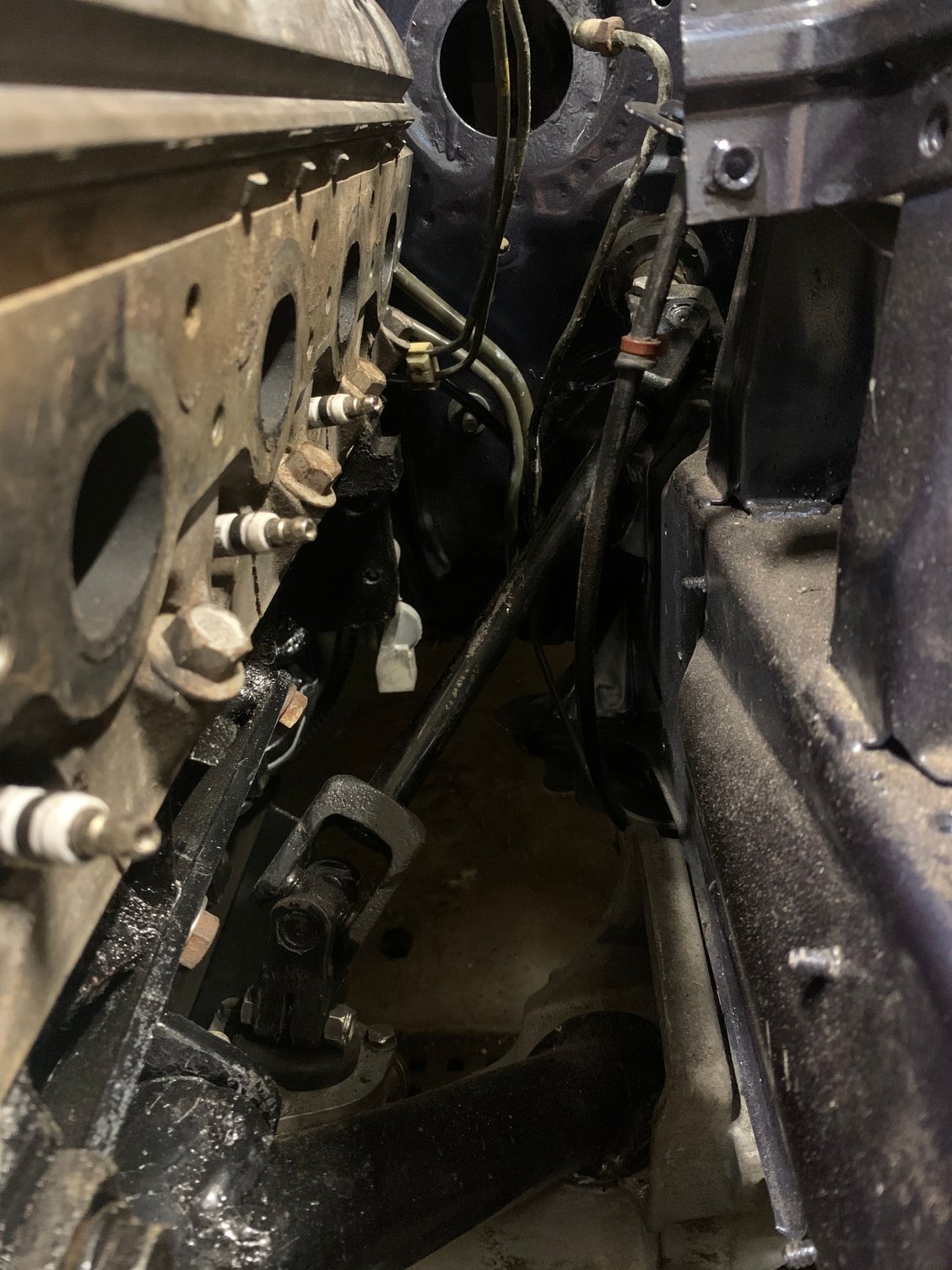

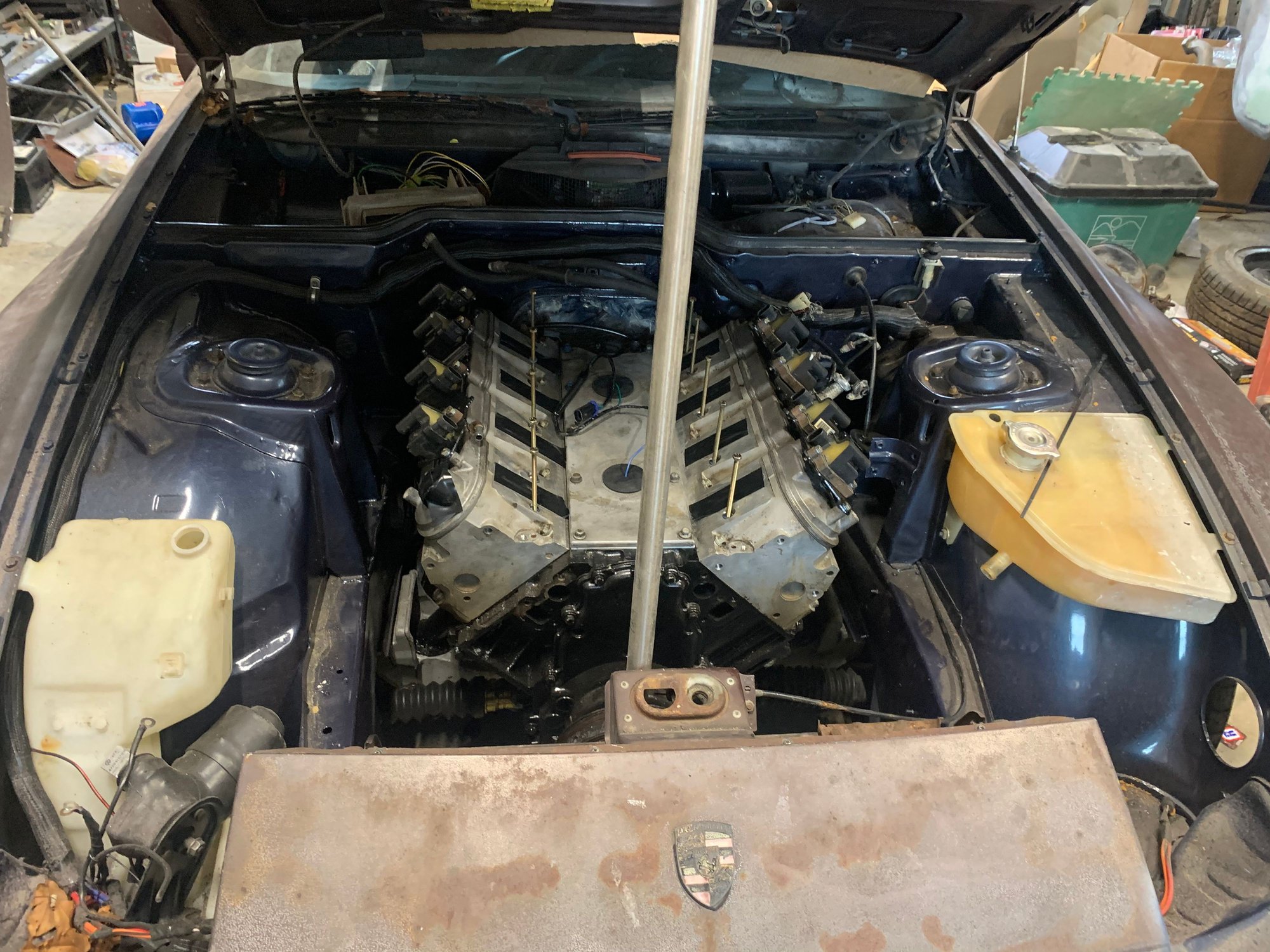

I’m putting an LM7 in a Porsche 944 and I’d like to avoid the $2k price tag for conversion headers and honestly I prefer manifolds anyway. There is very little clearance on the drivers side because of the steering shaft. It looks like some of the aftermarket manifolds may work, but I’ve had a tough time finding dimensions.
These look like they may work.
https://www.holley.com/products/exha...xoCCF0QAvD_BwE
If anyone has some measurements from any of the aftermarket manifolds could you please post them? I’d greatly appreciate any help!
Ive searched, and have only found a few threads that are 5+ years old with little measurement info.
Cars current state.

The Holley manifolds that provide the most steering shaft clearance, by far, are the 71223026HKR manifolds listed under the S10 truck swap application. I don’t know if there is an equivalent set to that offered under the Flowtech brand.

Highly likely that trial and error is gonna be your only course for manifold fitment...
