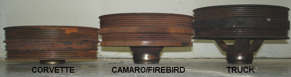

F body uses a different compressor and everything is moved back further than on a truck engine. It's not a lot, but just enough that it won't line up. Here is a pic i got off the internet that shows the differences.

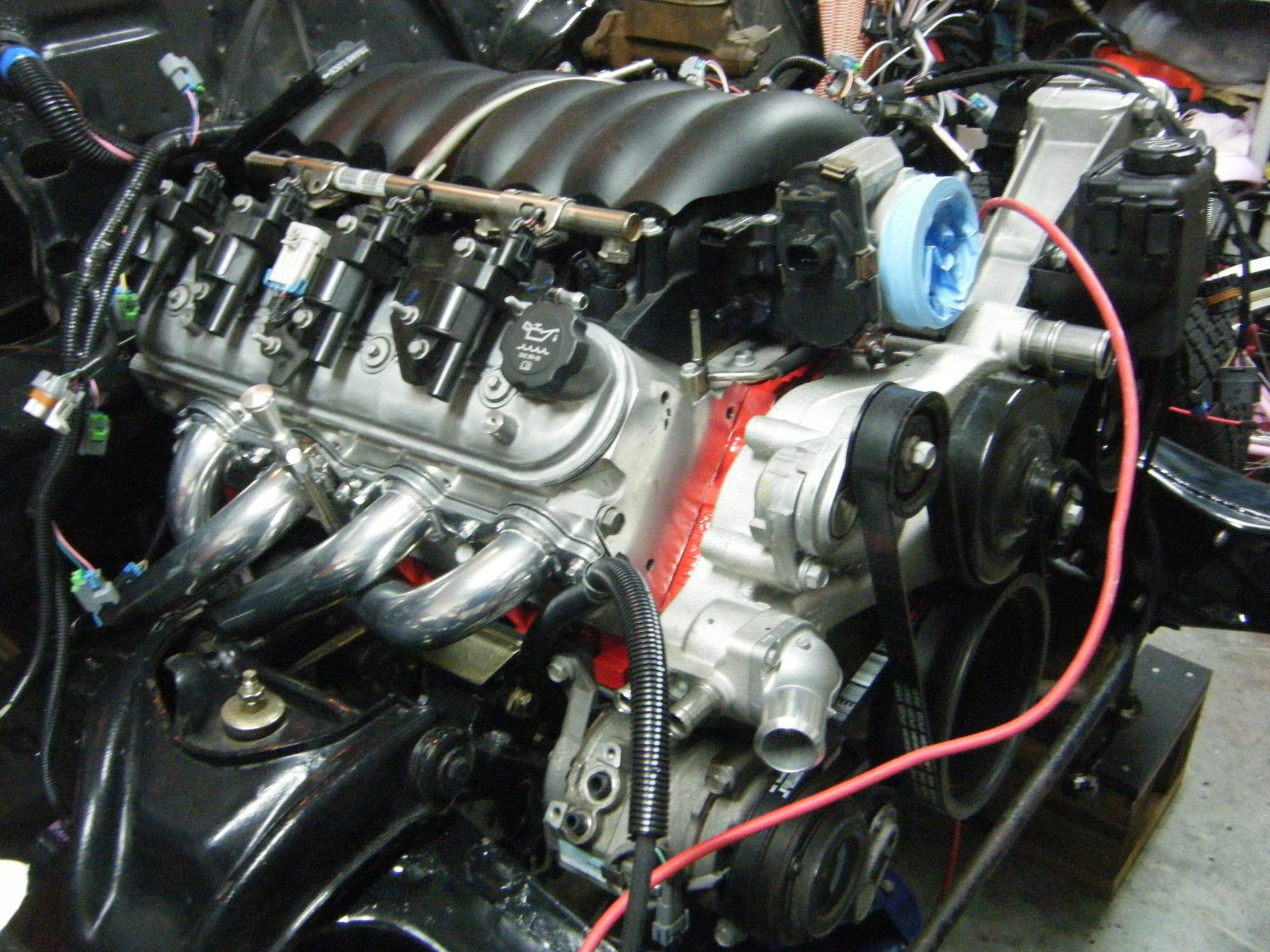

This is the 2010 Camaro waterpump, truck spacing. the PS Pump/Alt bracket is from a corvette spaced off the head 1.5 inches.
