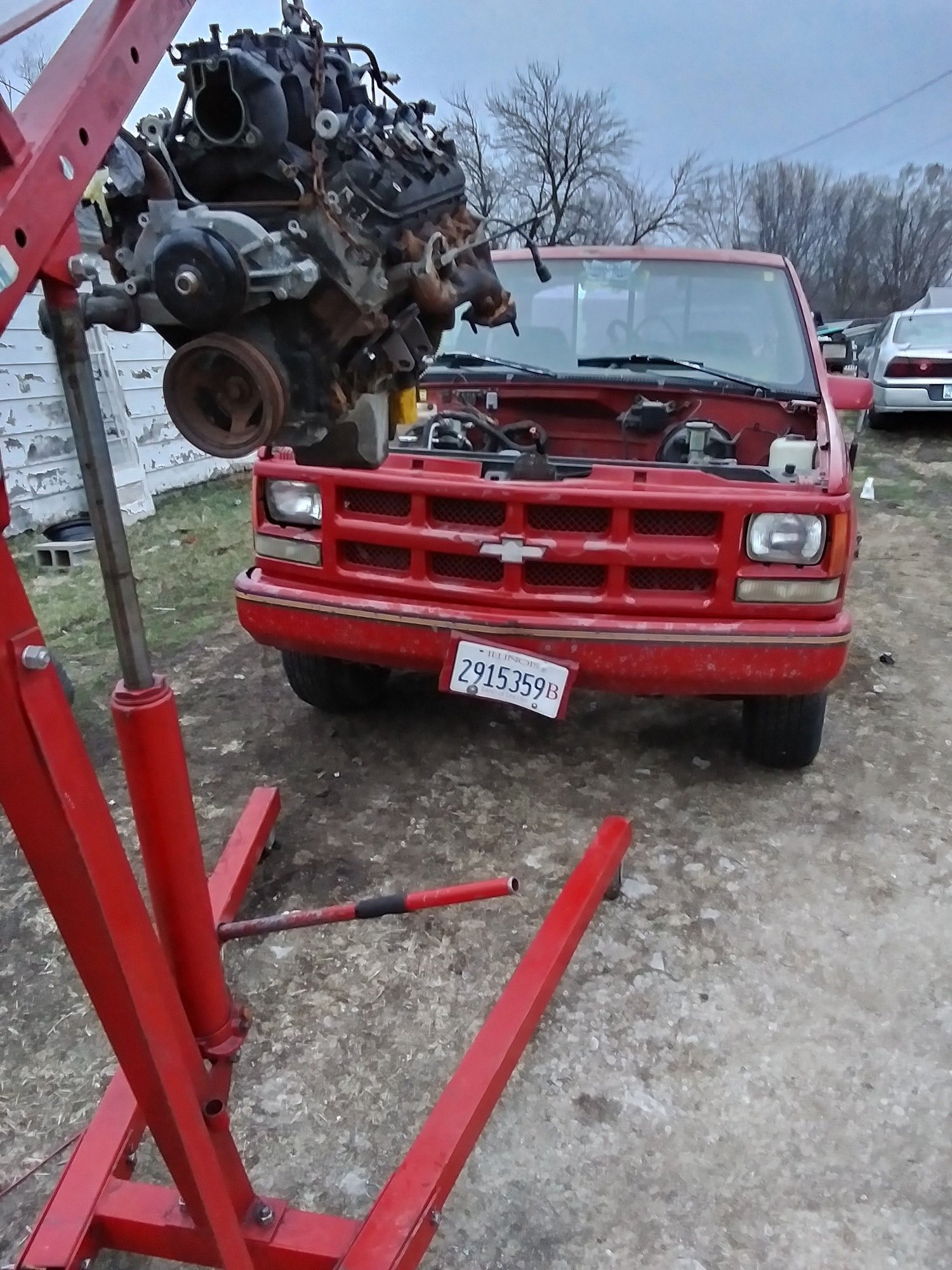

Hello all just going to share my project needing some help with it, going to be doing some mods would like some help. I've been looking intently at schaffer shifters because the wiring harness i picked up from the junk yard doesn't work with my Transmisson. 6.0 liter LQ4 317 heads and its from a chevy express, plan on saving money by NOT buying a newer trans and just shifting the trans myself because the harness I have will only seem to work with a 4l80e and I'm inclined to think I can run the vehicle without transmission controller from factory cause it won't work with a 4l60e, especially a 1993 4l60e! Share your thoughts any thing please I'm looking to see if this works cause I've seen people do standalone wiring junkyard harness on there is engines and had no problem it seems for just a standalone for the engine! Also I plan on drag racing this vehicle thought for sure a schaffer shifter would help with more tunable shifts for better or worse.

Here's my goal. To create something like this. But pin outs I heard vary from transmission to transmission. 1993 seems like people say it's different. https://m.roadkillcustoms.com/how-to...anual-shifter/
