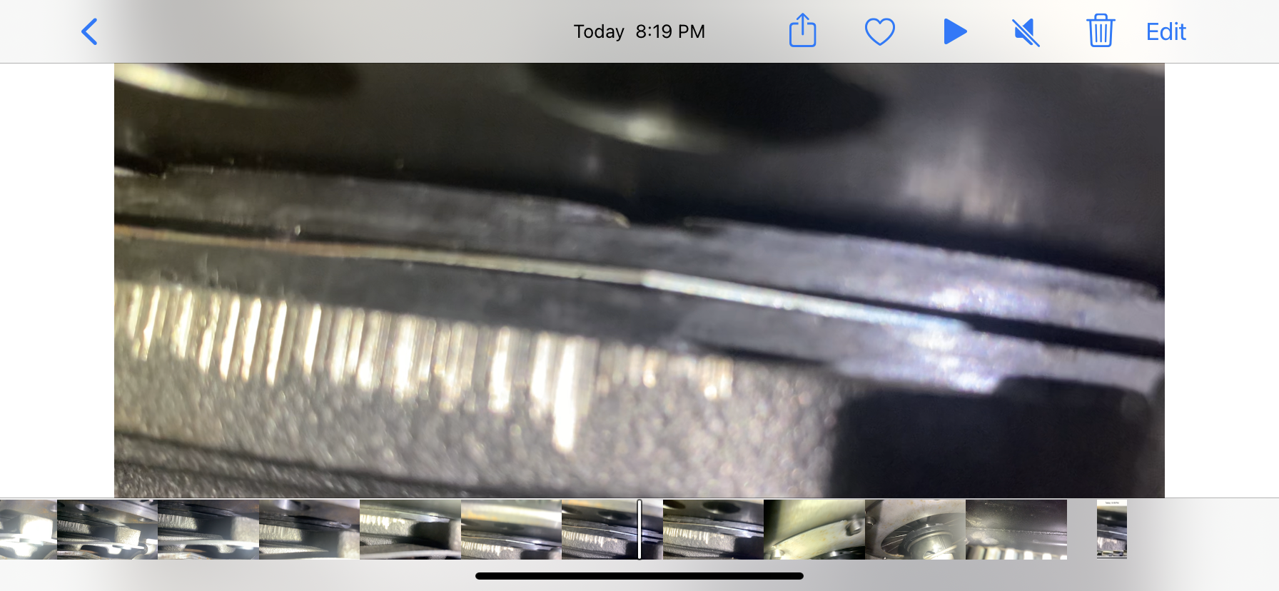

This is a screen shot from the video. It’s clearly away from the flywheel, but looks a to be dragging on the PP still.

Pilot bearing/bushing seized?

Kinda sorta. Pulled the PP off today, figured out the clutch disc is hitting the pilot bearing. I am very relieved to figure out the problem. I think I will pull the adapter and have some meat shaved off the back of it and adjust the driveshaft to work with it.
