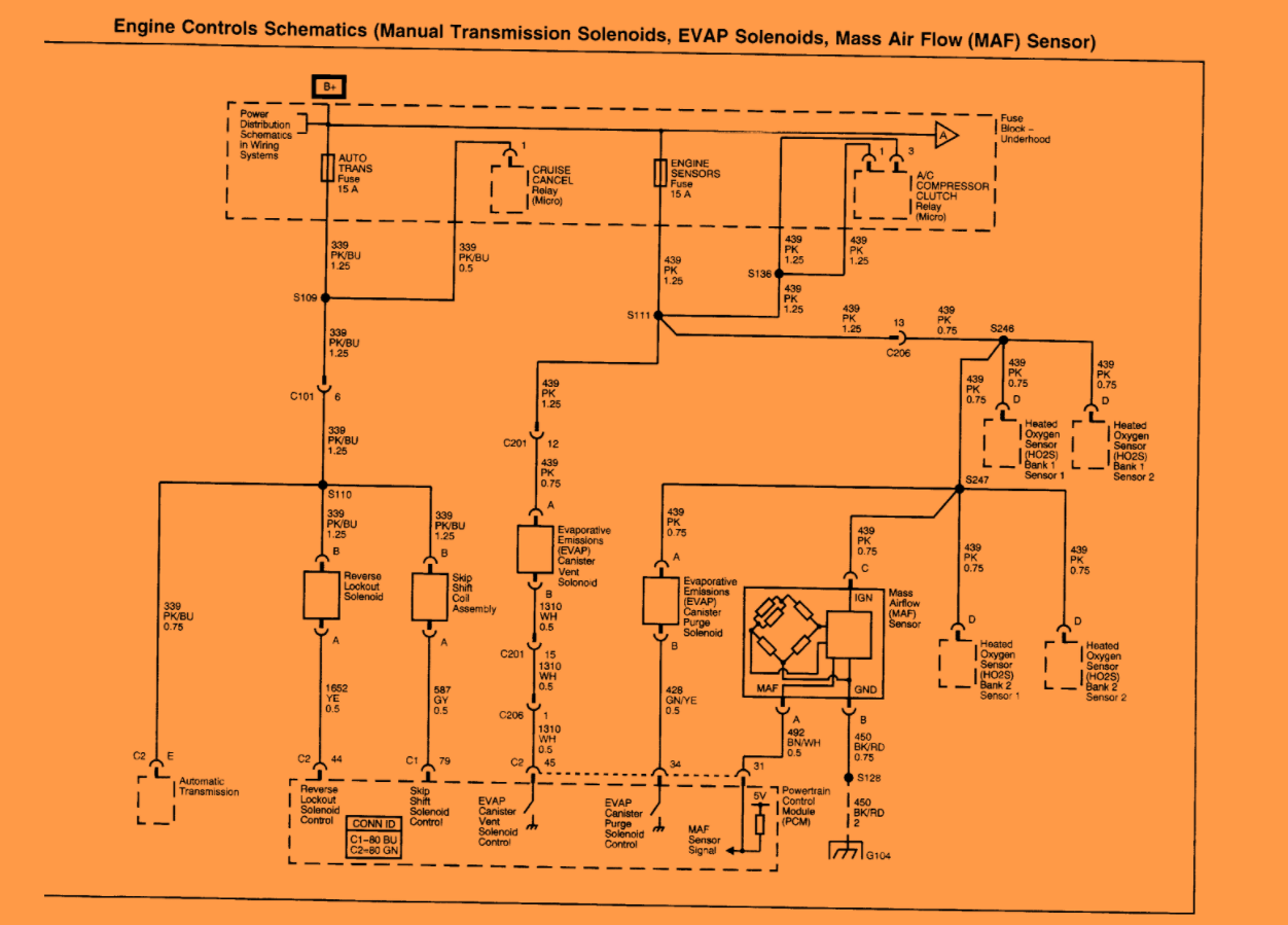

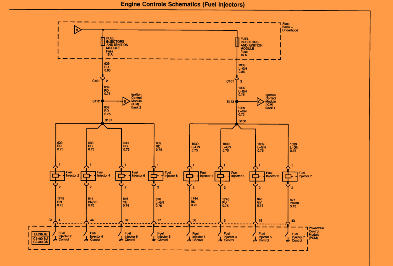

You mentioned the one wire going to the PCM. How are all your sensors, coils, and injectors getting power? They should all be on a switched ignition source as well. Sounds like they have constant power.
Old Apr 12, 2021 | 01:44 PM
GETREKT's Avatar
Joined: Jan 2016
Posts: 6
Ahh yes, I was waiting for this to be asked. Yes the Engine Sensors/Coils/Injectors are wired to a constant 12V. According to the schematic from AllData is shows they are connected directly to power. Pic attached
The "A" within the triangle goes to B+ which I assumed was battery power.
My question is why would OEM tie directly to battery? Is the PCM waiting for a BCM command to authorize a shutdown?
Old Apr 12, 2021 | 02:25 PM
GETREKT's Avatar
Joined: Jan 2016
Posts: 6
Oh wow, I looked again at the schematic and went up a level and saw that everything is powered through an "EFI Relay". I assumed the other end of the fuse went to battery. Thanks for pointing that out.
