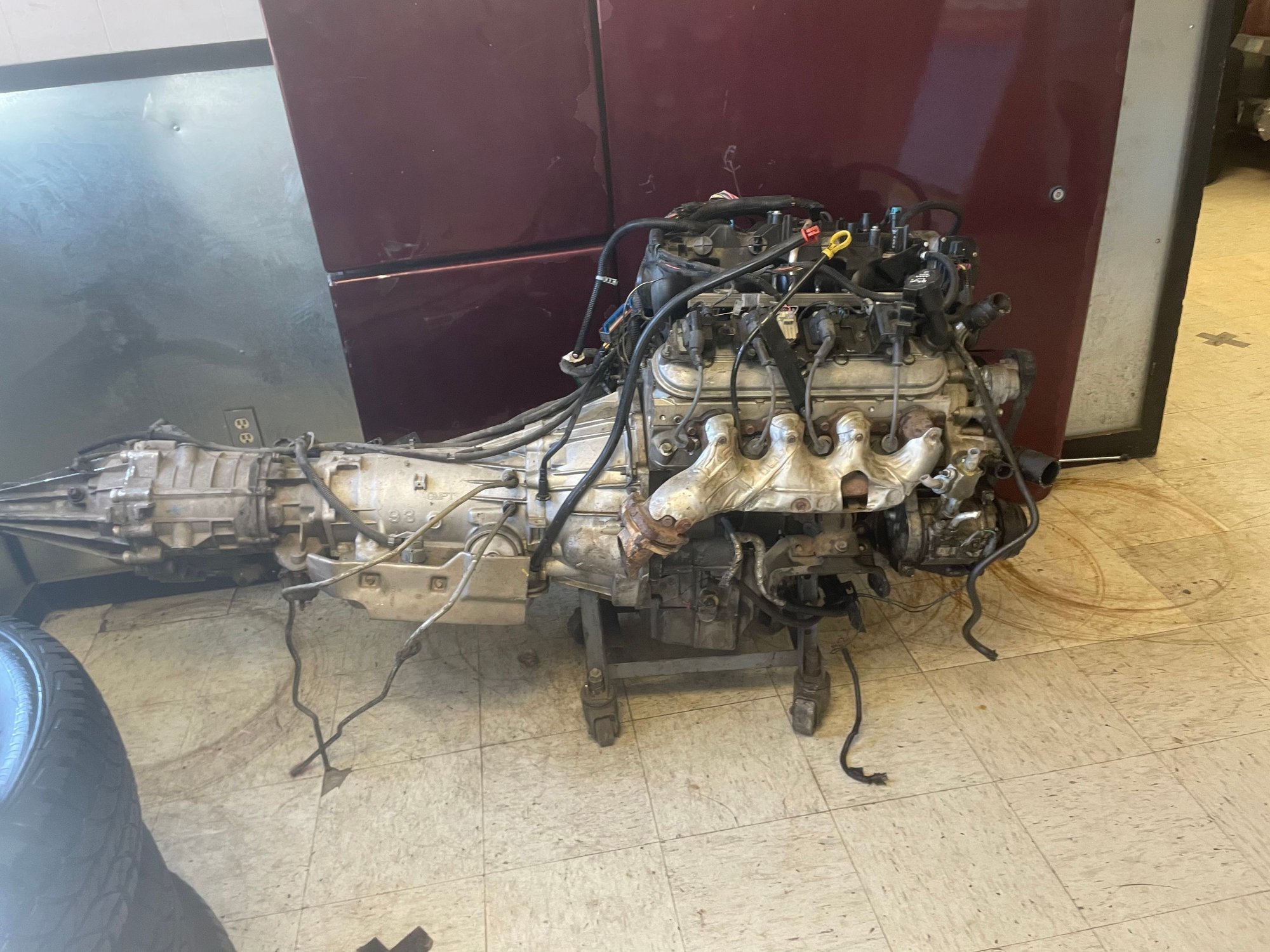

Hey guys,
So I just got my first junkyard LS. Came out of a 2004 z71 suburban (5.3 with 4l60 and getting rid of the transfer case) and is going into a 1968 c20. I have everything except the ECU. The only thing I plan to modify internally is the cam, ls7 lifters, and maybe new springs if y’all recommend that. On top I would like to run a carb set up.
So the real question is do I run an ez tcu with msd ignition controller, or just get a Holley sniper to do it all (to my understanding).
Or am I really just making things too complicated and I should keep it fuel injected with a stock ecu and a tune for the cam?
