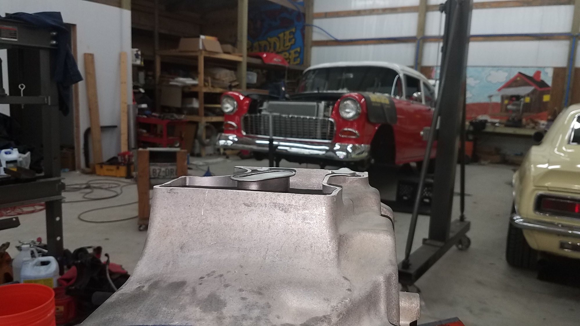

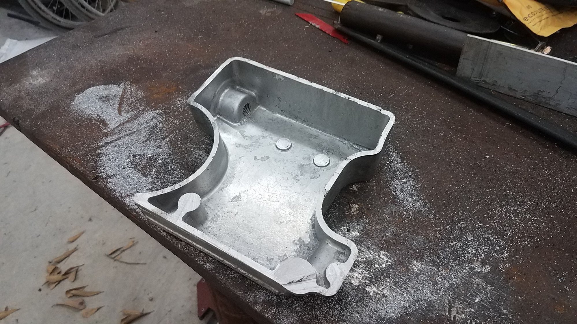

I made mine out of the GM muscle car pan, it hung too low in my 55. I just cut the sump off and made a batwing style with some scrap aluminum.

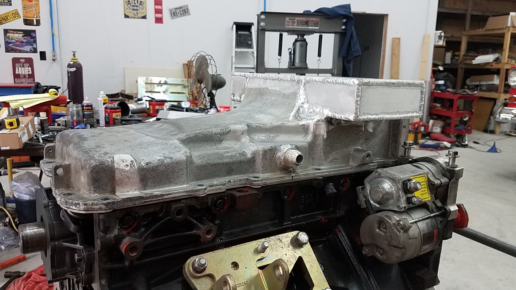

I was thinking about using steel because I'm not familiar with welding aluminum. I do see a lot of people welding aluminum successfully for the first time. I have an early F-body pan that will get cut and welded if the steel blank doesn't pan out ( no pun intended ).

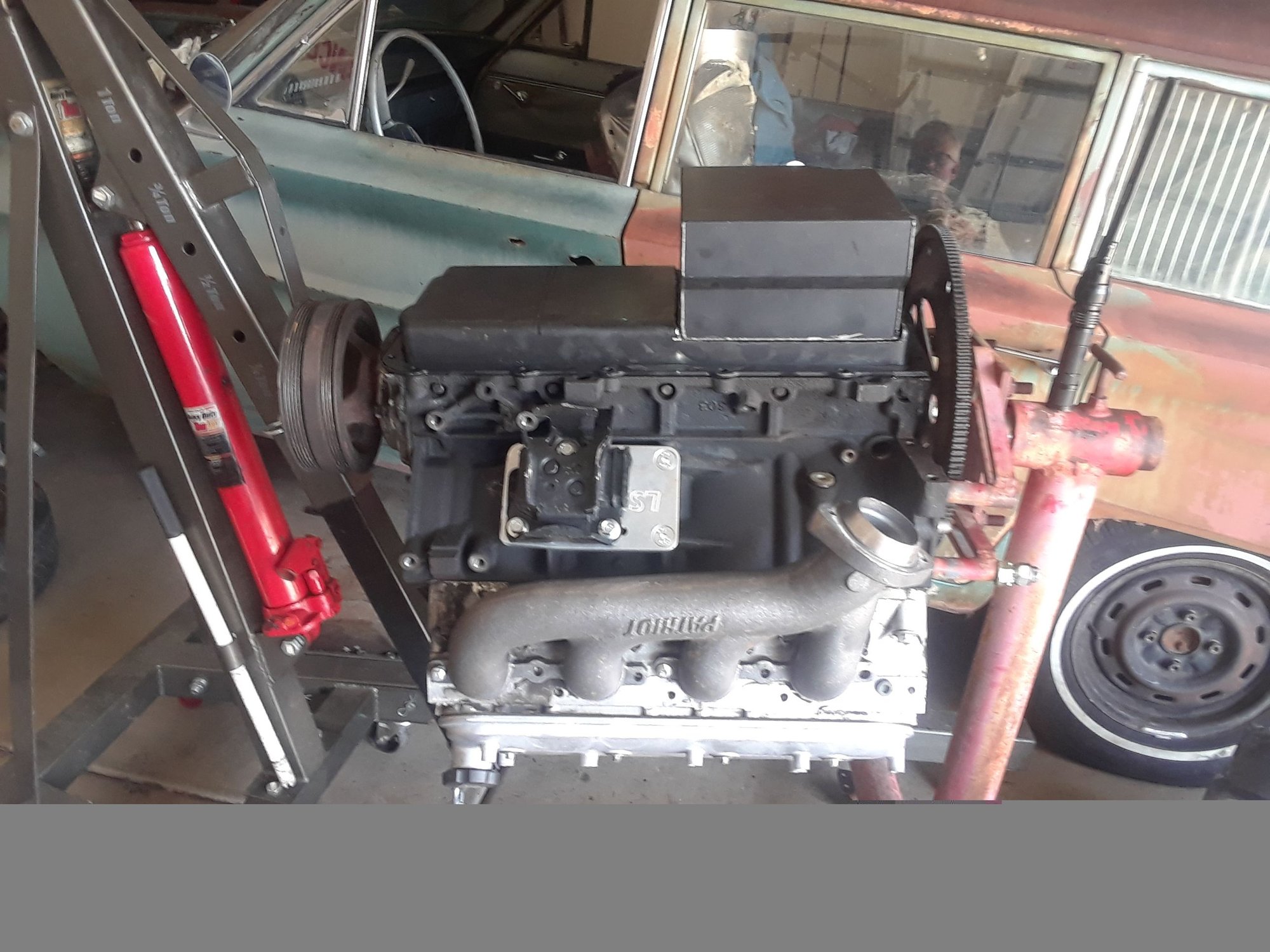

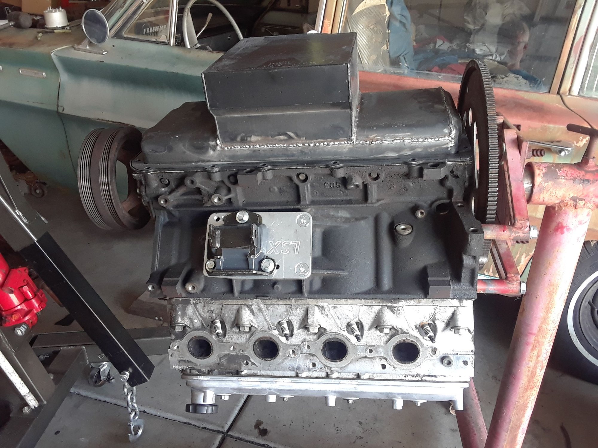

I modified a steel rear sump to a center sump for my buick special . Also had to modify the pick up tube.
