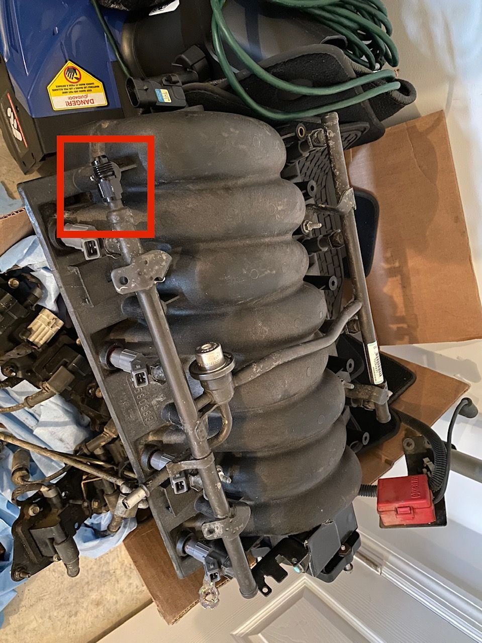

Thank you both for that info. That's the problem with reading old posts, you sometimes never get the full story or the correct story. I did just now find a video on the process of changing your 411 ECM to the 2002 Tahoe flex fuel version with HP. That is great to know as I really wanted to run it, but thought it required a Termi X. Unfortunately I do not have the HP device yet, so I cannot go looking at the Tune Repository. I have other things to buy first as this is a budget fun car. What happened on yours CDK? Did the fuel dry up with it being open? Do you all recommend a good budget regulator? I was going to buy a 6AN adapter for the fuel rail to convert that, but here is the odd thing. Someone took out the schrader valve on the rail (where people normally hook up a gauge) and put on a male 6AN fitting. Does this mean you can essentially run the 2 6AN lines as feeds from the regulator to those points? Is that a good or bad idea? I am afraid to take it off as no telling how its on there. I may buy a 6 AN cap if its not needed. If thats the case, then I will run 8AN as a feed to be safe and 10 gauge wire for the pump.

-The 6an on your rail where your schrader valve was is bizarre. I'm assuming they had their FPR mounted there and returned that way but with fuel coming in the same side I'm not sure how well that would work with the injectors on the opposite side. Could be worth a try maybe or just capping it would be fine as well. If I use a stock rail I usually put my fuel pressure sensor right there.
