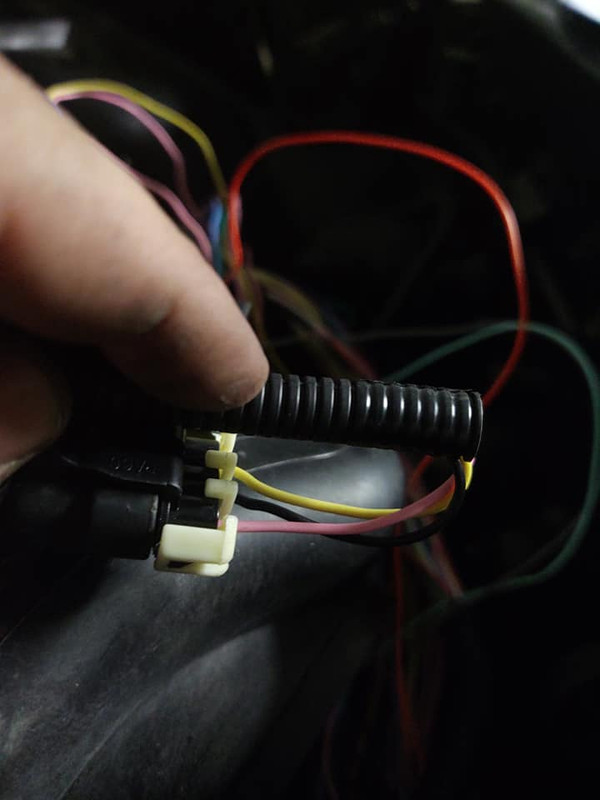

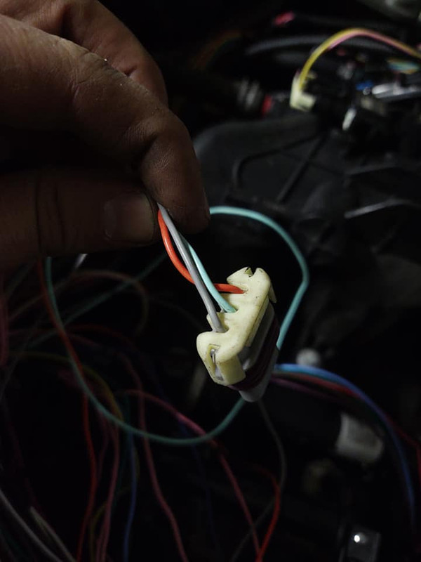

So i believe i got my Cam sensor, MAP sensor, and Crank sensor plugs mixed up. The swap harness didn't come with instructions stating which go where.
Can someone tell me which connector is which by the pigtails wire colors?
I didn't get a pic of the crank sensor plug i have but i have these 2, and out of these 2 i don't have anywhere to plug in one if i plug in one of them. Either one if not plugged in, doesn't have somewhere to plug in.
