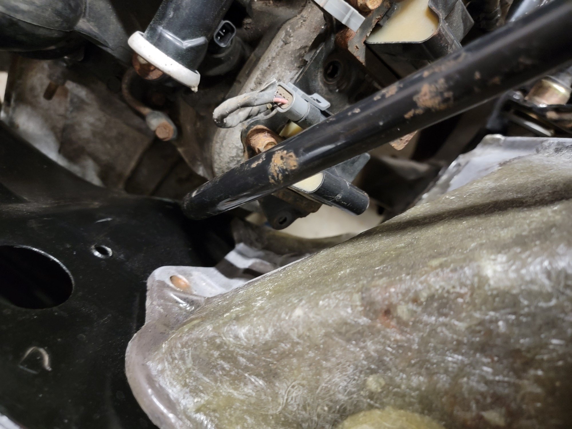

Engine drops in fine, without the truck oil pan on of course.... I was looking at other swaps and quite a few others are using the CTSv pan, but measuring on mine it looks like that pan would hang about 1in below the crossmember. So I went ahead with a 7qt pan kit from Speedway. That's on order now.
One thing to note, it appears the A/C air box will clear the valve covers and coil brackets, so that is great.

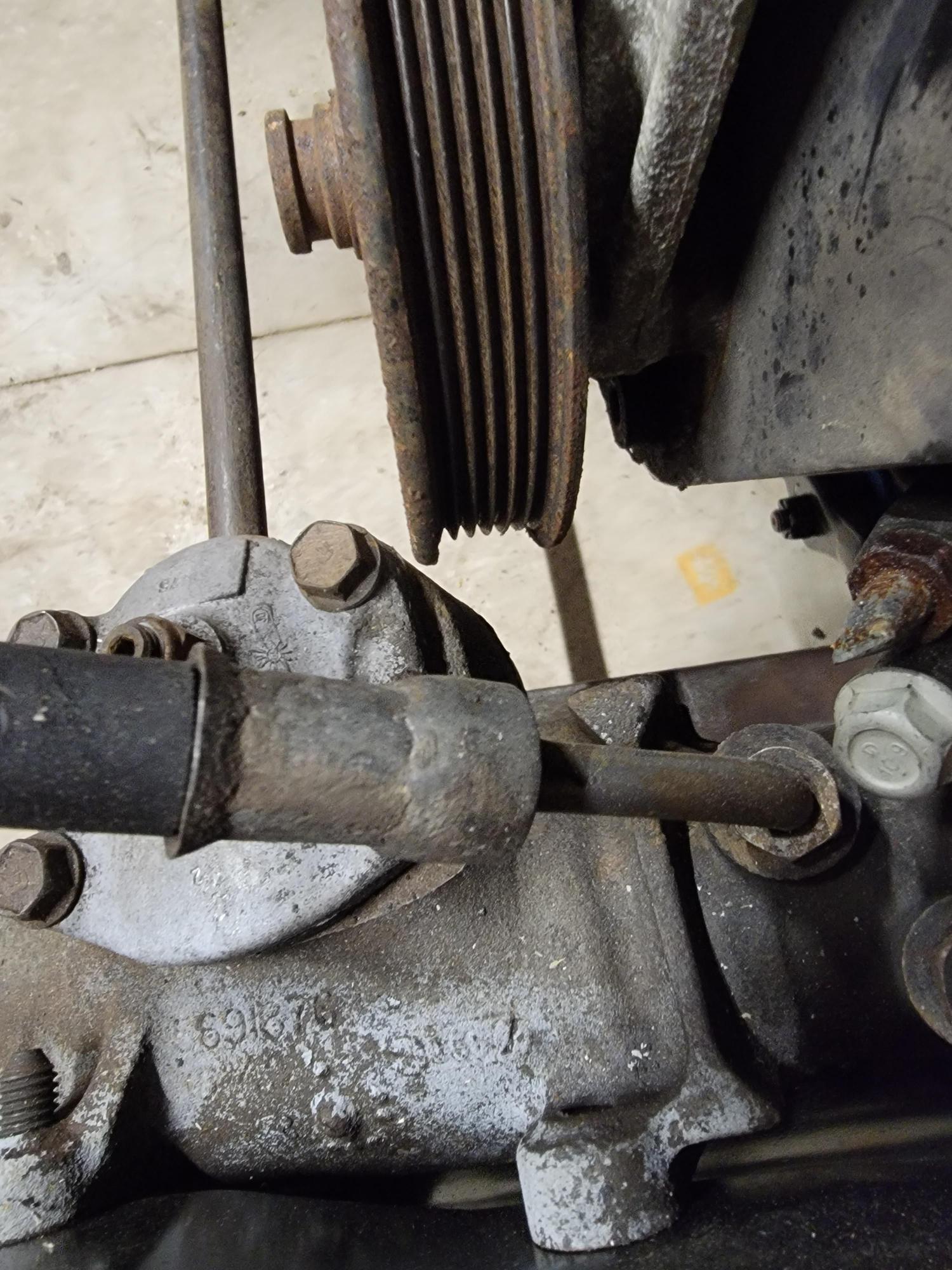

Minor issue, the power steering pump pulley has about 1/8" clearance to the power steering box. I'll have to see where that ends up with new mounts, may be massaging the steering box a little bit.

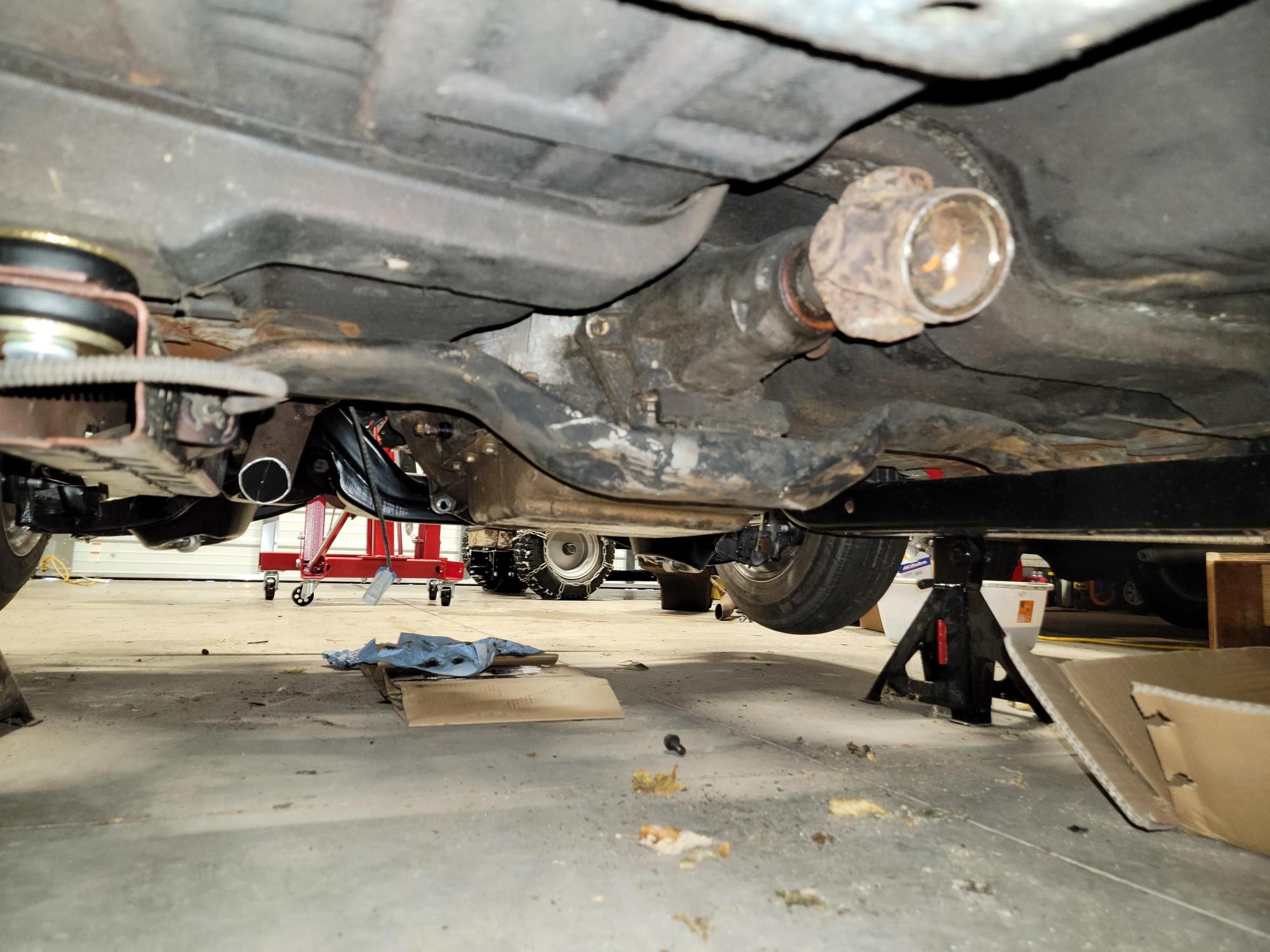

Trans mount looks nice, one hole on each side actually lines up too in the frame. So I'll just have to drill one new mount hole on either side and it should be golden.

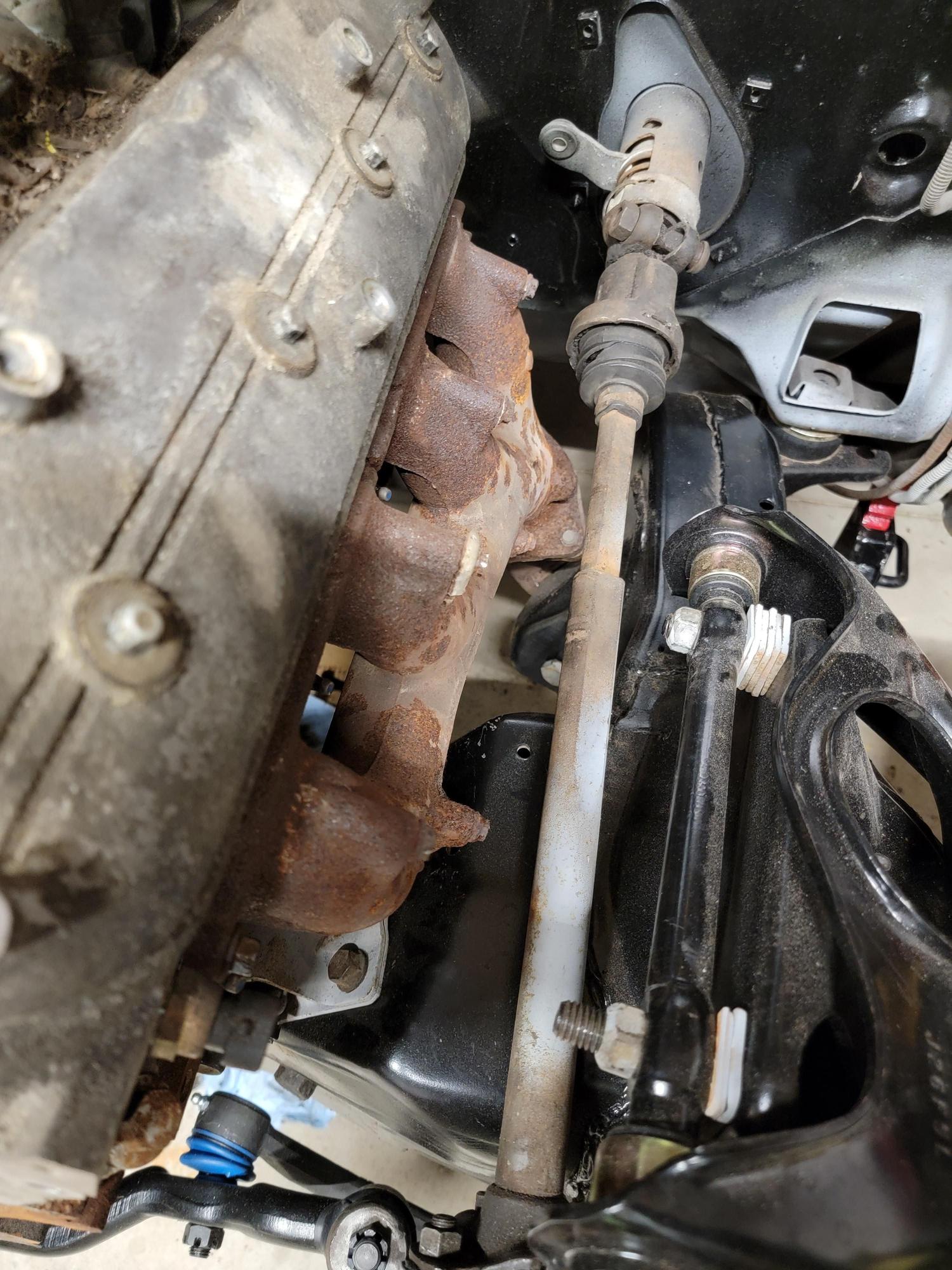

Something to note for a budget build, the truck manifold does fit on the drivers side, but not on the passenger. At least not the EGR one that I have, the bump-out for the EGR tube contacts the frame, maybe a larger truck non-EGR manifold would work. I'll be getting some F-Body headers most likely.

The power steering pulley can be swapped out for a slightly smaller diameter pulley and clear fine. As for the headers get the Speed Engineering LS swap headers for the fourth gen Nova, hey fit perfect. It does clear the factory AC box. I used ICT Billet brackets and a Sanden AC compressor on the passenger side. The tranny cross member worked fine with my 4L65. I used a F body oil pan but I think others like the Holley pan leave more wiggle room. I've had my 78 swap up and running two years if I can help any.

Thanks for the heads up! I found a few topics on here that were saying the Doorman 300-130 pump pulley would work. I'll try to find the diameter of that one and compare to the truck pulley, only need maybe 1/2in diameter smaller pulley. Did you have to run a power steering cooler with the pump driven faster?
